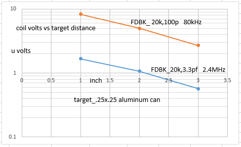

            Including an updated target time constant list. Need to finish some and could add a couple. A 6x6mm can has a time constant of 1.5usec, 10x10mm can 2.4usec. The can targets are larger than nuggets but they have a shorter time constant which might make them harder to see. I've read where the coil circuit should be 5 times faster than the target. What about the preamp? Does a slower preamp filter the response giving more signal at say a 10usec delay?
            Been wondering about the amplifier response. No replies so I recorded some data. Everything the same except for adding a 100p capacitor across the feedback resistor of the first stage of a two stage amplifier. The slower amp reading wasn't as stable. Don't know how the slower amplifier would effect doing GEB. The slower amp does increase the reading for short time constant targets. Might be worth more experimenting. Seven usec delay, 10usec target and EF sample. IB coil, difference amplifier. My error, not two stage. Transistor pair connected to the op amp. FDBK across op amp.

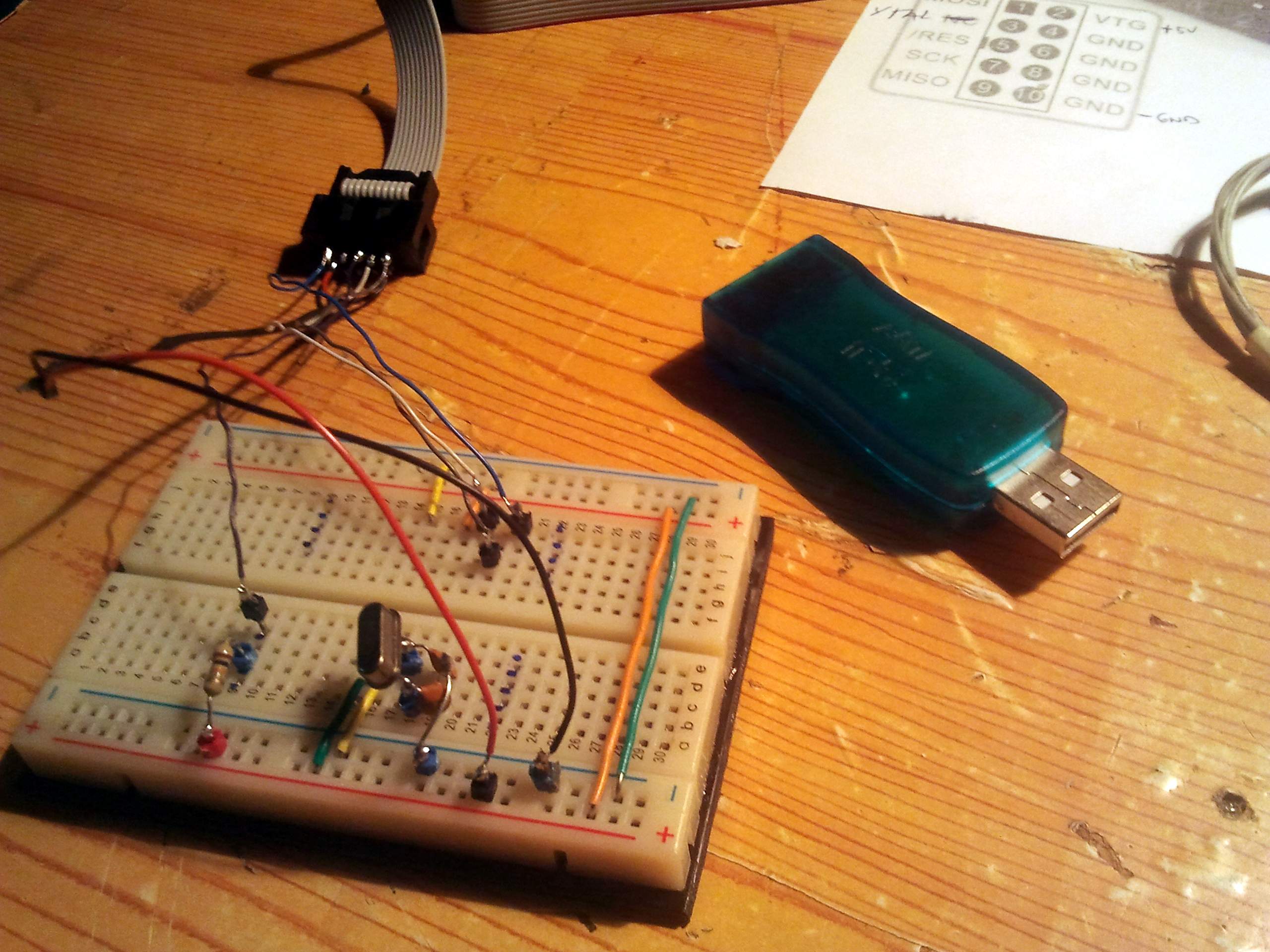

            • About version 3.30 and Arduino; will not work with Arduino as i already reported.
              Also as i assumed; it's about presence of bootloader in Atmega328p.
              (Haven't tried with optibootloader which occupies much less memory than standard bootloader, will try that just to clarify some other doubts too)
              Without bootloader at all no problem, it works just fine.
              I used USBasp programmer with barebone Atmega328p setup.
              In Avrdudess everything goes so smooth and nice.
              This works also with Extreme Burner and variety of other soft.

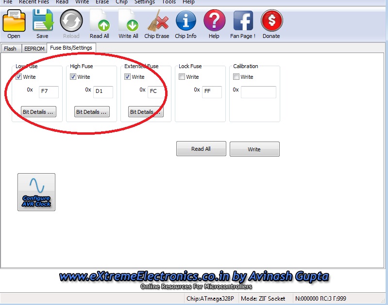

                    • atmega328p to write hex
                      usbasp,ZeptoProg II
                      they have
                      eXtreme burner fuse and crystal settings
                      how should it be.
                      thanks

                          • Originally posted by gurdal View Post
                            usbasp,ZeptoProg II
                            they have
                            how should it be.
                            thanks
