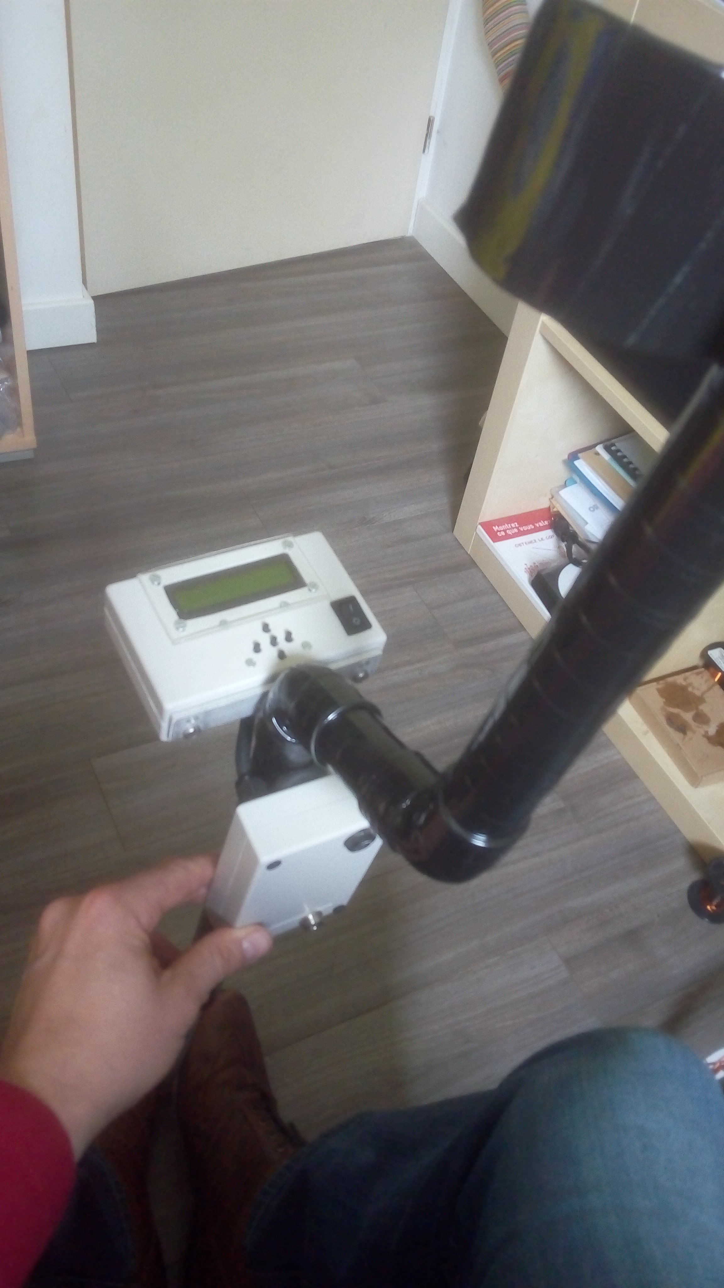

            • I bunt the last firmware in a new chip with the right fuses and extrem burner and i have the same issue.
              I'm tired of that caus i spent much time building a nice case.
              I'll try with LCD And less cable but that means i will destroy my nice asembly

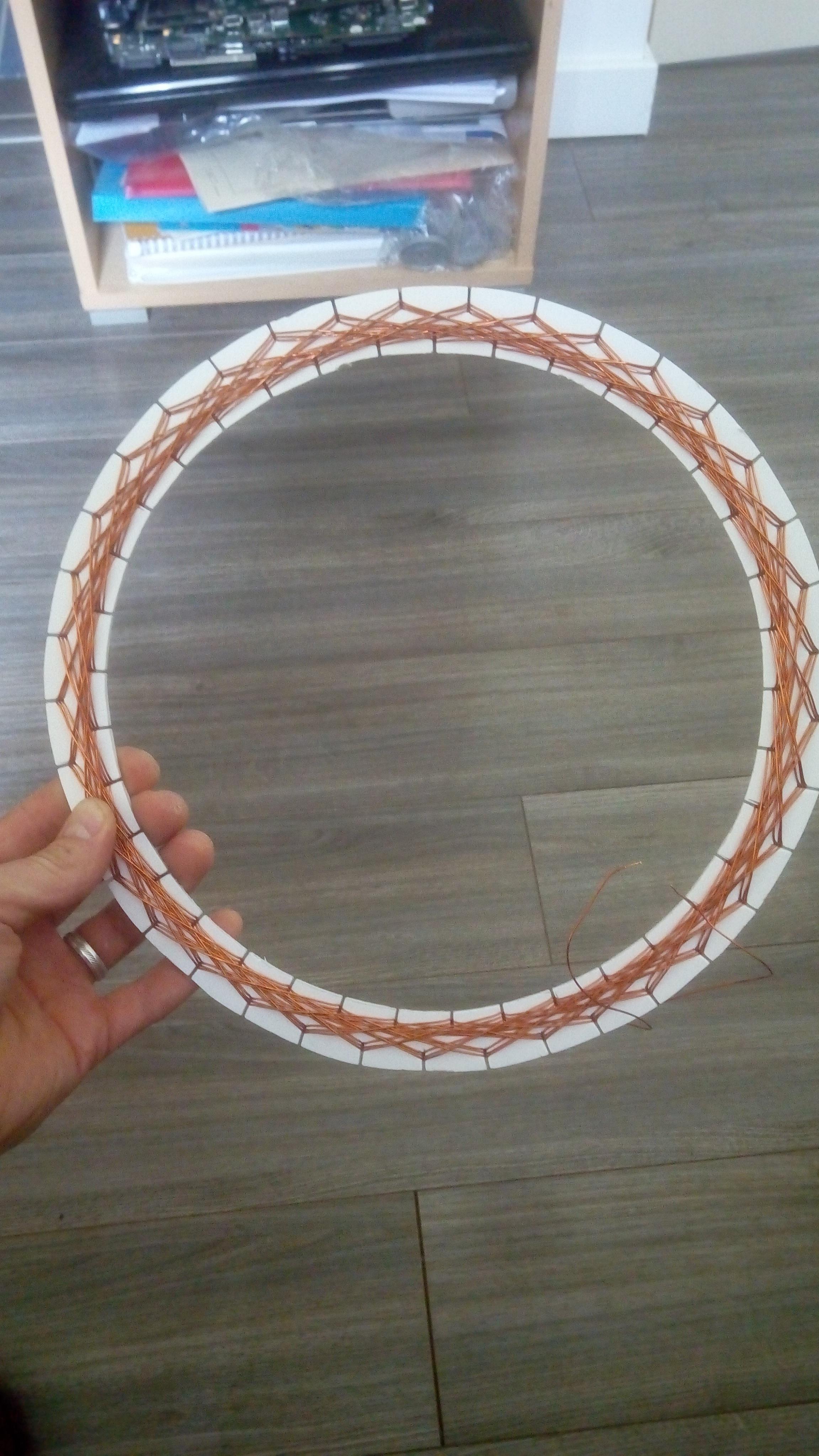

              Anyway, does the project works with a 486uH 1,5ohm coil ? Cause i'm building a nice one
