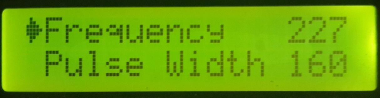

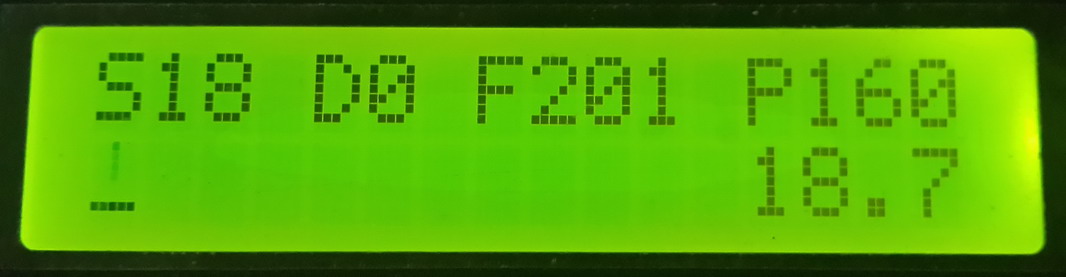

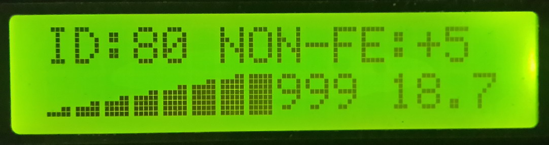

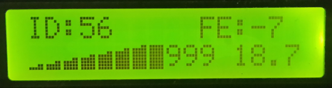

    Hello friends
    Here I put the new version of felezjoo-pi metal detector.
    In this version, more work has been done on the system.
    And more features have been added.
    For example, if you activate the iron-reject,and In this case, a piece of metal to be detected by the system,
    If ferrous metal is detected, the FE will be displayed.
    If the non-ferrous metal is detected, a NON-FE displayed.
    In the next posts I will further clarification on the system.
    Below you can see images from the screen.
    Good luck.

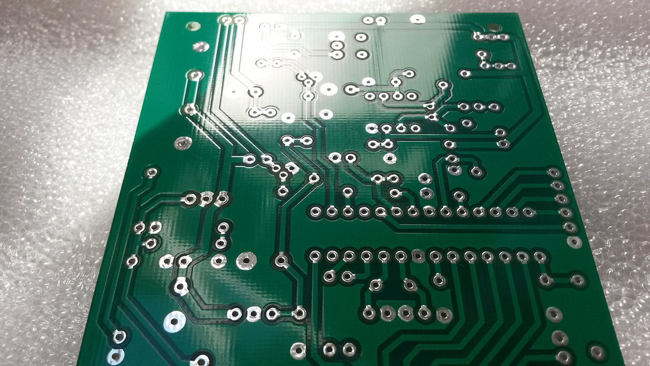

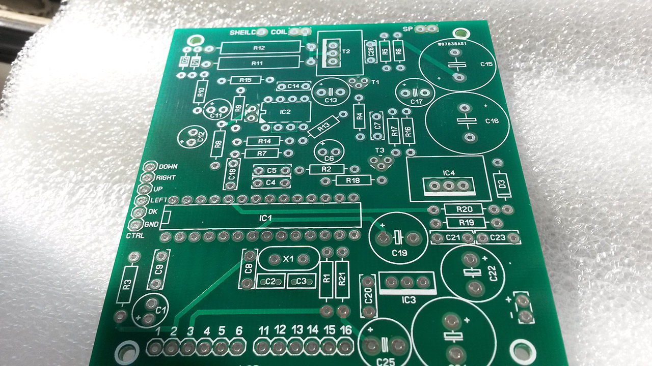

              • #82
                Here are some photos of the PCB, I received it just now. It's not exactly as the reference design (changed it a bit).
                Hope the rest of the parts come before the end of the month to try this thing out see if it works.
