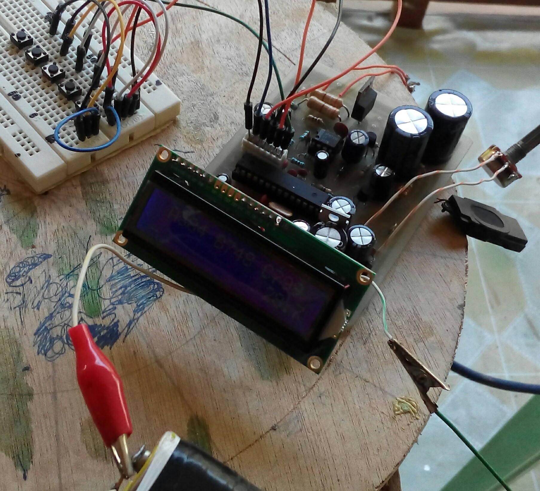

Just finish my new board..im impress with 4" detection on a 5x5mm soda can wall. Gonna upload video after finalizing...
[ATTACH]3600/ATTACH]
Here it is loud and clear. Next test would be in soil.https://m.youtube.com/watch?v=iXtQHuj24HM

8.5 inches, ordinary copper wire(silver plated stranded wire would surely add performance), 22awg, 360uH, 1.2R, double basket wave coil, damping 383R, sensitivity 20 (without annoying noise) freqyency 200, pulse width 130, delay auto, speed 7, integ w 26, ground 2,..im using different transistors, no 12v voltage regulator, no tantalum cap.. For another video sure i can if i have free time its the same result for sure..Originally posted by Qiaozhi View PostWhat are the exact details of your coil and detector setup?
