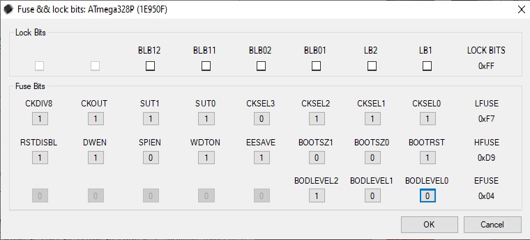

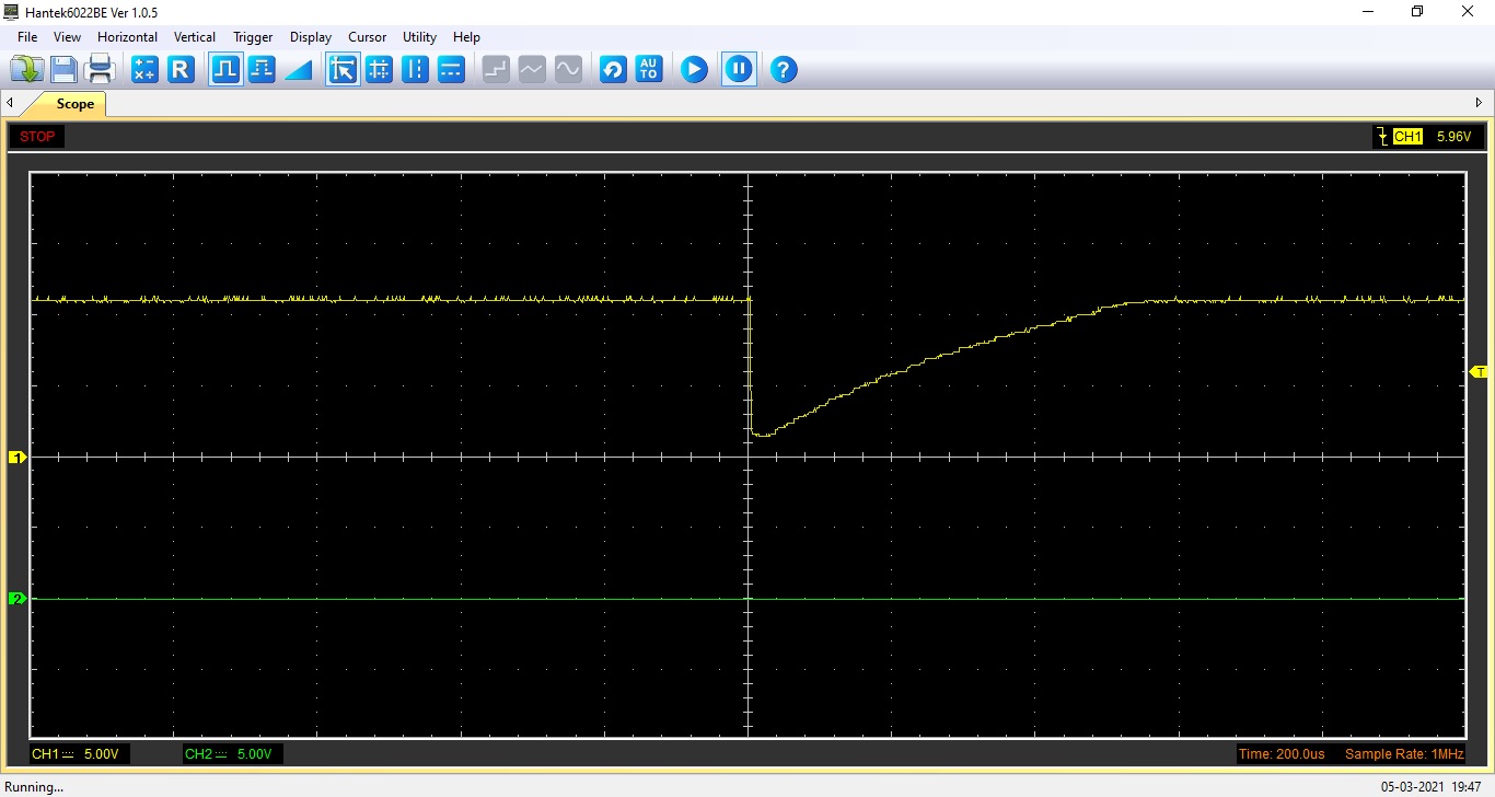

            • i used felezjoo full edit 3.35_1397-9-28-13-59.zip this is a new build im using a ne5534 op amp and a walkman board and for the fet im using irf740
              this is the results. is it a setting i have missed all the fuses are the exact fuses apart from LB i cant get that the same
              so what have i missed the coil im using is a nice 20us coil so why is the pulse so long ?

                      • Maybe due to opamp use Lf357h or lf257h metal version. I am not author but opamp may cause long pulse. And according to author , original board has also function to complete working.
                        [ATTACH]54619[/ATTACH]
                        [ATTACH]54620[/ATTACH]
