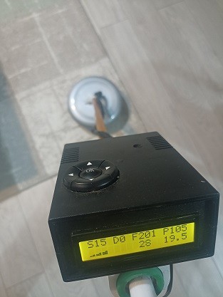

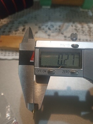

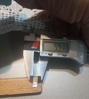

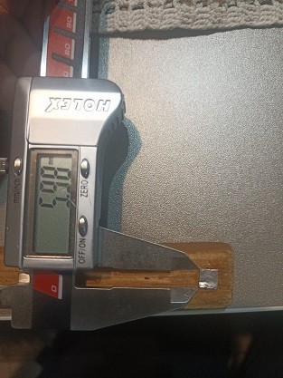

              • hello
                Today I finished a felezjoo detector with a very sensitive coil with a diameter of 23 cm
                the results are as follows :
                a square tile made from a soda 6mm can detects at 7cm in the air
                Small gold coin diameter 9.86mm and thickness 0.27mm about 0.20g start detects at 14cm
                I use the original software with the counter.
                It is very stable and calm on the field.
                I tried a lot of operational amplifiers, but the best result is with the original LF357.
                It is also solid with AD8055.​​

                  • Originally posted by zmaj od nocaja View Post
                    hello
                    Today I finished a felezjoo detector with a very sensitive probe with a diameter of 23 cm
                    Well done!
                    Thank you for your report!
                      hello
                      Coil details please?
                      • 0.17mh
                        1.3 ohm
                        2.012mhz SRF
                        Spider coil
                        • Diameter ?
                          coil type/spider coil?
                          wire size ?
                          number of rounds?
                          Auto delay?
                          • Spider coil 23 cm
                            42 turns
                            automatic delay 6
                            wire type: stranded wire with Teflon insulation AWG 22
                            Settings: frequency 201 hz
                            manual delayl 0
                            pulse width 105
                            ground 7
                            speed 10​​
                            I was able to search the field even with 19 degrees of sensitivity, although I think it has something to do with the software with the counter.
                            I plan soon to test the difference on the same device with the inserted software without counters.​​
