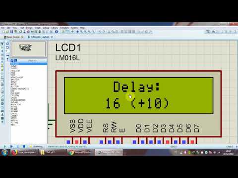

              Felezjoo edit
              • Some things work in proteus simulation some do not or I wronged it somewhere in the setup ?!I do not mean Felezjoo ! Ahcene2035 can you set scheme (fail) in Proteus for felezijoo ? I Want to try her at Proteus I'd like to try other versions of the code!Or send me to mail : [email protected]
