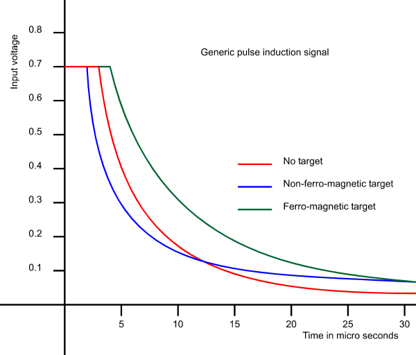

            • I have three questions for all my friends on the forum.
              1- On the decay curve, the values ​​for gold, copper, and even a rusty nail are very close to each other. How can we classify copper as an ferrous metal?
              2- Does the depth range decrease when we consider the discrimination mode (ferrous and non-ferrous)?
              3- Are there air and ground test results for the FelezJoo PI?
              I want to emphasize that all the information provided by my expert friends about detectors is very valuable. Thank you very much to everyone who contributed.​

                              In PI detectors, discrimination can be achieved by software-based measurement of the slow and fast decay values ​​of the "Decay Curve." However, as I mentioned before, differentiating between non-ferrous and ferrous metals is very difficult with PI detectors. This is because the decay curve characteristics of copper, gold, and rusty nails in the ground are very similar. In short, automatic ground balance and the response to gold in the ground are very important in PI detectors. Since gold does not have oxide properties, the detection distance is crucial. Metal discrimination is not that important; minimizing the response to minerals with automatic ground balance is sufficient for PI detectors. Thank you very much.
                              • PI Decay Curve
