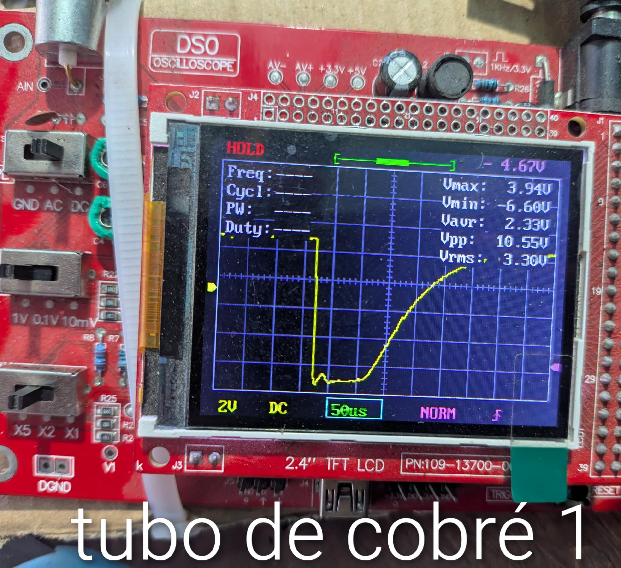

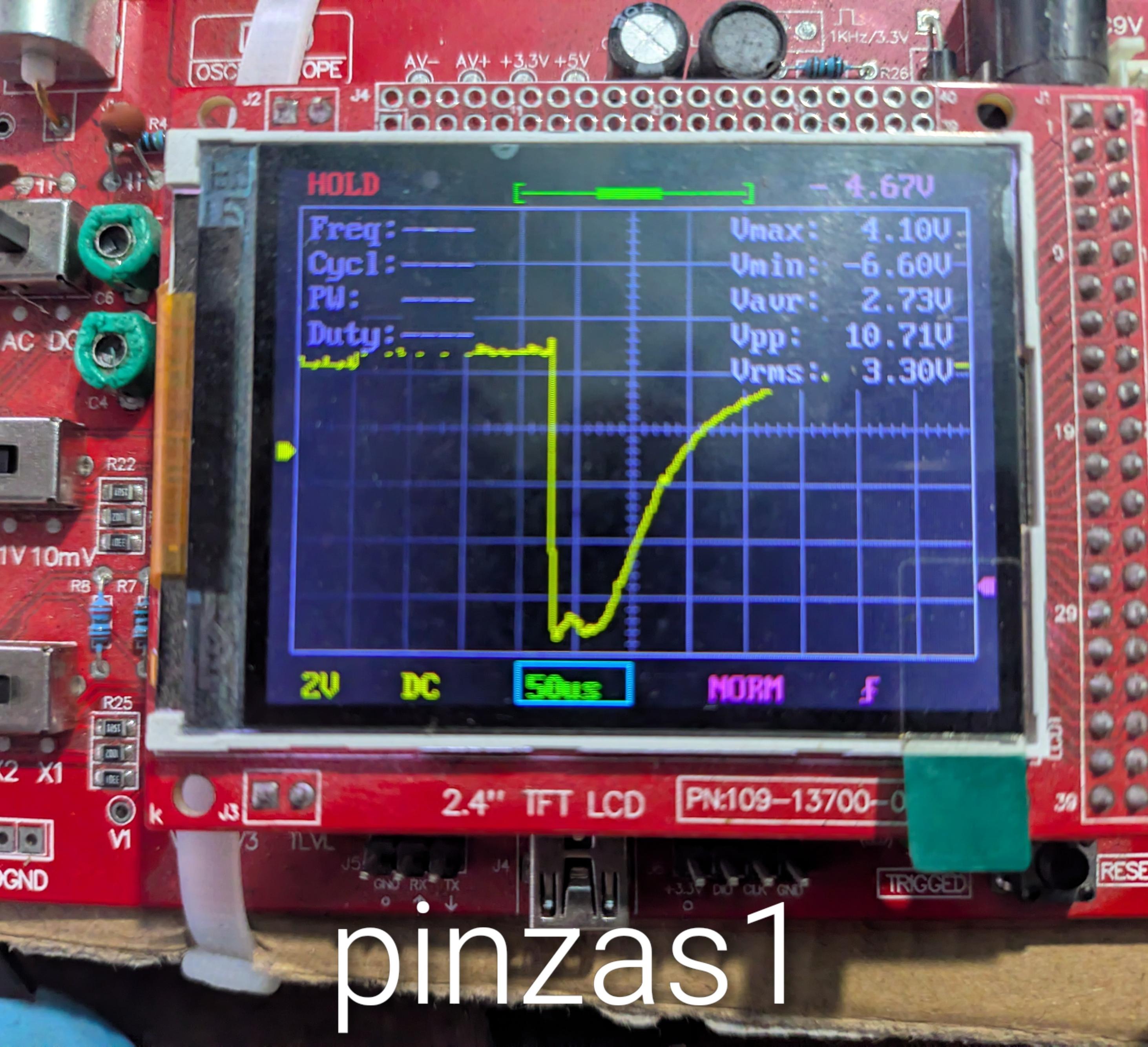

  • I obtained this sample from Felezjoo to use in creating a first version that can remove contaminants by conductivity. It's not precise, but it helps because it removes everything except copper and silver. This first version is currently being tested, but as I said, it's true conductivity discrimination.
    It's fully functional, and the GT makes it very precise. Because it's conductivity discrimination, the type of soil doesn't matter since it measures the conductivity of the target, whether it's large or small.

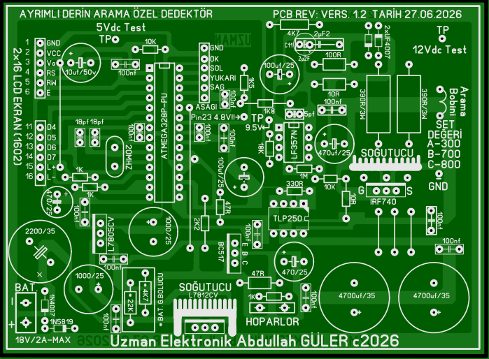

          • Felezjoo TLP250 PCB.

                  • Hi sabios,
                    With so simple schematic and not very power processor, your efforts to improve the possibilities of this solution will be endless. Just understand this is entry level MD with microprocessor's control. It is my simple opinion.
