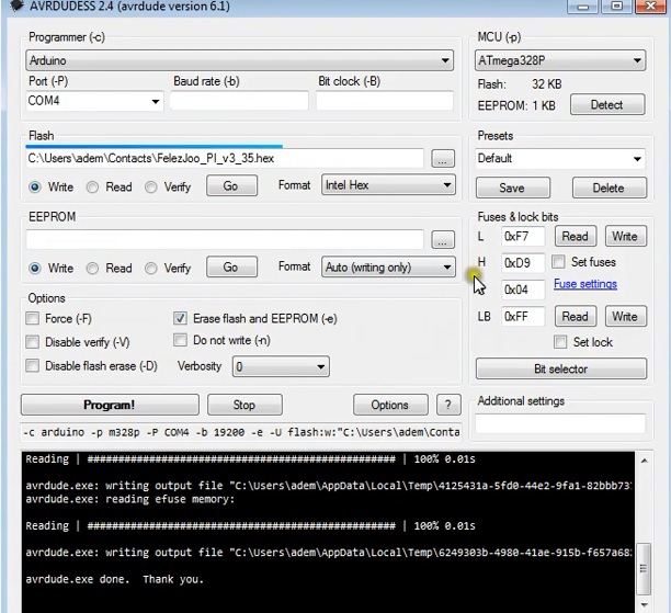

ID:	363358 I have made 10 detectors for friends...I have used an arduino, attached the image...I don't know if these fuses are correct, but to date they all work perfectly and are very stable...I use plastic connectors, a shielded box inside with graphite connected to ground... in the power supply of lf357n I remove 10 ohm resistance and put in its place 100uh inductor coil

                  • Originally posted by ricalbertvig View Post
                    [ATTACH]57832[/ATTACH] I have made 10 detectors for friends...I have used an arduino, attached the image...I don't know if these fuses are correct, but to date they all work perfectly and are very stable...I use plastic connectors, a shielded box inside with graphite connected to ground... in the power supply of lf357n I remove 10 ohm resistance and put in its place 100uh inductor coil
                    D1
                    When reprogramming the counter does not return to 300
                    • I don't understand? I am using the full version and everything is fine, can I have problems after a while with those fuses?
                      • The difference between D1 and D9. If EESAVE (EEPROM memory is preserved through chip erase) is marked then it is D1 if not then it is D9.
                        Link1
                        Link2

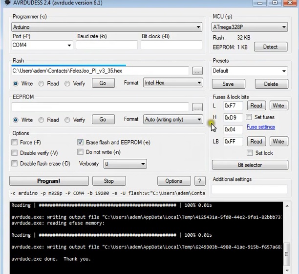

ID:	363361 is that I use arduino and avrdude to program the atmega328
                          • In the version which contains a counter, it is necessary to put d9. Because after the end of the counter and a new reprogramming, the counter does not return since the beginning. As for the full version, there is no difference between the two
