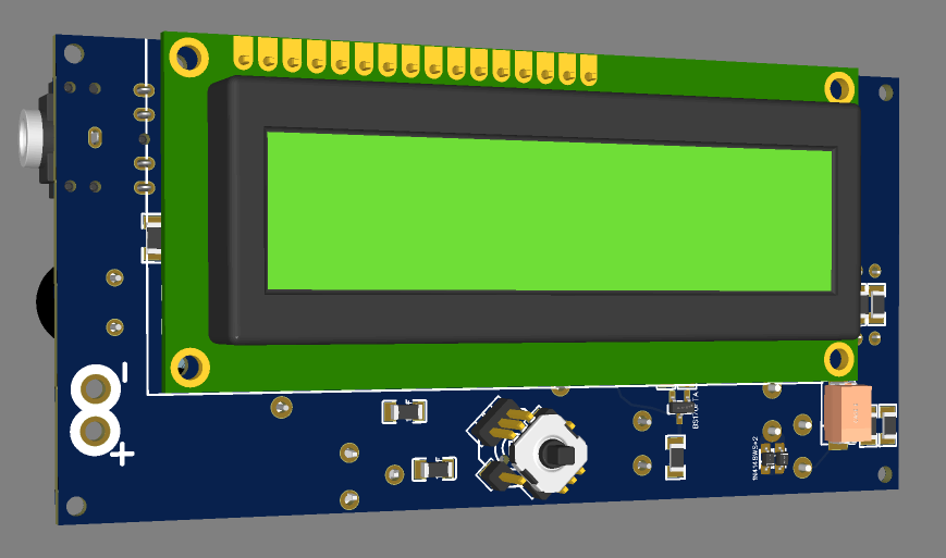

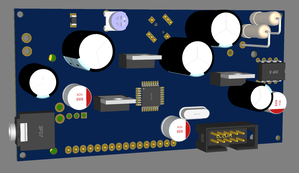

            • DeePI SMD 1.2 (Felezjoo PI variant) under construction
              • Looking good.
