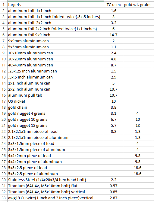

  • Including an updated target time constant list. Need to finish some and could add a couple. A 6x6mm can has a time constant of 1.5usec, 10x10mm can 2.4usec. The can targets are larger than nuggets but they have a shorter time constant which might make them harder to see. I've read where the coil circuit should be 5 times faster than the target. What about the preamp? Does a slower preamp filter the response giving more signal at say a 10usec delay?

            A 10mm square of aluminium can is a much larger target than sub-gram gold.

            Yes it is very true; 6mm square cut from soda can and 10mm square cut from soda can are MUCH different targets! I wasn't aware of that until today.

                      The claim with this design appears to be that a single-stage preamp with a gain of around 2000 (using the LF357 opamp) is as fast as a dual-stage preamp using an NE5532, and an overall gain of 1000. Undoubtedly the LF357 is a faster opamp, and this could be useful for other designs, but I'm struggling to see how the Felezjoo could possibly detect sub-gram nuggets. Even reducing the TX pulse width to say 50us, and using a fast coil with the correct damping resistor, there's no way I can see that it will be able to sample early enough to detect something with a time constant of about 2us. However, this is likewise a somewhat academic point for me, as like you I have no sub-gram (or even larger than a gram) sized nuggets anywhere in the vicinity of my home.

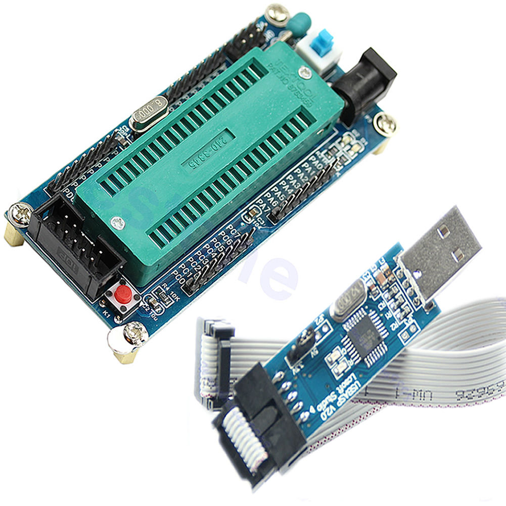

                            • Hello mates,can i use this programmer to program AtMega 328P??
                              Thx and Regards.
                              • Originally posted by seadoggy View Post
                                [ATTACH]35915[/ATTACH]
                                Thx and Regards.
                                Absolutely!
                                All the infos are here:
                                USB, Programmer, AVR, ATMEL, controller, microcontroller, program, avrdude
