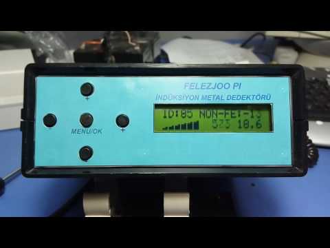

          • I finished building the coil for felezjoo that works fine, but have some issues I figured out today.
            1. I cant change volume, that means setting can be changed and the start sound also changes, but the sound while detecting is the same volume all the time
            2. It gives me some double-beep all the time after detecting and after waiting some time
            3. the numbers beneth signal strength are continuously running all the time
            Any ideas?
            • Originally posted by Spyke View Post
              Any ideas?
              1. In Menu you have option to set the volume at desired level, it should work, works at me.
              2. Yes it gives me too the double-beep from time to time. I guess it is some sort of checking something, will ask author.
              3. If i understand you correctly about the numbers; those are very useful and can serve you to monitor proper Ground Balance state.
              It is very interesting and informative to monitor those numbers when stroking "Down" knob and when it balances. Keep coil calm at the same distance from the soil while doing that.
              After it is balanced than rise or lower coil from/to soil surface and monitor those numbers. They must change and be pretty sensitive relating to coil distance from soil.
              That's a very useful information during the searching. You could always tell whether GB is alright or not.
                Thanks for clarify point 2 and 3. If you receive further information about point 2 please reply.
                About point 1: I can set volume in settings, but it only effects to startup sound, but not to detection sound. Detection sound is always on same level.
                I can make video if it help to understand the problem.
                • By the way, I use your pcb design.
                    No need to make video, i understand.
                    Ah that's pretty much the same as on XP Deus, the other day a guy came to me complaining on exactly the same "problem" with his Deus.
                    All the time i was thinking that you can actually lower the volume at Deus, all those 5 years i am having it.
                    And just the other day i realized; you can't! Ahahahahahaha!
                    Simply because i am pretty much deaf person (lot of noise, loud music and loud sounds and various machines roaring is my everyday reality) and usually i rise the volume to maximum at all my toys i am playing with.
                    That's why i never really realized that. Ain't that crazy!
                    So i guess author of FelezJoo PI followed the same logic when wrote the code, pretty similar as at XP Deus detector.
                    And at XP Deus it is as this; you actually can't lower the volume as at any ordinary radio, tv, player etc. You can only "shape up" the audio "banging" when detection occurs.
                    Larger the number at "volume" preset; louder and clearer is the "banging" of sound when detection occurs.
                    Another thing i realized the other day at Deus... there is only one Language available at exact remote!!!
                    And all the time i was pretty much convinced that you can change at least between 3-4 languages!!!
                    (poor guy purchased by mistake Deus remote with French language, all the time hoping it will be on English)
                    • Ahhh, so everything is fine with my device?
                      I think I add a potentiometer, otherwise I'm also deaf after using headphones with felezjoo.....
                      Another question, can isp-plug been added to existing pcb without changing anything on it? Im afraid of damaging comonents by trail and error.
                      I plan to do this with wires to reprogramm device without opening it.
