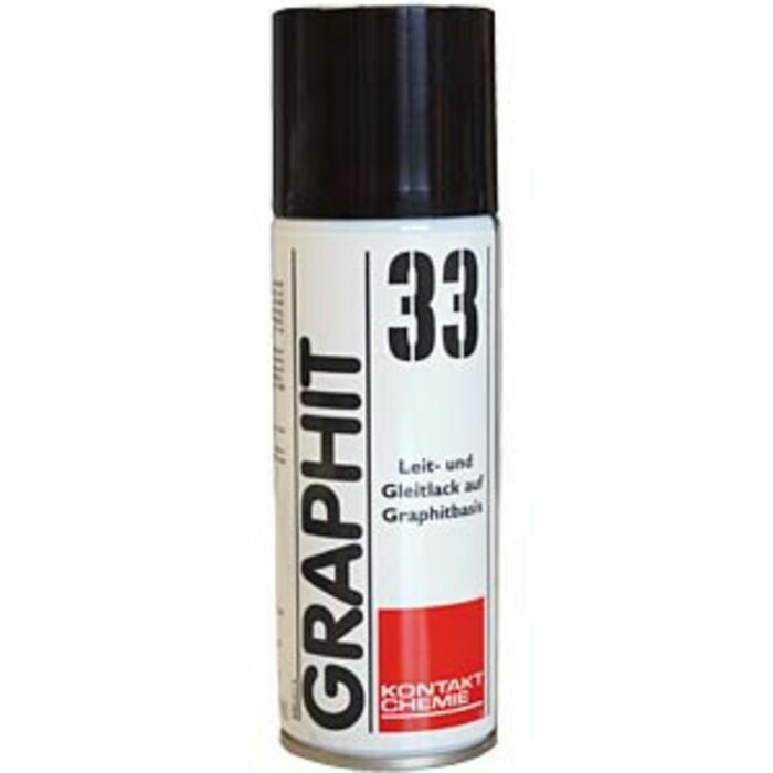

                              • I think i need to shield it, i have cursed soil here , i dont know if this normal to have voltage on the soil.
                                Do i need graphite conductive spray or just foil...
                                I think this would be work
