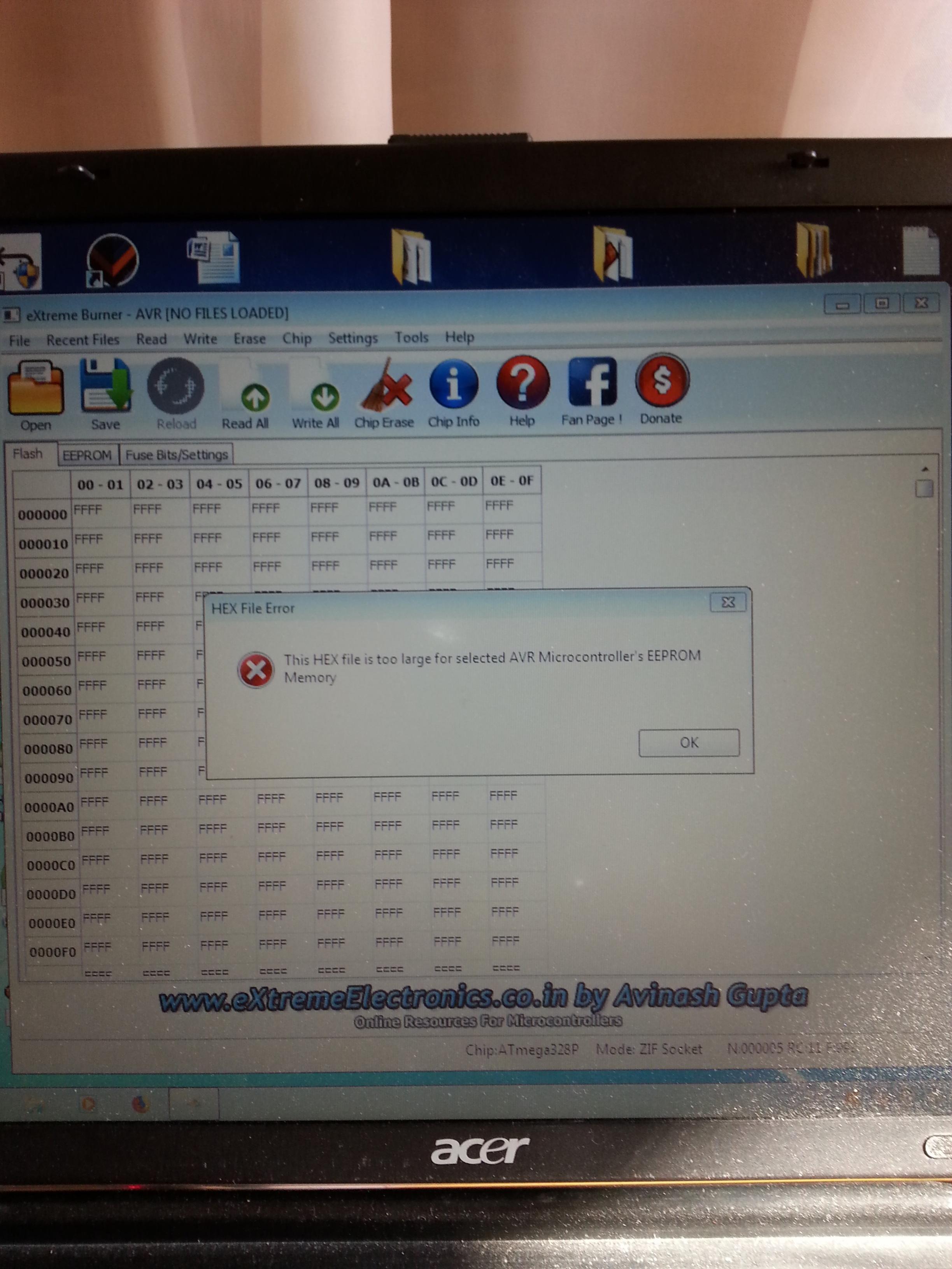

    why i have this error ?
    • As the error message says the file is larger than mcu's eeprom..Did you try to "chip erase" ?? When my felezjoo counter locked i erased device reprogrammed the chip (on board i soldered miso-mosi-clock-reset and supply pins) and it went down smoothly,didnt have to use the "eeprom_clear" hex file posted above..Im not familiar with the software you re using..
      • thanks. yes i use the eeprom_clear" hex file posted above
