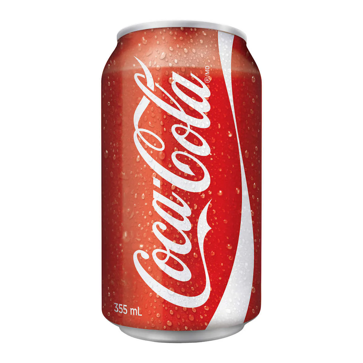

            • use coca cola can, it is available for everyone in the world
              • That was the idea, but when I went to look for it, they only had the large ones, and the only beer cans were small, so I used the beer can.

                • Very good range, it is this size as this coca cola , not crashed can , 355mL?

                    • I always use cans, like the 355ml Coca-Cola can, as it's the closest. In fact, a colleague who has tested several detectors always recommends using this type of can, and the beer can is the same size as the Coca-Cola can.
                      That's why I use these, except for the coin tests, since those only require larger objects, and the large coils aren't suitable for that.​
