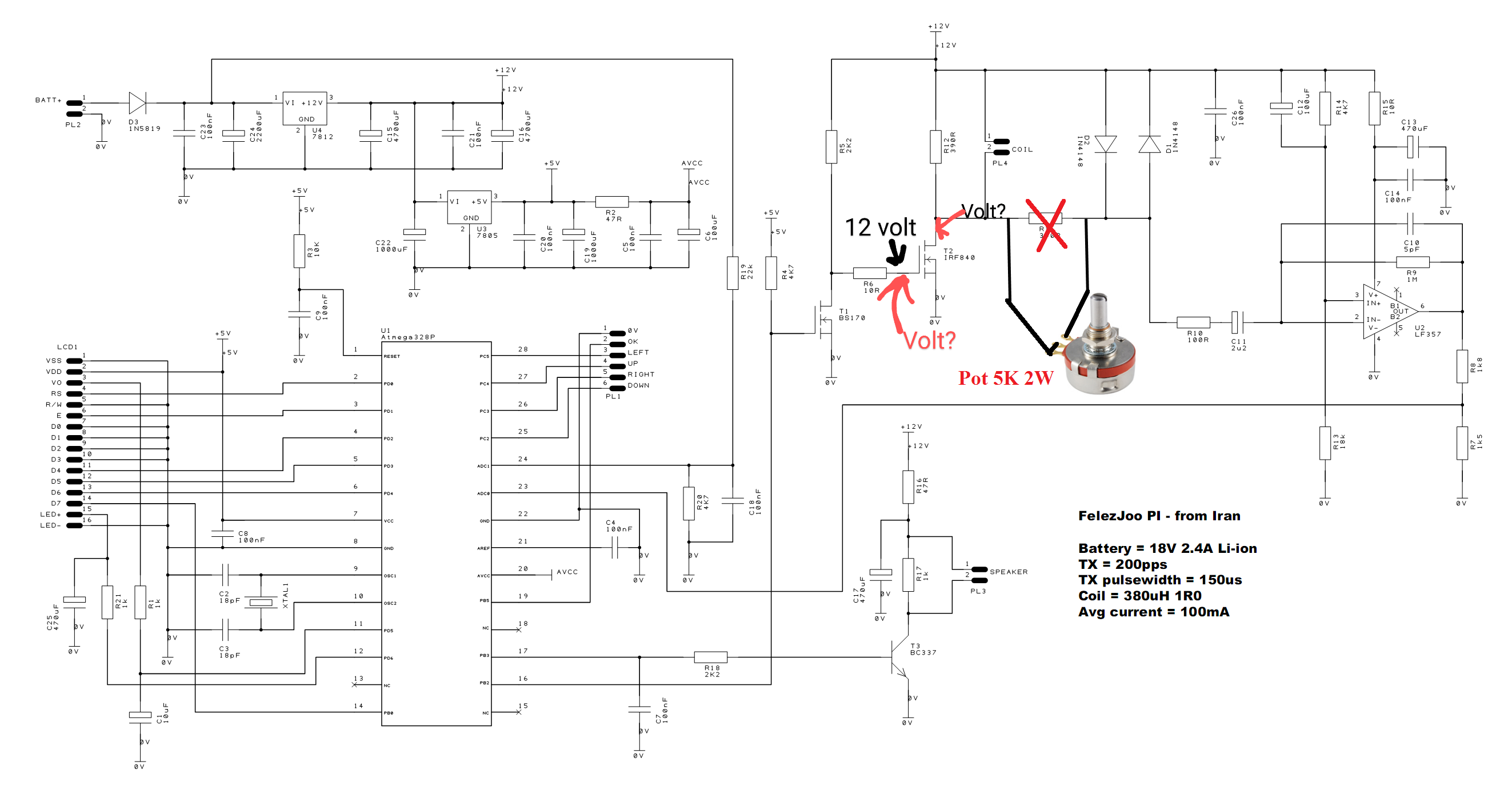

                • My question is according to the issue what is the damping resistance that describes that of 470R.
                  https://www.geotech1.com/forums/show...506#post224506
                  • a question what would be the voltage of the bs170 in its legs and what would be that of the rf840
                    • what would be the operating voltage of this, because it gives me 0volt in R6
                      • R6 will have a pulsed waveform between 0V and 12V, if that is the question. You will need an oscope to see it. The BS170 has a 5V pulse on the gate and a 12V pulse on the drain.
                        Also, I would recommend putting the 5k pot in series with R11. Otherwise, if you set the pot to 0 you will probably blow the diodes and then blow the opamp.
                        • check and at the output of the bs170 in drain there is only 6 to 7 volts for the same reason in R6 there is only 7 volts and not the 12v at the input of the gate to the irf840. any replacement for the bs170
                          • 1. Is the 12V supply working?
                            2. Is there a 5V/0V pulsed waveform at the gate of T1?
                            • I corrected check and at the output of the bs170 in drain there is only 0.66 volt and I already checked the resistance R5 and 12 volts enter, and in gate I have 5 volts by the way change the bs170 for another check it with the LSR tester to make sure it was good.
                              so what would be a good replacement for the BS170.
                              • It sounds like you do not have a pulse signal on the gate of T1. Changing T1 will not fix this.
