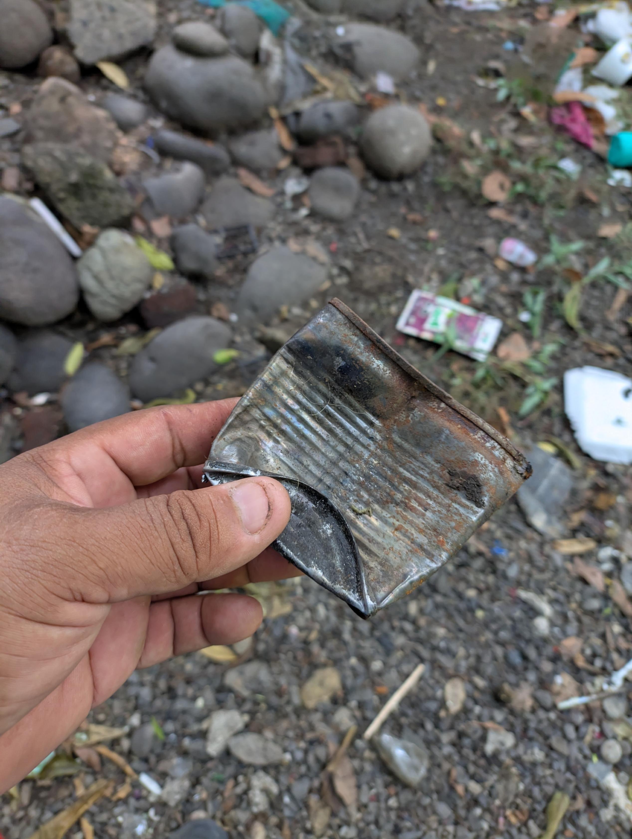

                • Has anyone noticed that the Felezjoo is fast at detection but therefore more unstable? With a small change, it becomes slower but more stable. I'm using a 45cm coil for testing. I recently buried a can of chili peppers 40cm deep and it detected it.
                  And of course, this is the version I modified.​
                  • This is a video I made; I should clarify that I'm not a professional at this. In the video, I clearly showed that the can is 70cm high. What do you think? As I said, it's very stable, although in this version, as you can see, it's a bit slower, but that makes it more stable than it was before.

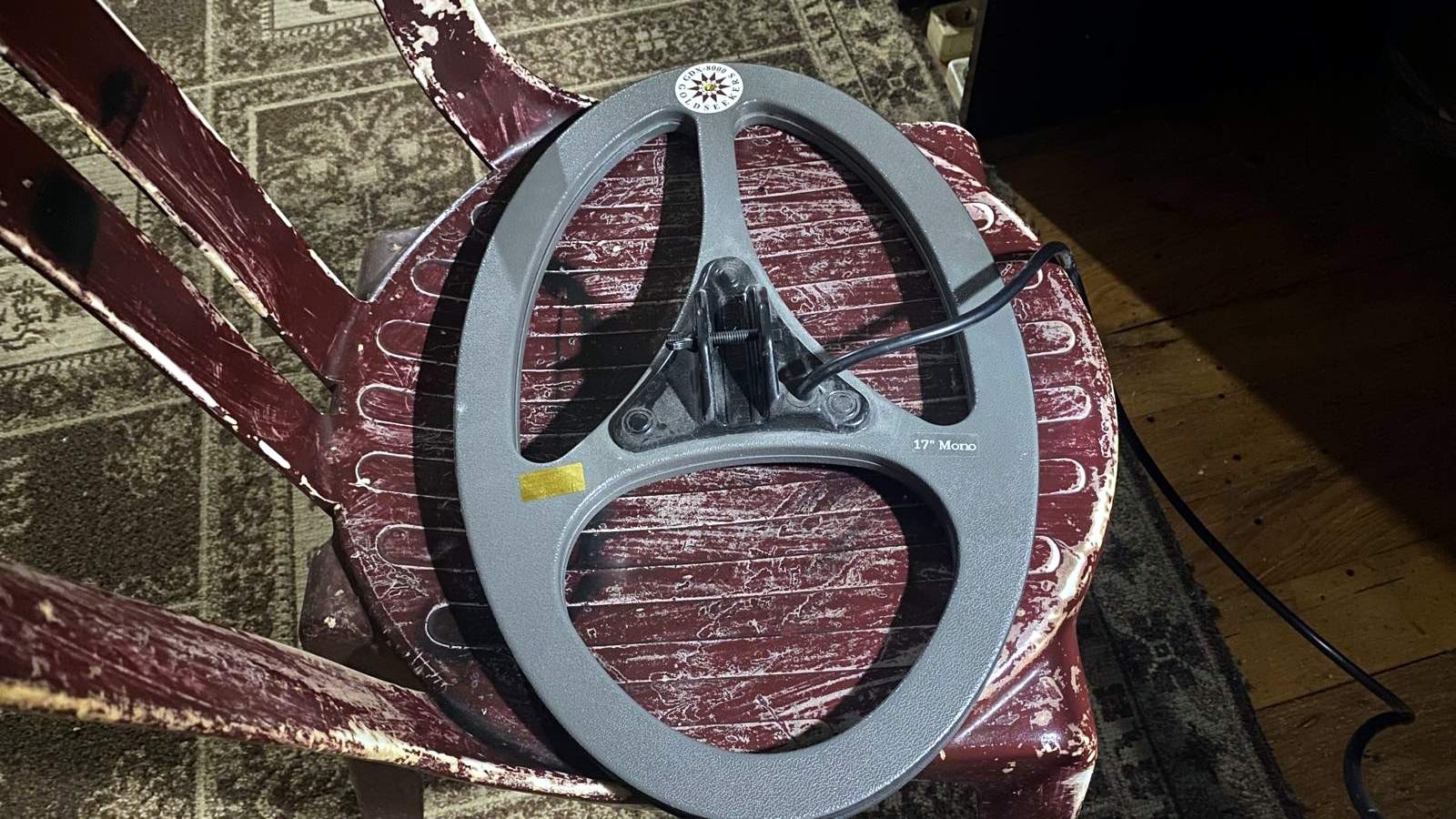

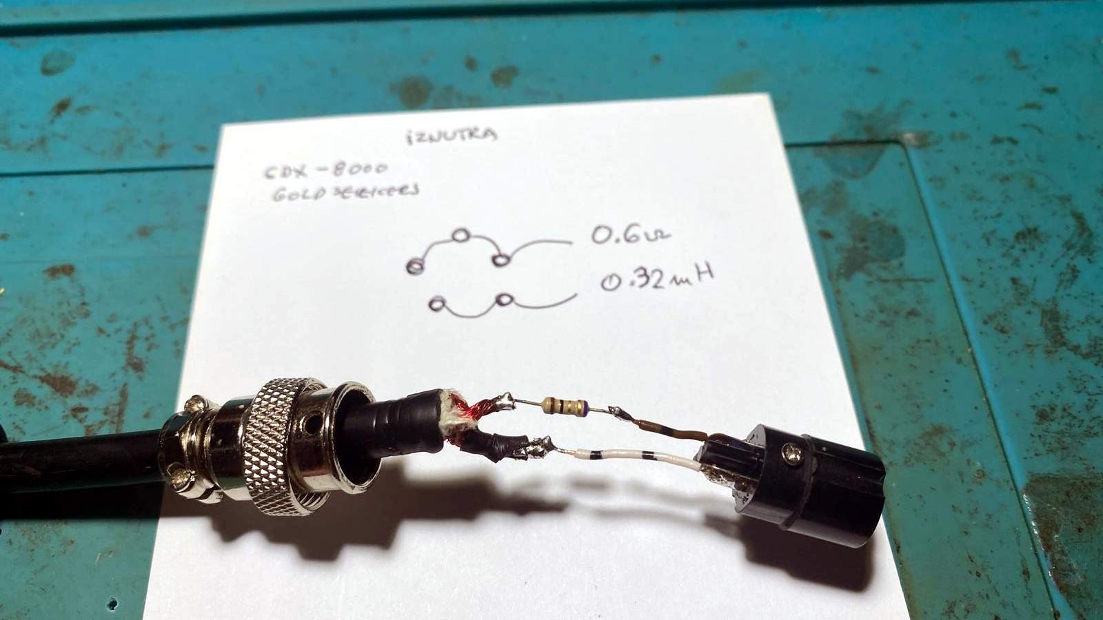

                          • A colleague left me a Chinese copy coil for ML GP&GPX for a few days.
                            So I tested and measured.
                            I had to add a 1 ohm series resistor and connected that to the FelezJoo PI.
                            The coil immediately worked solidly, without the occasional "Coil error" problem, which is otherwise common.
                            But I won't know how well it works until I get the original LF357.
                            For now, there is still LF356 in the detector, which is not adequate.
                            BTW coil is 43x28cm.

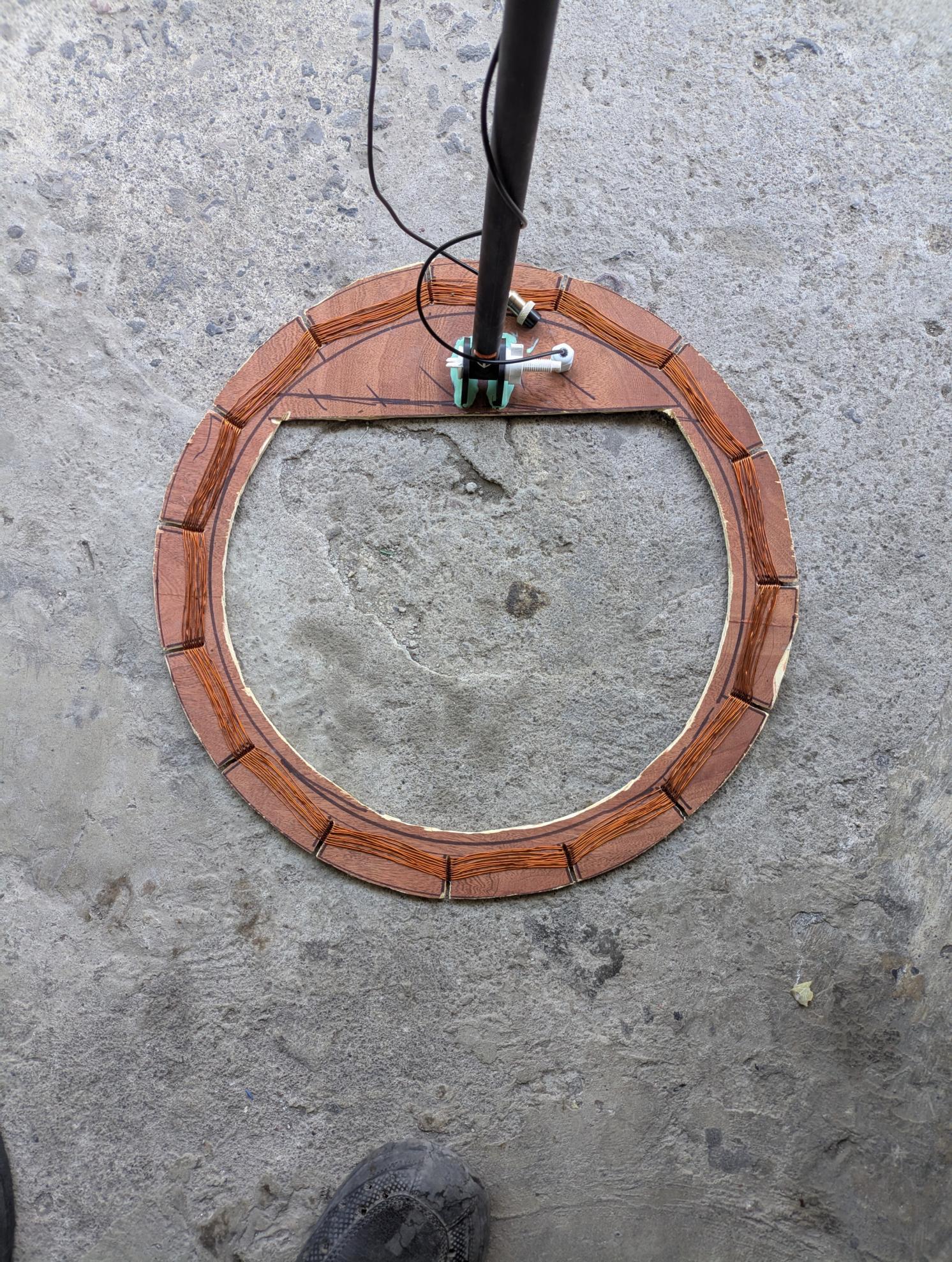

                            • I've used coils up to 230uH and it's worked for me, although that one is a bit unstable. But with 330 to 450uH there are no problems.
                              At least on my end, I haven't had any problems and I've seen that it works well. In fact, I've recently been looking at the Iron Reged section, which is the discrimination feature, and I've noticed that it removes ferrous materials easily, although it's a bit tricky to use precisely.
                              Actually, I currently have three different coils: a 45cm spider-type coil, a 50cm square coil, and a 1x1m square coil, and all of them have worked well, except for the 57uH one, which was the prototype.
                              • This is a new video I recorded in an open field, and as always, I'm using a 355ml aluminum can, this time at 67cm.
                                And I'm using a 50cm square spool with its sled so the spool doesn't move and cause any errors.
