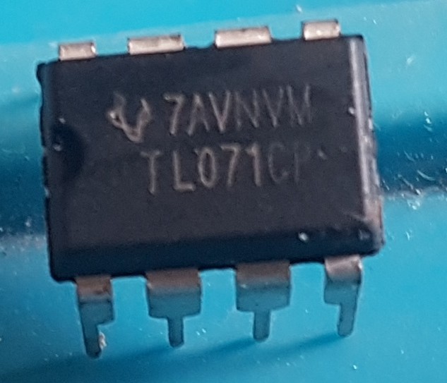

                              • I posted this picture somewhere on the forum before, I keep it as a reminder for a few hours of annoyance and stress; until I discovered that it was a fake TL071 (whole batch of 50pcs!).
                                The reason I didn't find out right away was because I found it hard to believe that there was even one moron in this world who would fake the TL071; the cheapest opamp in the world!
                                The trick of the mind is such that I always first doubt my own mistakes in my work, in the style: "What did I do wrong?".
                                Last on the list of possibilities is that there is a moron out there who is going to fake the TL071!
                                But there... still there are such idiots!
