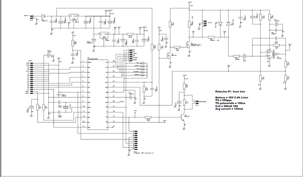

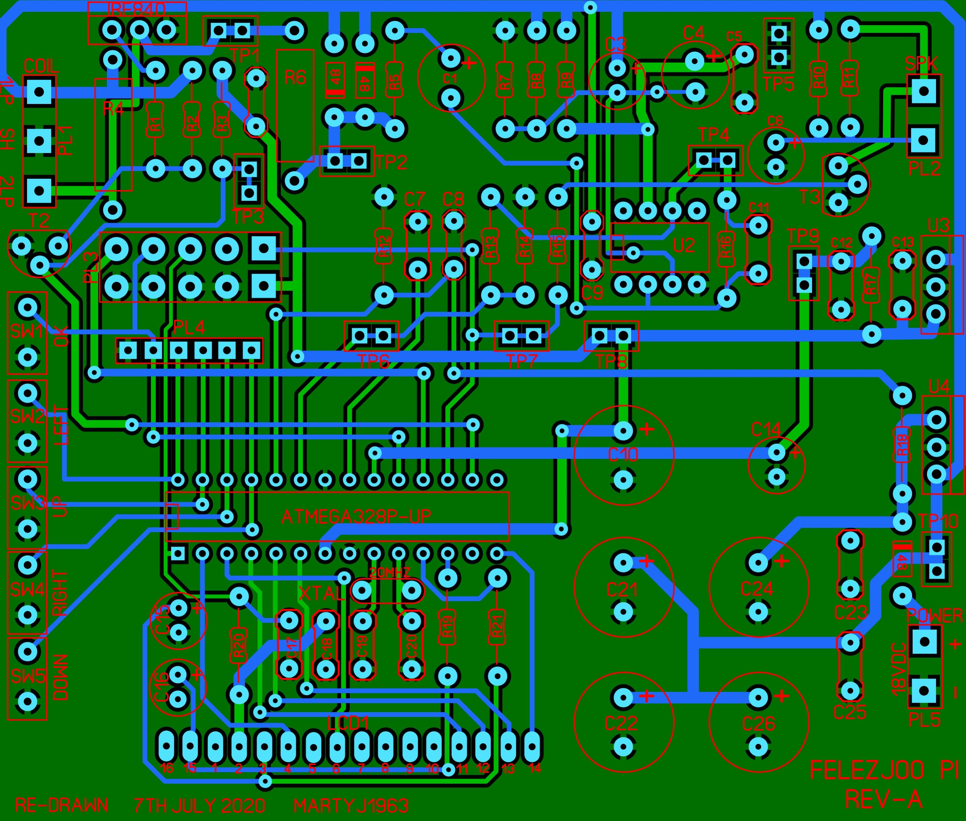

Could you tell me if this pcb is correct it is that I am interested in continuing the project.
Another thing you know if the capacitors, C2 and C3 of 18 pf I can use about 20 pf is that where I buy the parts they only sell this clear for the Typon2 version
They believe that this file is correct, I mean the scheme and the pcb, anyway I upload the photos.
I can't use 20pf capacitors instead of 18pf capacitors, it is because the store where I buy them does not have them.[ATTACH]55405[/ATTACH][ATTACH]55406[/ATTACH]https://www.geotech1.com/forums/atta...3&d=1594166297
FELEZJOO REV-A.rar
I have the list of all the components, it is only preliminary since the diagram does not say the voltage of the capacitors, for the FelezJoo Rev-A.but you could tell me if the schematic and the pcb are correct.I apologize for my poor handling of English.: |

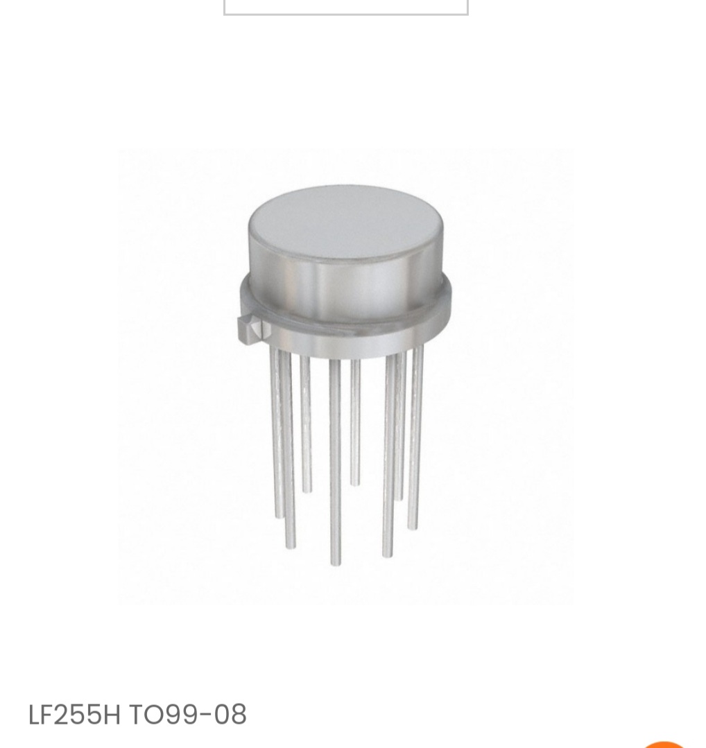

The designer of this machine (Hamid) stated the following on his original web site: "I emphasize that no metal detection capability is limited in this design. " After reviewing the schematic, I can assure any builders that this design cannot properly first sample at say 6uS - the point where you begin to find small gold nuggets. The reason is the choice of pre-amp design. There are faster DIY pi machines available on Geotech.
LF255H = 5v/uS + 2.5MHz Gain Bandwidth LF357 = 50v/uS + 20MHz Gain Bandwidth
In other words, you can't use LF255. If you want Felezjoo PI to work as it should then you must get LF357N/MAC157/MAB357/
Mr. Hamid made clear on the instructions that the most important part is the LF357 and it should not be countefeit or anything else than a genuine LF357.
