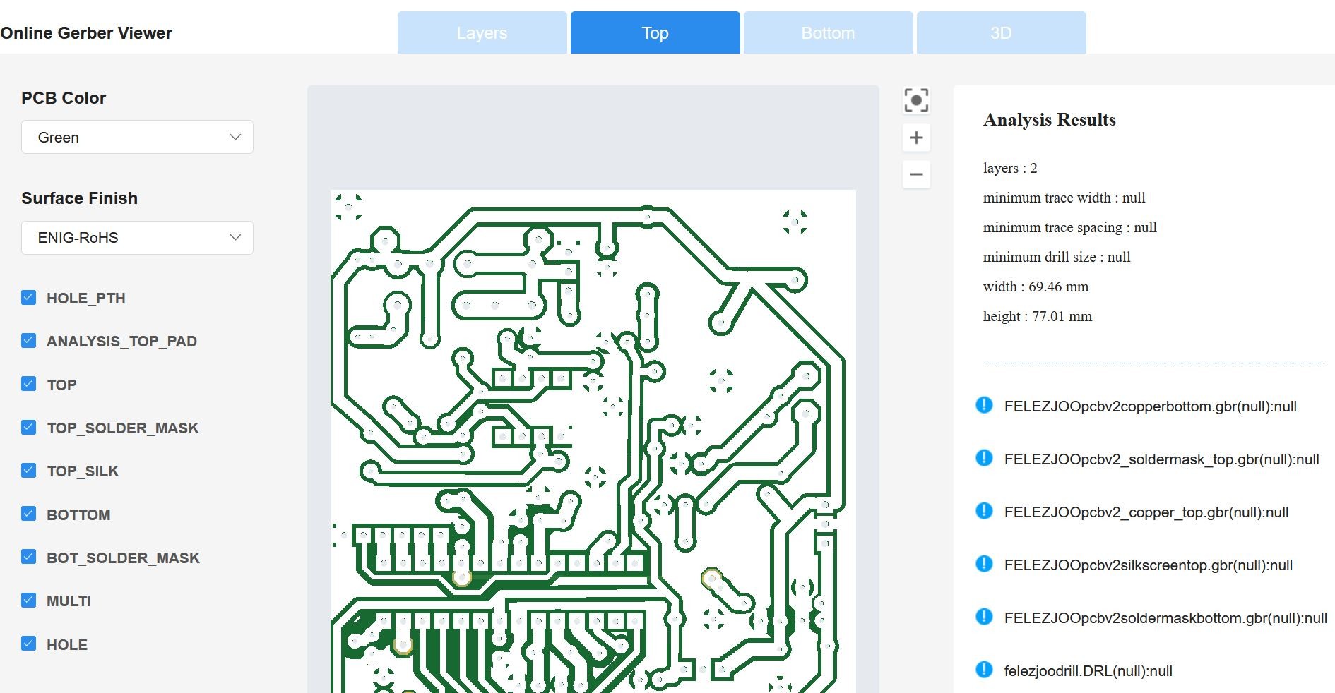

          • Hi all ,did some one have the felezjoo .brd files?
            i would like to send it to " jlcpcb".
            I have the .lay files but when i make the gerber files with sprint layout 6 the bottom lay,top lay ,in print lay aren't at the good place for "JLCPCB"
            thanks all
            • i asked them via the field MESSAGES, can they use just LAY file. but right now they are not on-line. wait a reply.

                    • hi all
                      thanks for your reply ivconic and KT315 .
                      ivconic ,i ve send your file to jlcpcb and ..... it don't works !!!!!! it say "your file has been saved into your files manager " and 0 layer detected .
                      when i want to see them with gerber viewer it say "unable to preview"
                      i ve corrected my file like you say and........ it make the same things ,layers are not a the good place .
                      i don't understand!!!!
                      capture of my files--->
                      • hi all.
                        Hurra!!!!!!! thanks all!!!!! it works!!!!!

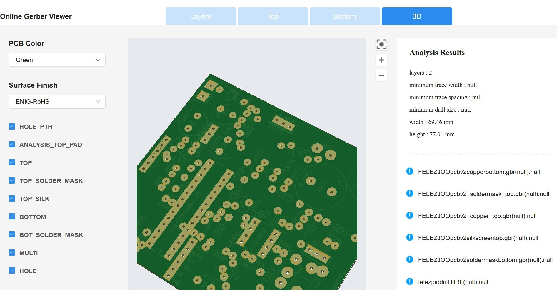

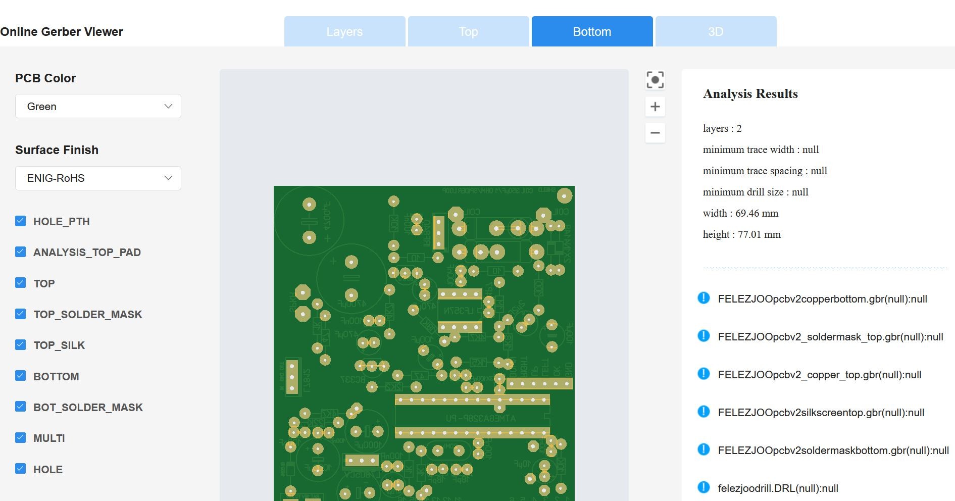

                          got the reply...
                            • promised, without GERBER.
