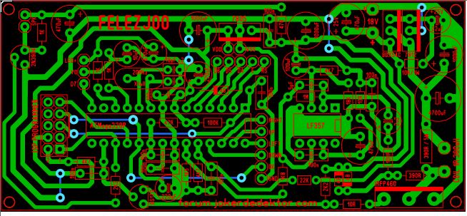

                      hi all friend
                      i search pcb for this version in format pdf
                      thank you

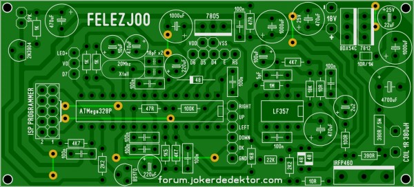

                      • Felezjoo
                        I could say that difference has this version of the others,
                        because the eye has some changes ...
                        such as is to say 18v, while in other versions is to 24v.
                        also the fact that it has the IRF840 but has the IRFP460 and BDX54C and other minor details.
                        improvements or disadvantages might have.Click image for larger version
