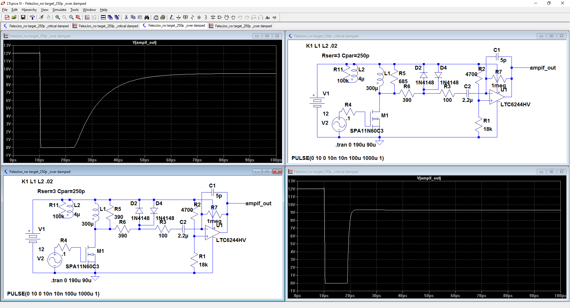

    No target simulation. Change R11 to vary target time constant. L/R, 4uH/.1 ohm=40usecTC about the same as an aluminum soda can. Change L1(C par)to see coil resonance effect. Change R5 to damp coil with different C par. Playing with C par in spice, I'm guessing coil capacitance is a big reason coils act different. Adjusting R damping(R5) should solve the problem.

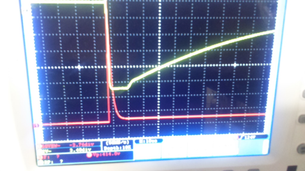

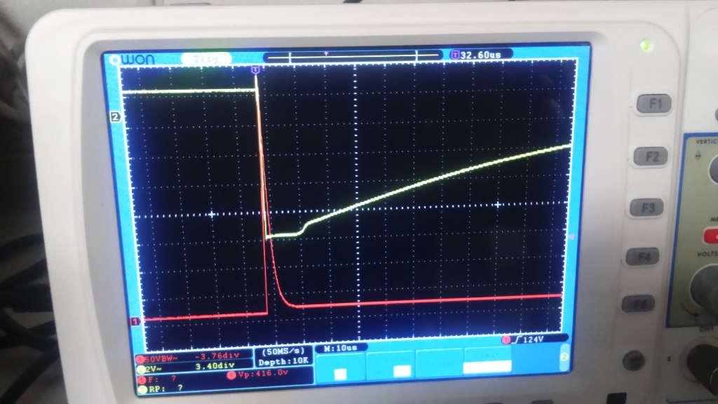

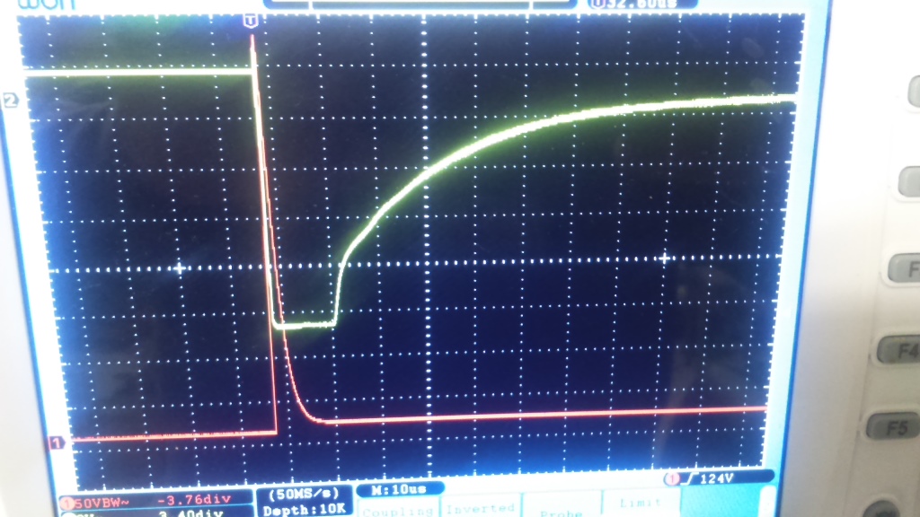

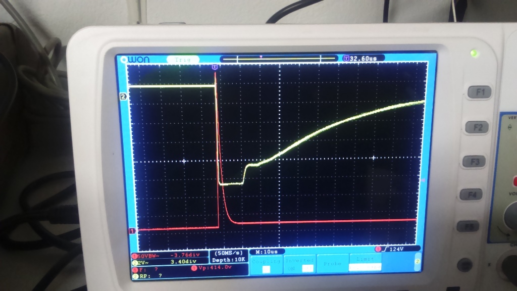

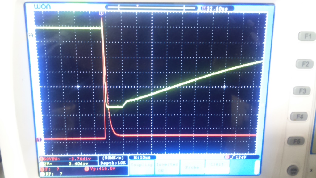

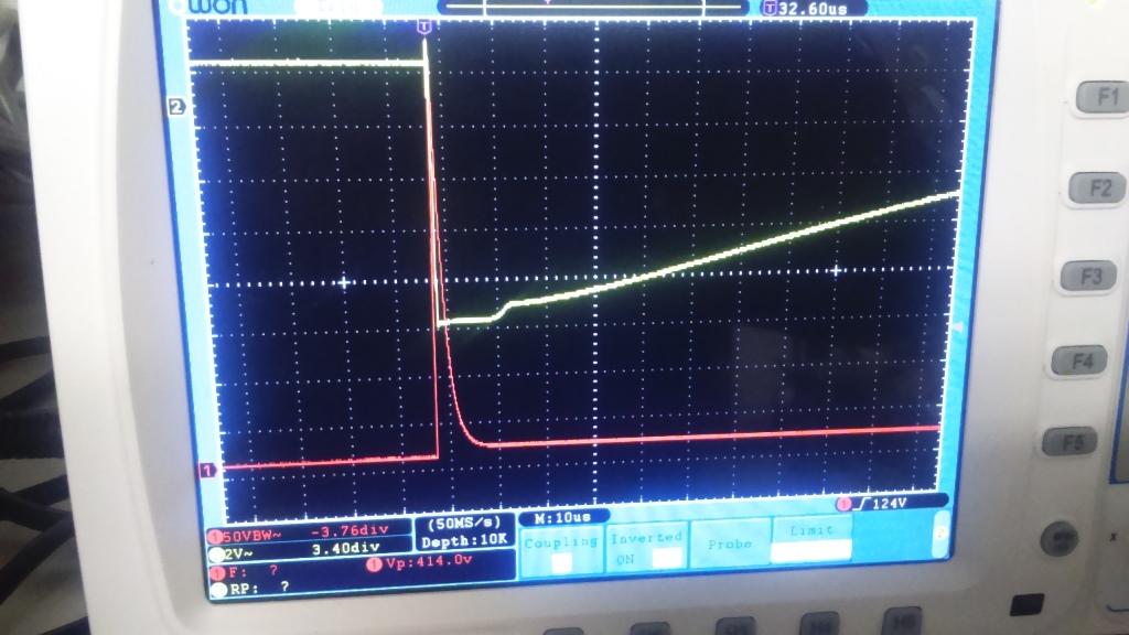

              I connected the scope at out of front end IC and i took photos with different ics. I took 2 photos for every ic, one without any metal near the coil and one with a soda can 5cm near to coil.
              Here is photos from LF357
              • Below is a AD797 and finally is a LF356.
                It is clear that the LF357 is the ""winner"""
                          Thanks for the tests and the scope pictures.
                          Comparing your no target picture with a spice no target analysis, it looks like your circuit is over damped. Including a spice analysis with a lower coil capacitance to give a decay similar to yours. Changed damping resistor(R5 spice, R12 felezjoo)to critical damp. Wondering if adjusting the damping changes the detection distance. If I had a Felezjoo circuit I would do a test. First, record the detection distance for an aluminum soda can(bottom end toward coil, 40usec TC) and a piece cut from the side of a can(1x1 inch, 5usec TC). Second, adjust the damping resistor to see how close to the spice picture I could get. Third, repeat the target distance measurements. If you or anyone tries the test I would be interested in the results.
                          Thinking need to keep the critical damped no target decay below 9.5volts, underdamped(overshoot) might cause a problem
