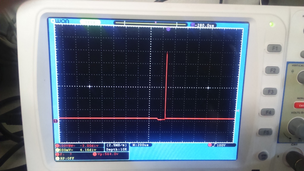

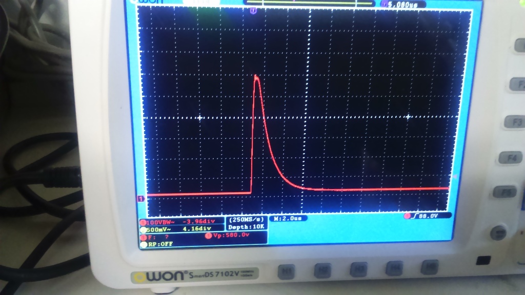

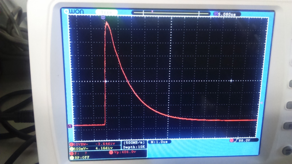

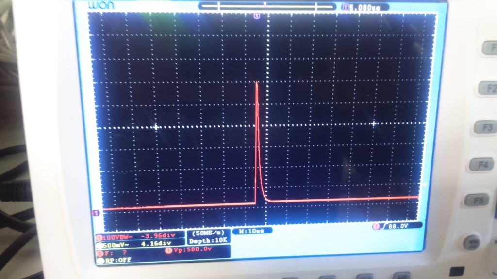

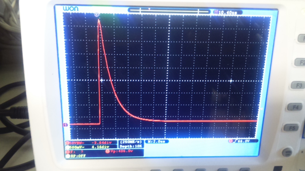

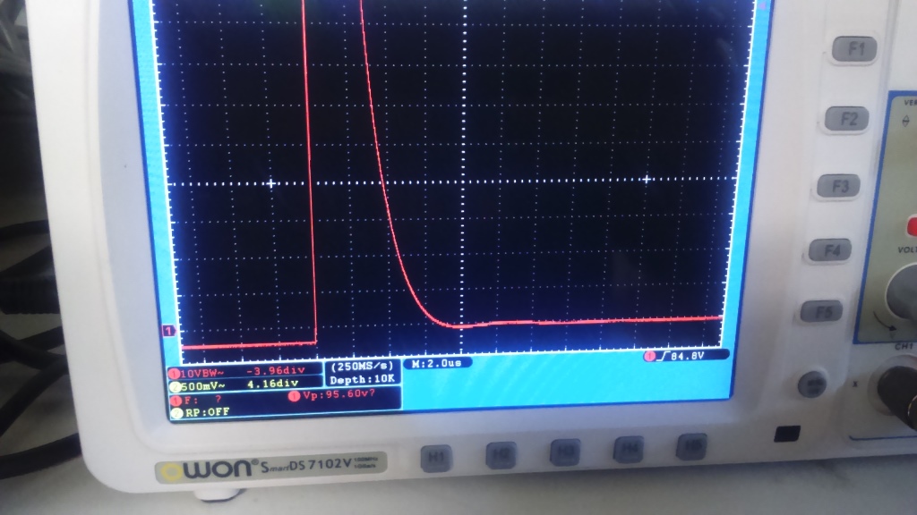

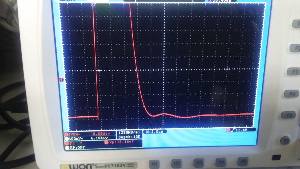

  • ML Commander 11" mono coil
    A=253 B=626 C=764
    Sens=15 delay=19 (13+6) Speed=10 GB=5
    It detects a 1Euro coin at 26cm and a soda can at 55cm with continued sound.
    • Whites TDI 12" Dual Field
      A=345 B=691 C=786
      Sens=15 delay=19 (14+6) Speed=10 GB=5
      It detects a 1Euro coin at 25cm and a soda can at 55cm with continued sound.
      • Home made Basket 40cm coil (15.5")
        A=277 B=578 C=720
        Sens=15 delay=17 (11+6) Speed=10 GB=5
        It detects a 1Euro coin at 28cm and a soda can at 67cm with continued sound.
          It makes sense, TDI coil is concentric coplanar right?
          It's RX coil is smaller than at other two coils?
          Also i guess it is most precise in behavior, among all three coils, right?
          I did not check about discrimination or ferrous reject.
          Maybe later...
          I think that Commander and DIY coils needs a series resistor because they have smaller resistor than 1_Ohn that Hamid gives. Also if we see at waveforms we see that at these two coils there is something as small oscillation maybe from higher current.

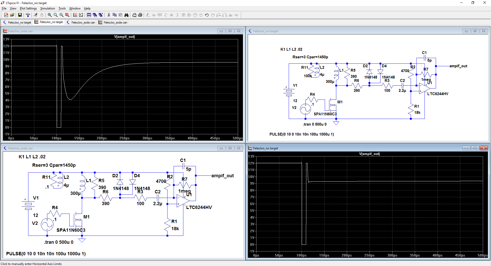

                I was thinking bias current but maybe not. Have you compared amplifier out with the LF357 and the LME49990. Including a LT spice simulation of what I think amplifier out might look like with no target and an aluminum soda can.

                              Hi Green would you mind posting your spice file thanks,
                              would be handy .
                              No target simulation. Change R11 to vary target time constant. L/R, 4uH/.1 ohm=40usecTC about the same as an aluminum soda can. Change L1(C par)to see coil resonance effect. Change R5 to damp coil with different C par. Playing with C par in spice, I'm guessing coil capacitance is a big reason coils act different. Adjusting R damping(R5) should solve the problem.

                                Do you have a scope? I would be interested in seeing amplifier out, similar to reply 1207 with the two different amplifiers(LF357 and LME49990). It might be easier to answer your question with the scope pictures.
