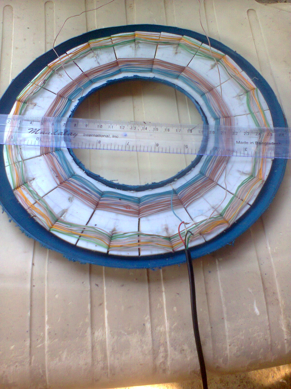

        I prefer small (20 to 25cm) coil and use manual set up for delay, usually around 20, and spider kind of, because it is easy for me to set it up.

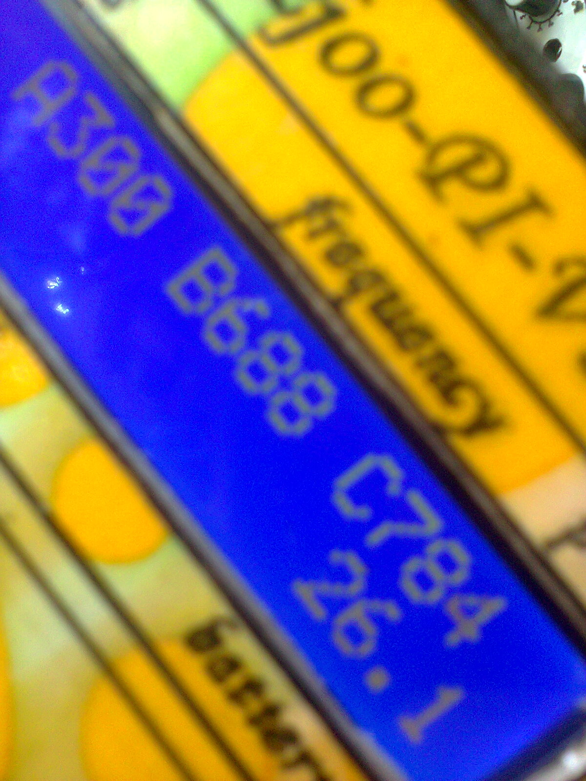

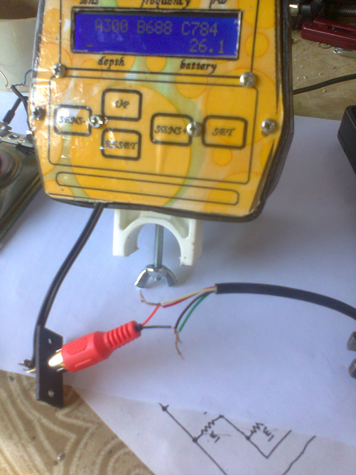

        Here are some pics of 25cm coil I just made and as You can notice wires are not soldered yet so a)300 b)688 c)784 will come in place after soldering and
        making all rigid.

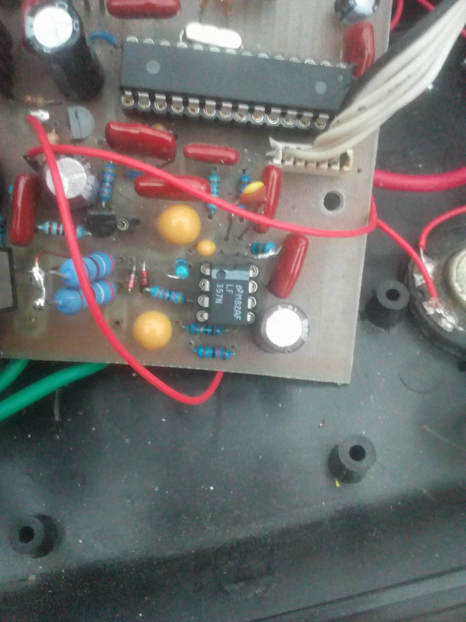

                • ici 357 is not original

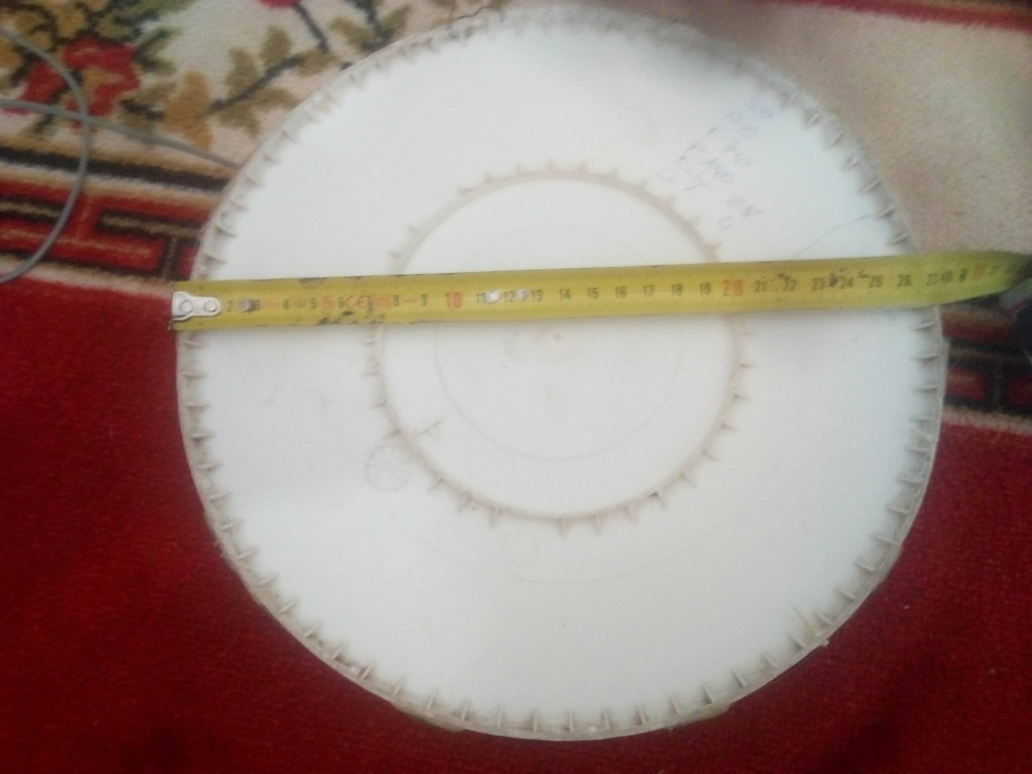

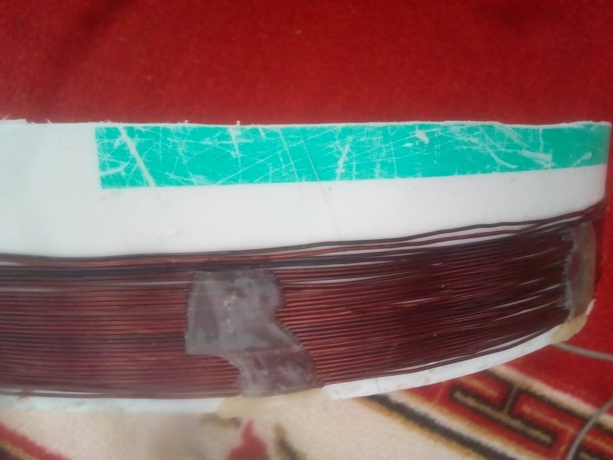

                  • Here the coil 27 round diameter 28 cm
                    Wire diameter 0.7 mm
                    And voila 357 is it original ????

                    • Hi marin2
                      inductance of Your coil is too high 591uH, Try with 25 turns and if not good enough, go to 24, lf357 looks ok but do not use holders for transistor, just solder it directly on PCB.
                      A little bit more about coil - try some other tips (basket or spider), there are a lot of examples on geo.
                      regard

                          there are a lot of coil calculators online, just go to google and try (coil calculator), I am a little bit confused with Your debug numbers.
                          What are they exactly? a=? b=? c=? (300, 700, 800 - optimum)
                          • to Cvele
                            debug numbers
                            A 32 B 35 C 39
                            • No, it cannot be!
                              May be 320 350 390. In that case lf357 is fake.
