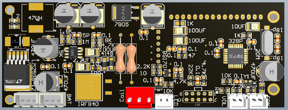

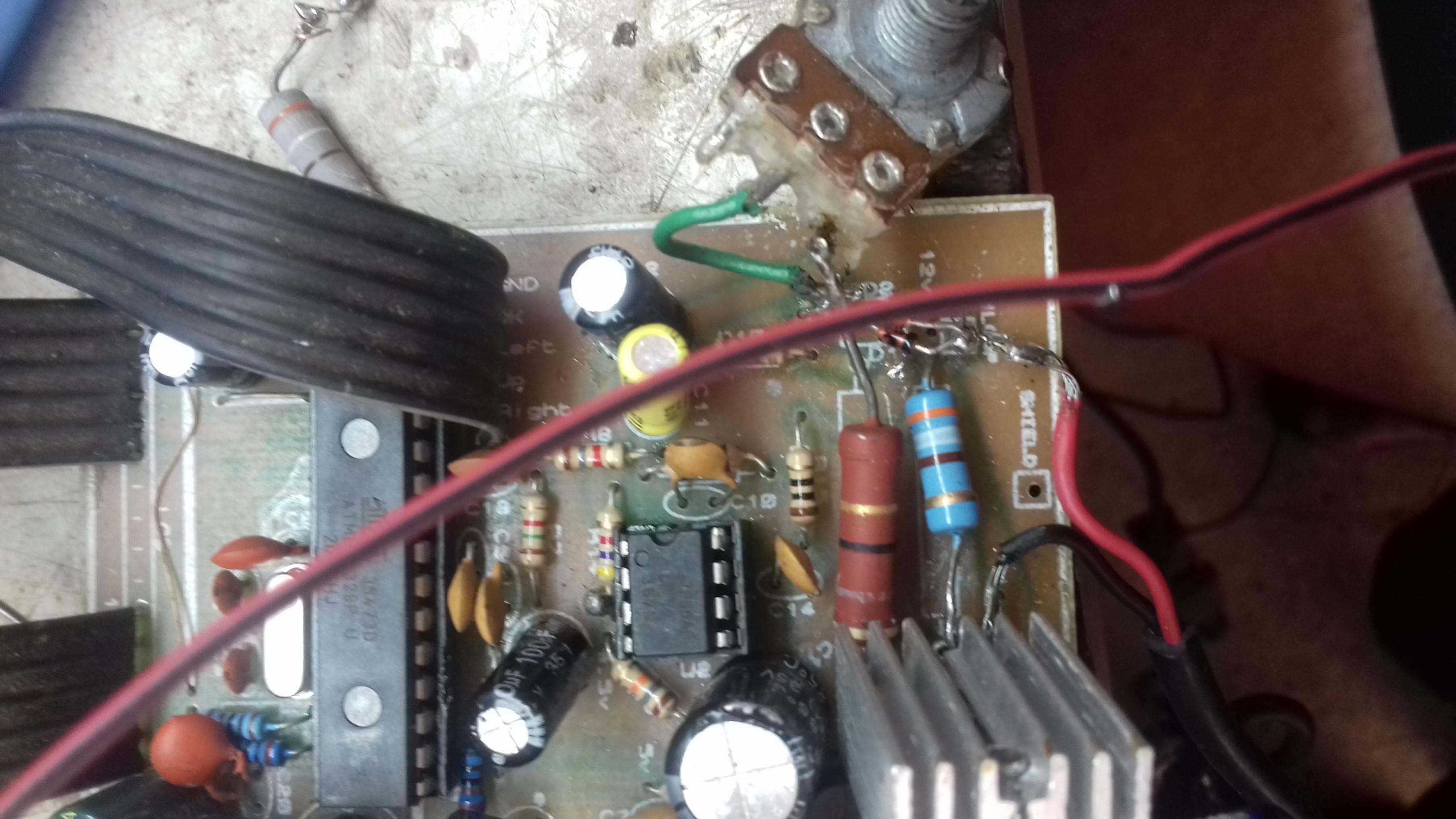

    Hi,Do me a favor And tell me why the coil err,Thank U.[ATTACH]53721[/ATTACH][ATTACH]53722[/ATTACH]
    Hello. First adjust delay D0 to D30. Did you measure the coil? Hod did you build the coil? Put a picture of the pcb.

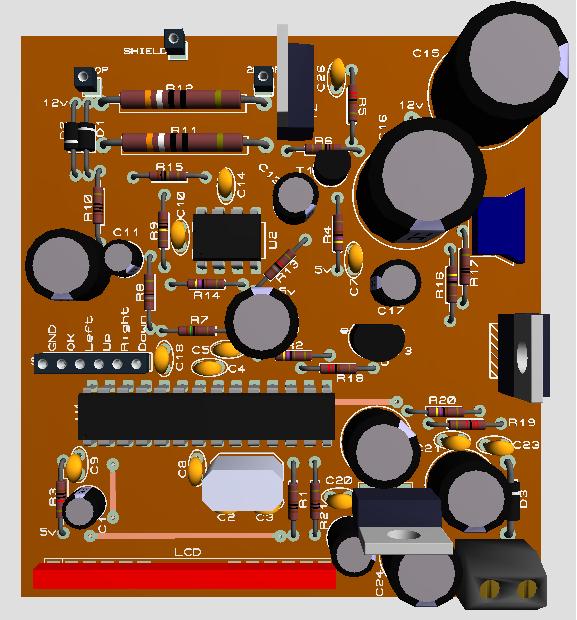

    • Thank U my dear friend,I've built the coil and conect the pcb,but when i put the metal over the coil and hold still is no sound,move the metal to cut magnetic field is OK.I build in picture A,hat's the reason for this?Another question, picture B and C are felezjoo pi smd?who has the Lay and Sch?

ID:	358582 substitute r11 por resistor 80r +trimpot 1k.....c11 tantalum=2.2uf eletrolitico bipolar

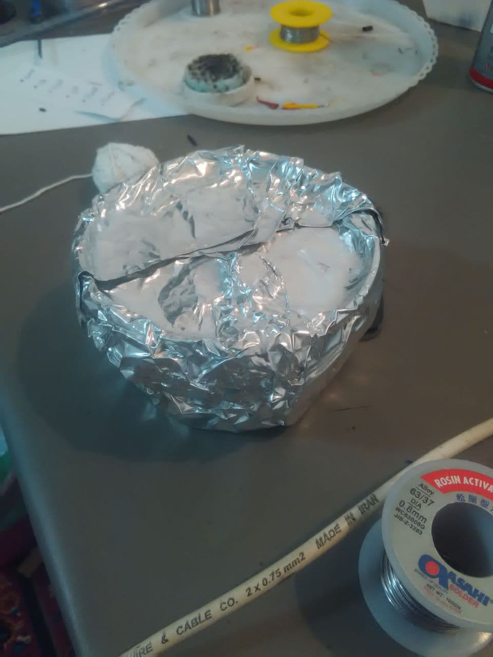

              • Originally posted by amindevil View Post
                Dear Jaick
                Shielding the pcb with metal box is not a good option.instead you can add a pcb and solder negative of the fpi to it. It really helps
                Adding graphite to the coil makes it much heavier
                thank you amindevil
                I conducted some experiments myself so results are:
                i put some different metals in a plastic box and completely shielded it with thick aluminum foil then connected the foil to the pcb shield point with a long wire
                to test it on the coil
                it detects the box
                i tried without the extra metals, still detects it's shield point (GND)

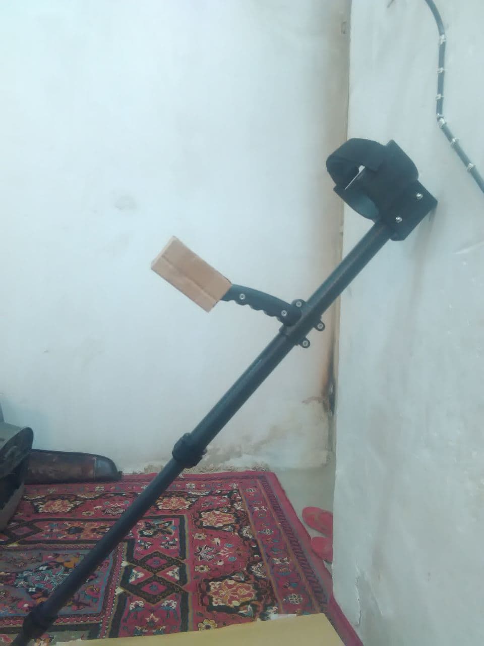

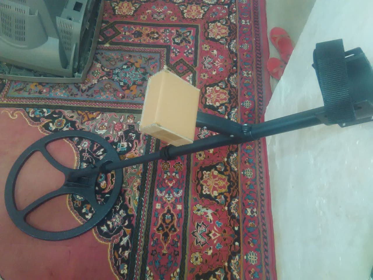

                so my problem is that i need to put the lcd in front of me to see some data
                and the only way that i know to do with my available handle is down blow
                it's a card board model of a box i want to use
                i worry if the PCB would interfere with coil or not
                one guy over here did the same thing with a bigger plastic box and says it won't interfere if you are careful with angle and distance
                I don't know what to do

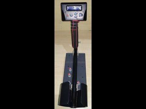

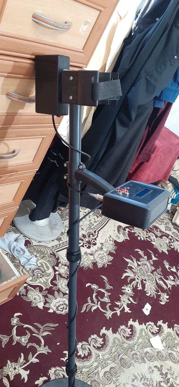

                  • Dear Jackie
                    A friend of mine have Don that I mean he put the device on the handle like you did and it was not detected

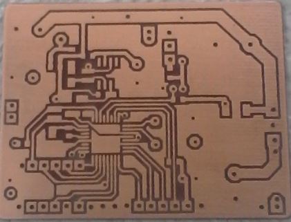

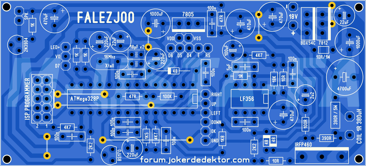

                    • new pcb drawing...
                      Dear selim, in this pcb 7805 does not receive power supply
                      voltage. What is the reason. Is there a correction.
                      Sincerely, etwert
                      • link broken
                        pls put picture direct as forum upload
                        • Attached Files
                          • ahh ok thx, seems mustafa design, (also made a version of pim2)
                            maybe you have to turn 7805 regulator 180degree in orientation?
                            • ok i looked falezz layout from mustafa,7805 is ok
                              seems interesting coil driver BDX54C, 7812, IRFP460
                              also use of lf356 instead lf357
                              • Thank you for the information. What is the post number of mustafa, please.
