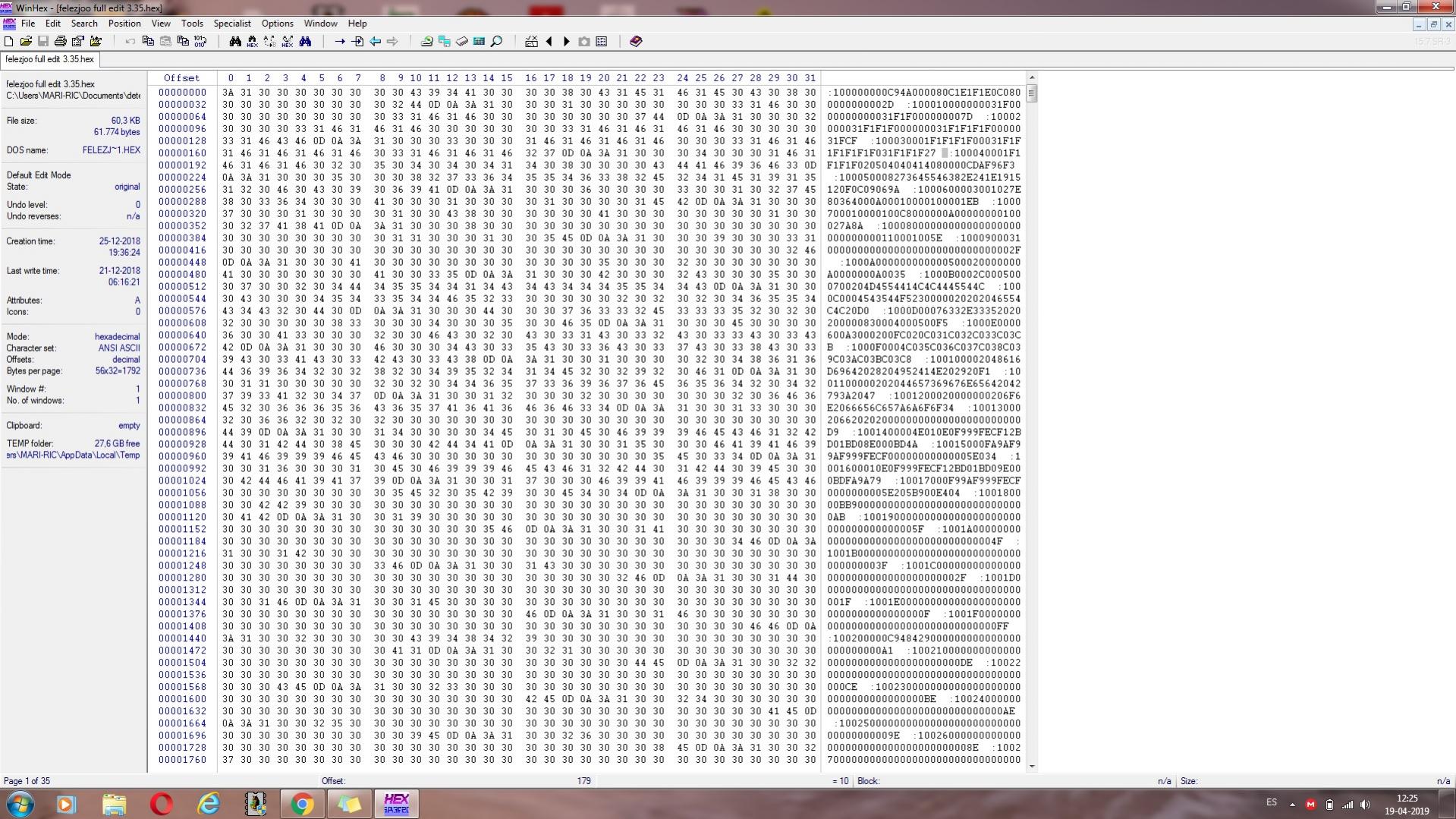

  • Hello, someone knows how to edit the detector's start, instead of saying "felezjoo pi" say my name?
    • Yes, its very simple. Pay author 20 000$ or what was price of original code and just change text
      • Send nice message to author, thanking him for a great project. Then ask him to customize the code just for you. Maybe he'll be sympathetic.
ID:	353836 with this program you can edit the .HEX but I do not understand which part to modify

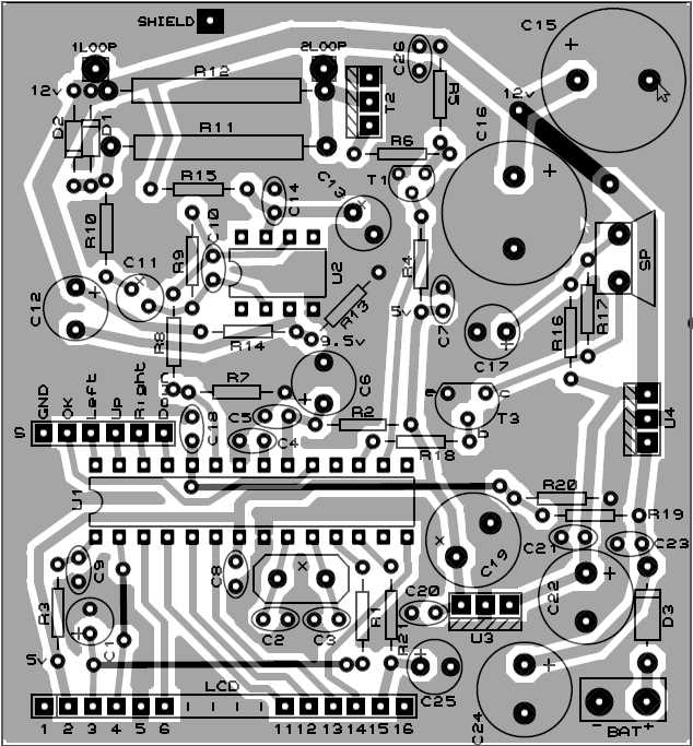

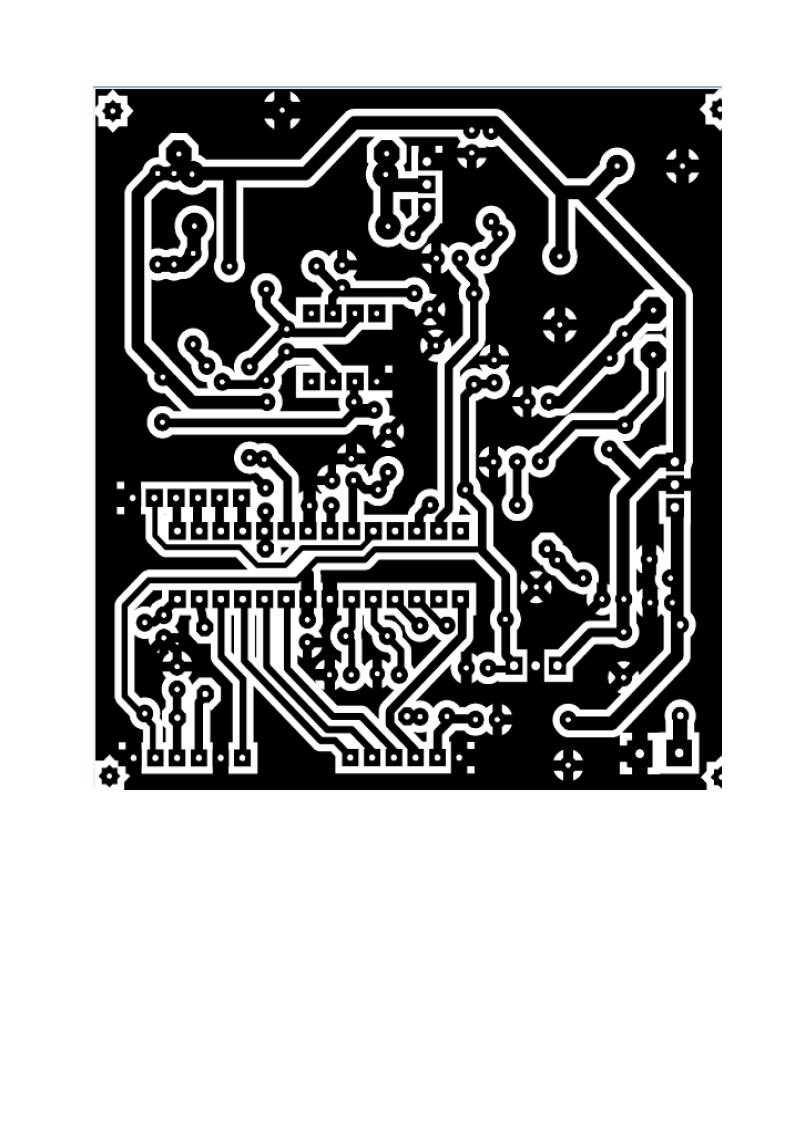

                          • Hello guys
                            Want to try this PI..I see there are lots of pages about this in this thread and as i can tell the final version of this pi is 3.30...It has some locking feature i dont really mind but is its descrimination works??I saw 2-3 different PCBs on this thread can someone direct me to a correct one?Or if by any chance there is a project file (schematic + BOM)..Ive downloaded 2 files i dont know if they are correct

                            • The tow is correct but t the second is the original one
                              • Can someone post a link for valid copper side and component side??
