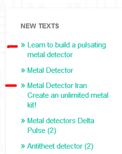

      • Ooops!
        See links for detector.
