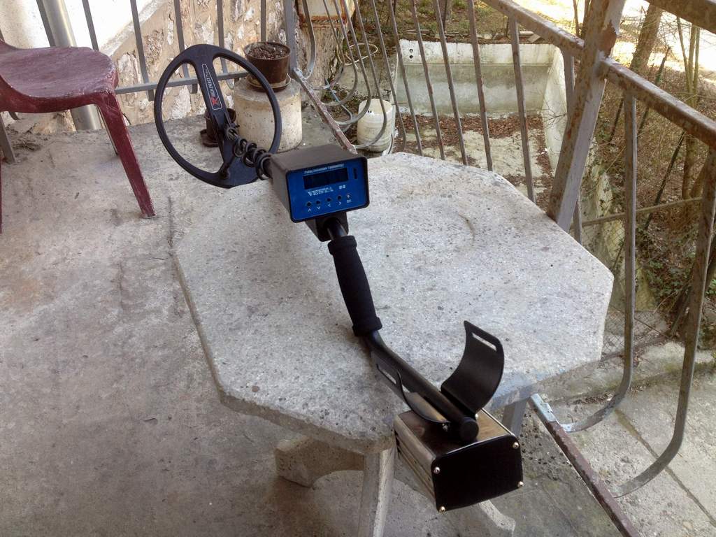

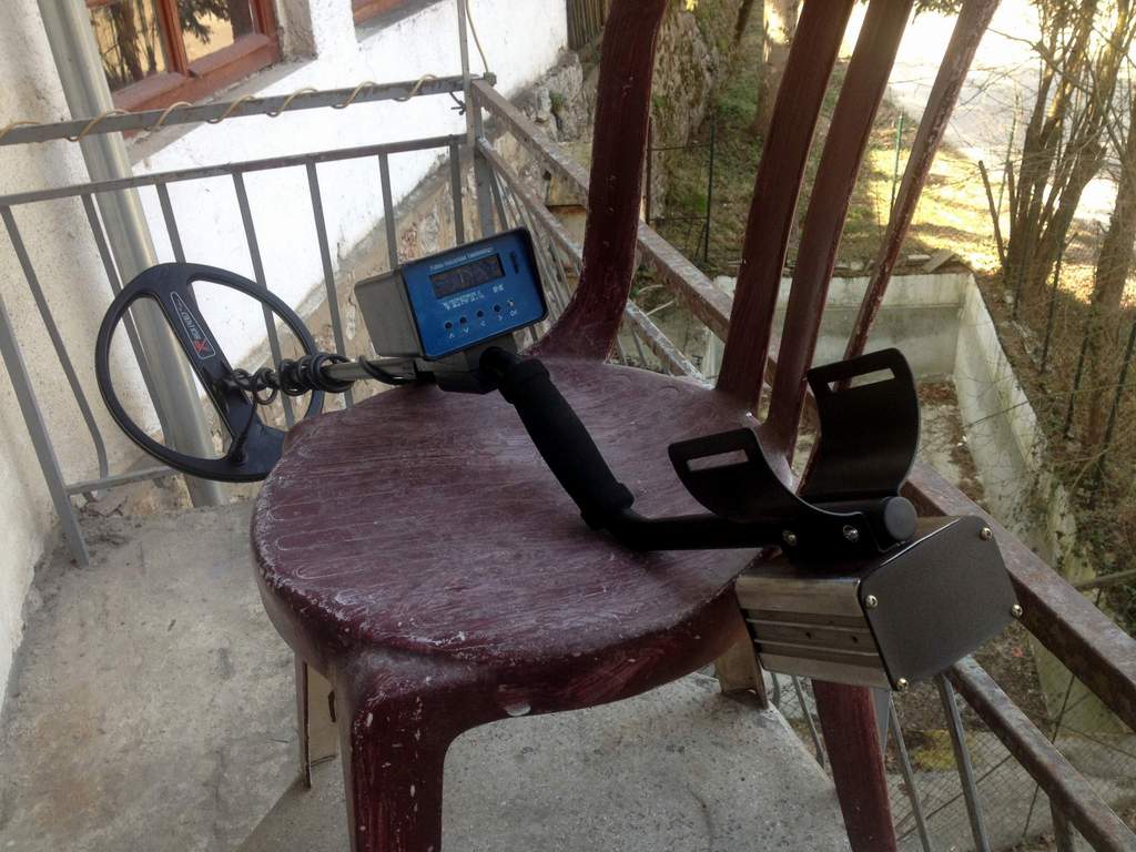

  • I just completed this one.
    So far it performs excellent.
    Later on i intend to take it outdoor for final testings.

    • It's look very good!
      It's coil a genuine XP one?

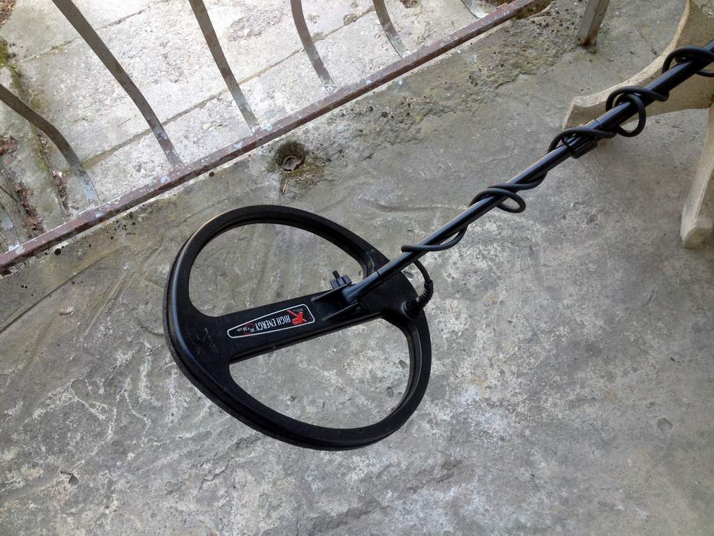

        • Originally posted by Altair View Post
          Of course not!
          It's just salvaged empty shell from XP coil.
          I put new and quite different windings inside.
          That coil performs quite good!

                  Nice Crazy man... Hahahah
                  What Coil Is Inside You Put bro
                  and What volt Power Source you use

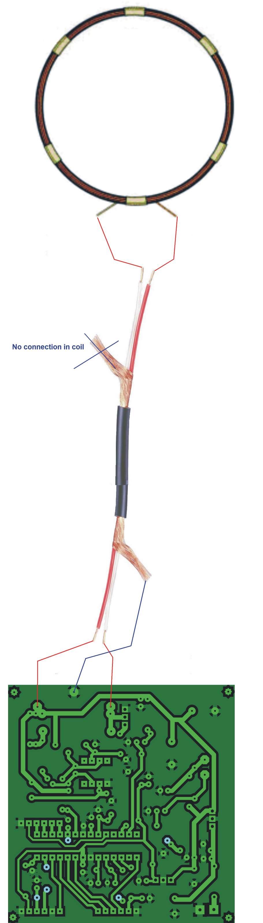

                  • [QUOTE = ivconic; 229145] [/ QUOTE]
                    ivconic hello
                    The sahada makes a sound
                    Cause???
                    Finding metal no problem
                    sens After 12 grond Too much noise ???

                      Coil or cable at coil. Common issue.
                      • thank you so much
                        What's the solution???

                          • @gurdal & smit22 i hope this will answer both of your questions,
                            first make sure that you used cable like on picture and connected pcb-cable-coil like this:
                            @smit22; no coil is not shielded.
                            • thank you ivconic
                              Like that when it approaches the earth
                              Is it necessary to shield
                              This problem when it comes to 18 sens
                              But sens 12 there is no noise
