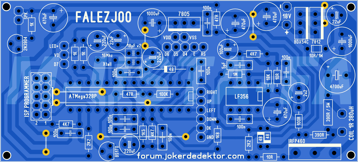

    Found the beast mkavr ... It is working fast now ... The only problem now that when unplug the coil it starts normal when i plug it it dont start and the voltage across the 12v and the 9v and the 5v drops doWn changed irf 840 but still not starting up with coil pluged i have to make another pcb thanx for help
    I think it is about the coil. Most probably resistance is too low and inductance is inadequate and because of that transistor acts like a "short" junction.
    Just for fast experiment on this; add in series with coil 4.7 ohms/2W (and larger) resistor. If should start than.
    • new pcb drawing...

        • Isnt it different detector? 16MHz crystal, BDX54C, LF356...
                Thanx friend i will try this tonight

                    All PCB are working. Last pcb worked after 2-3 modification on the given forum link.
