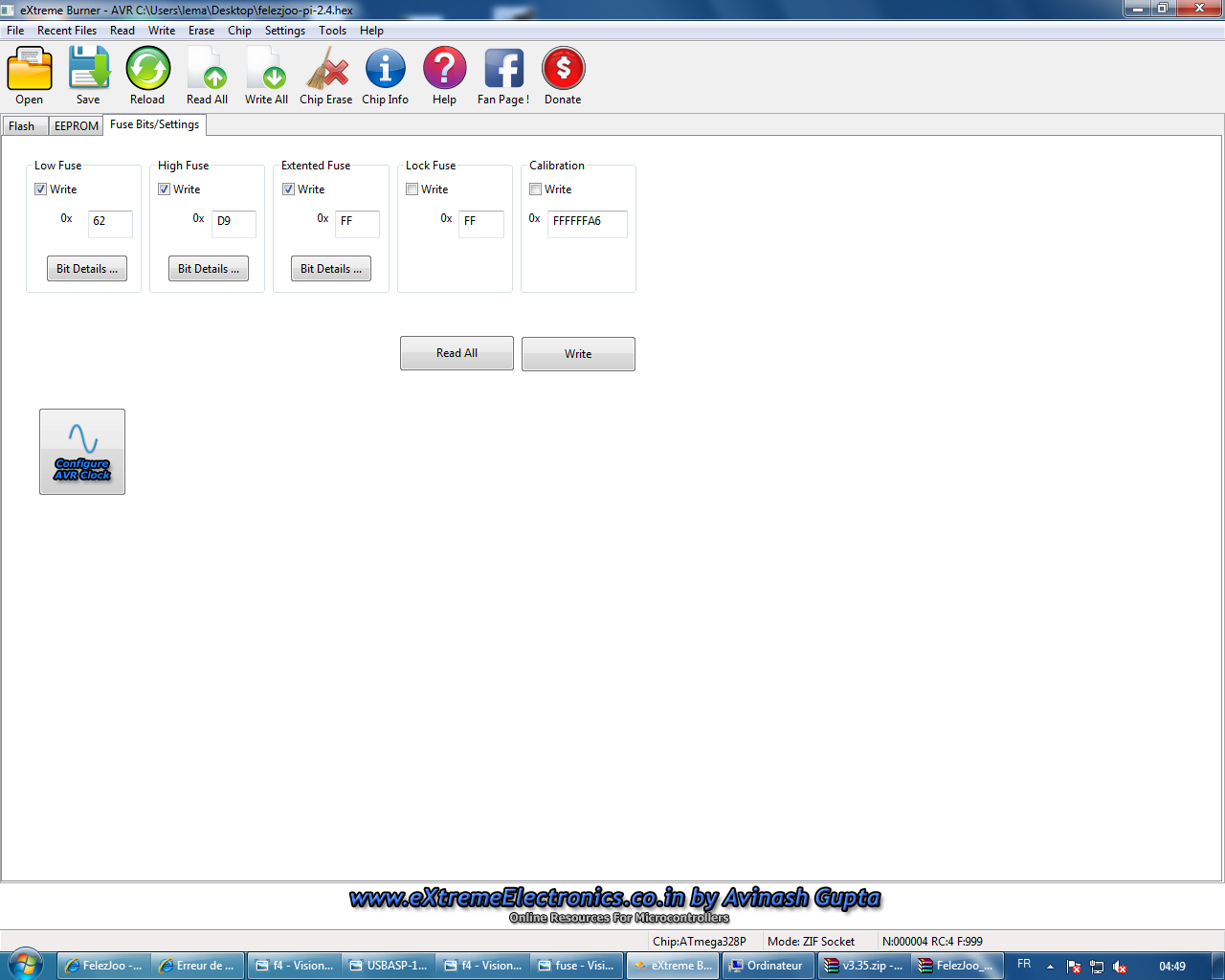

      SLOW? It sounds like a fuse problem. Could you check your fuse value with extrem burner ? You can also check the quartz and its capacitors.
      I have the opposit trouble with my unit. It's too fast ... i have to check the keyboard wiring.
      I'm waiting for your fusse config..
      this are the fuses after i burn the hex on atmega even i try to burn old hex version and at last fuses turn to this...... any solution???
          I have just tried this for you, after I burnt the fuses, I read them back and yes they do read back differently to the original burn settings , I have different read back values to you, I hate avr's maybe somebody knows whats going on, I cannot test the chip right now.

                I just did this test again,you must tick the 3 little WRITE box's above the fuse boxes, so open the fuse window and tick the 3 box's and make the fuses the right value, and then burn the hex
                now when you watch in the window the progress of the program burning the hex you will see the fuses being burned, then if you read them back all should be ok.

                  When you put your low value fuse 62 into a fuse calculator , it indicates that the clock is divided by 8, maybe thats why yours is running slow, its only a guess, I hate avr's

                    thanx friend i did that but it keeps changing the fuses every time and the felezjoo still slow do you know another good hex burner .... i saw sonone on this forum talking about mkAVR

                      avrdude -c usbasp -p m328p -U lfuse:w:0xf7:m -U hfuse:0xd1:m
                      It will work only if avrdude is available on your computer. AVRDUDE install automaticaly with winavr software.

                            Found the beast mkavr ... It is working fast now ... The only problem now that when unplug the coil it starts normal when i plug it it dont start and the voltage across the 12v and the 9v and the 5v drops doWn changed irf 840 but still not starting up with coil pluged i have to make another pcb thanx for help
