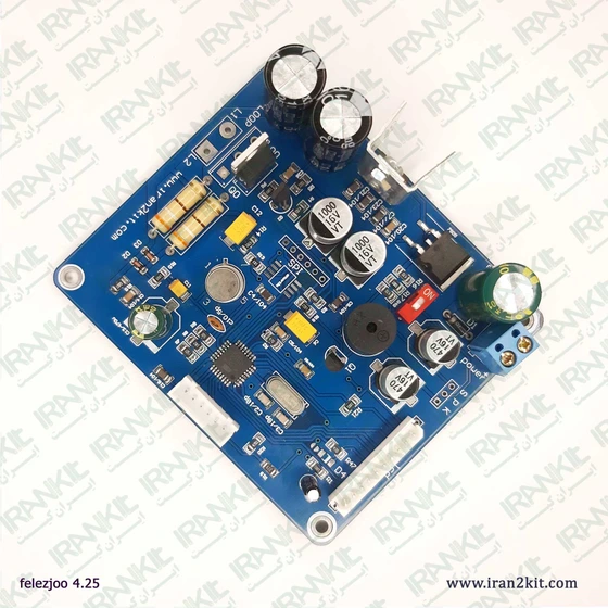

                            • Hello
                              i have problem with felezjoo
                              when i connect the coil to device and power on device not work lm7812 getting hot when i disconnect the coil power up device turn on and connect coil work normal what the case ?
                              Help me guy
                              • Most likely your 7812 is fake when it draws a current and shuts down. I already had this problem.
