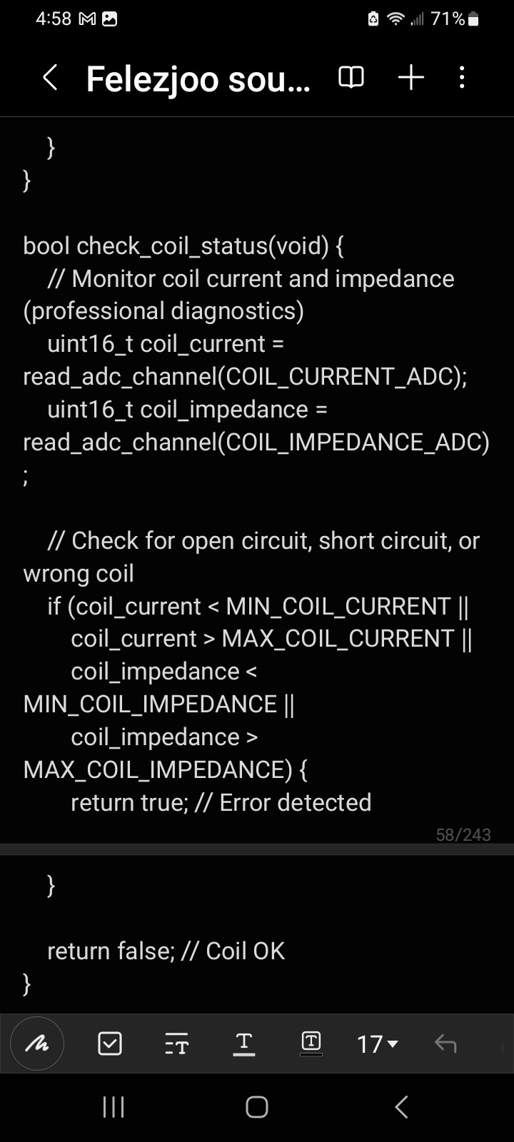

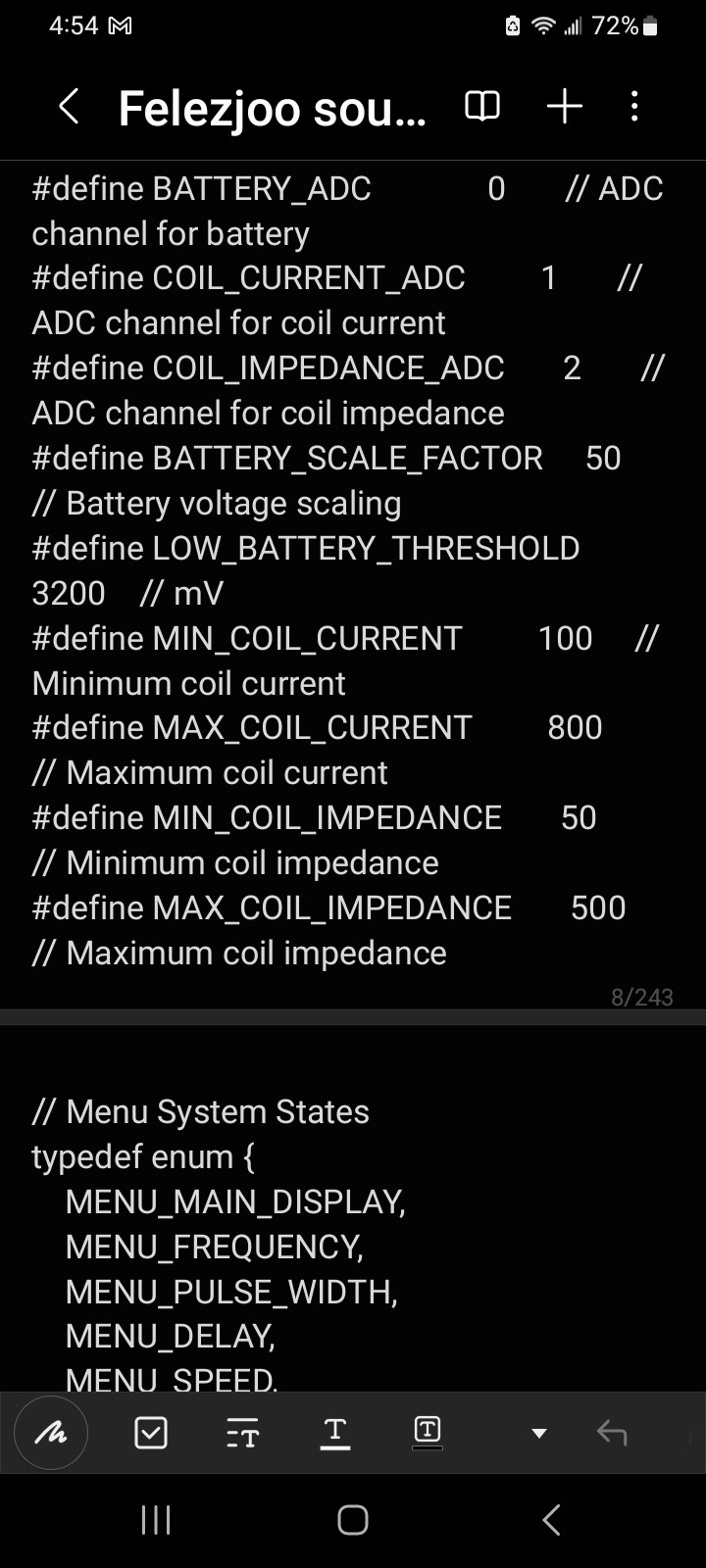

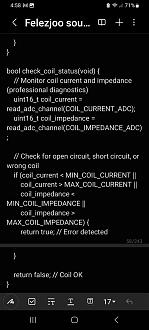

  • Originally posted by Aadu View Post
    Could it be a problem with the coil cable, I have all the coils built with speaker cable. It worked well for the Clone Pi AWR. The auto delay is 19, 390mh, 1.2 ohms.
    That is something youll have to try to work out. Do you have the capability to test your coil parameters (scope and test equip)?
    I will go check my docs and see what the coil parameters were, they are definitely specific to this detectors code and will set the coil alarm if not within the paraneters.
    Edit: some screen shots of adc parameters. Click image for larger version  Name:	Screenshot_20250721_165840_Samsung Notes.jpg Views:	0 Size:	154.9 KB ID:	439434 Click image for larger version  Name:	Screenshot_20250721_165444_Samsung Notes.jpg Views:	0 Size:	194.8 KB ID:	439433

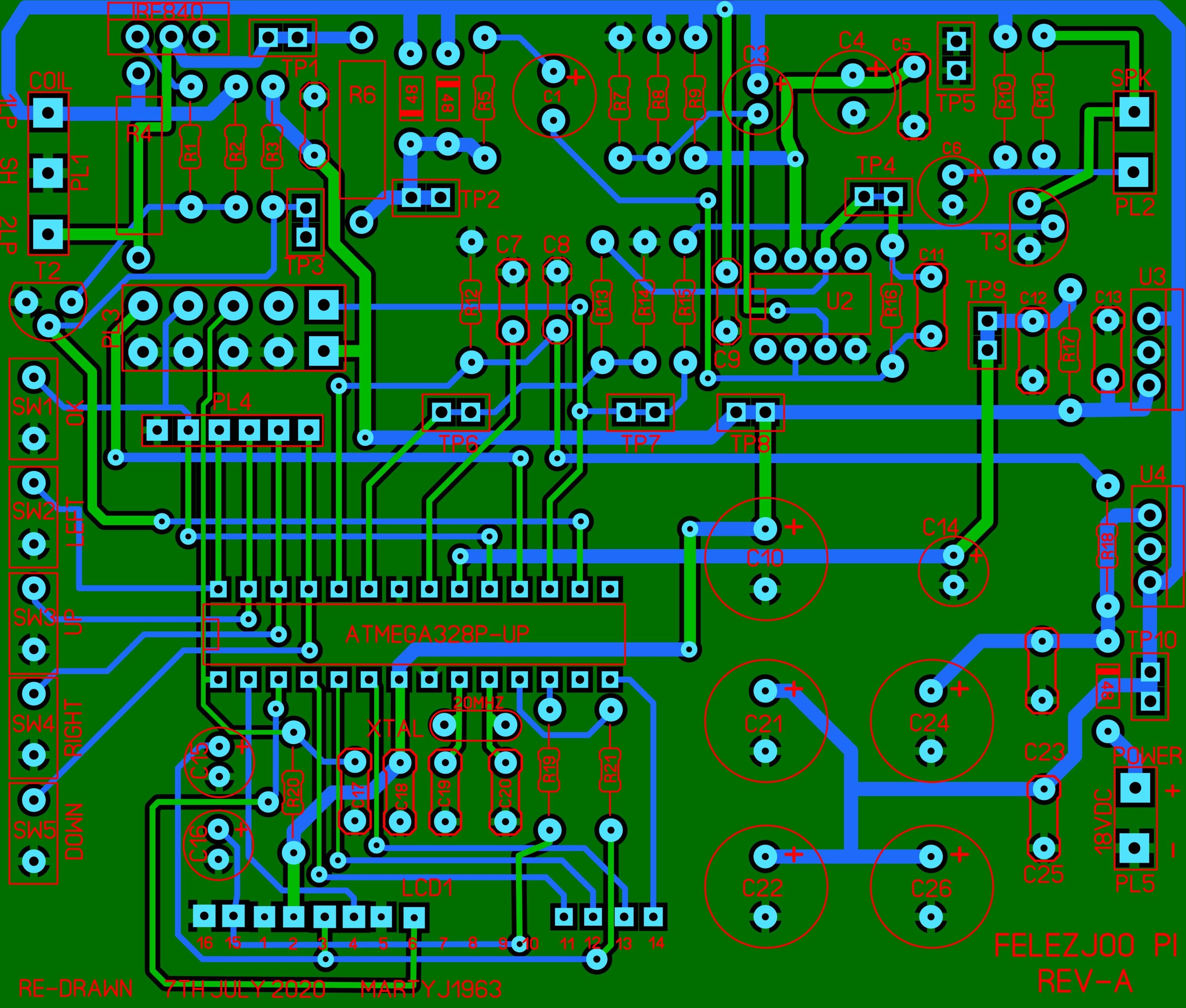

        • Hello. Question about the resistor. In all the diagrams R5 is 2.2k, but on the printed circuit boards it is 10k. Why was it changed?

            Regarding your question about R5 - its value is not critical. It serves to turn on the key mosfet and this load only the input capacitance of the IRF740/840 and the output capacitance of the driver transistor-BS170. It does not matter how long the IRF740 will turn on, because the pulse duration is long enough. So whatever value you put in the range you quoted, the TX stage will work. A smaller value will turn it on faster and there will be smaller transient losses in IRF740, but in this case this does not matter at all.

                              • I made this modification to the circuit board I'm working on. What do you think?
                                By the way, I'm still having the same problem, since the detector is picking up the stones, which is annoying.
                                It might be the cable I'm using, since I couldn't find RG58, so I'm using one from an old microphone.
                                Also, I installed the 2W potentiometer on resistor 11, and it seems to be working, but the stone detection problem persists.​
