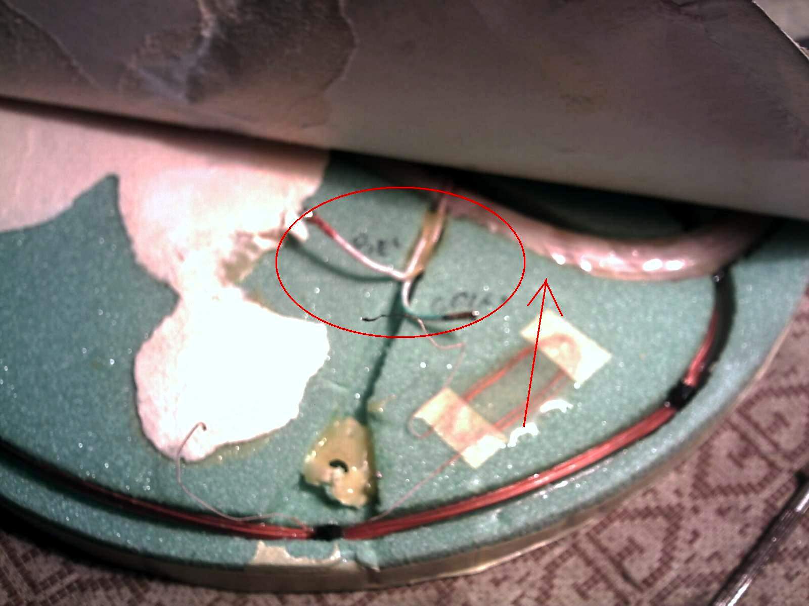

    • I was thinking at the time "if FelezJoo is done according to Minelab patent; than is logically to expect that also Minelab coils will suit it just fine".
      Last time i had Minelab, it was GP3000, so i opened its coil and saw the "morphology".
      They used something similar there.
      Right now i am trying to find a photo on my disk...
      Here it is:
        Here it is:
        [ATTACH]38170[/ATTACH]
        But Minelab's coil is with shield! ... or not!?
        Really unshielded is better ??

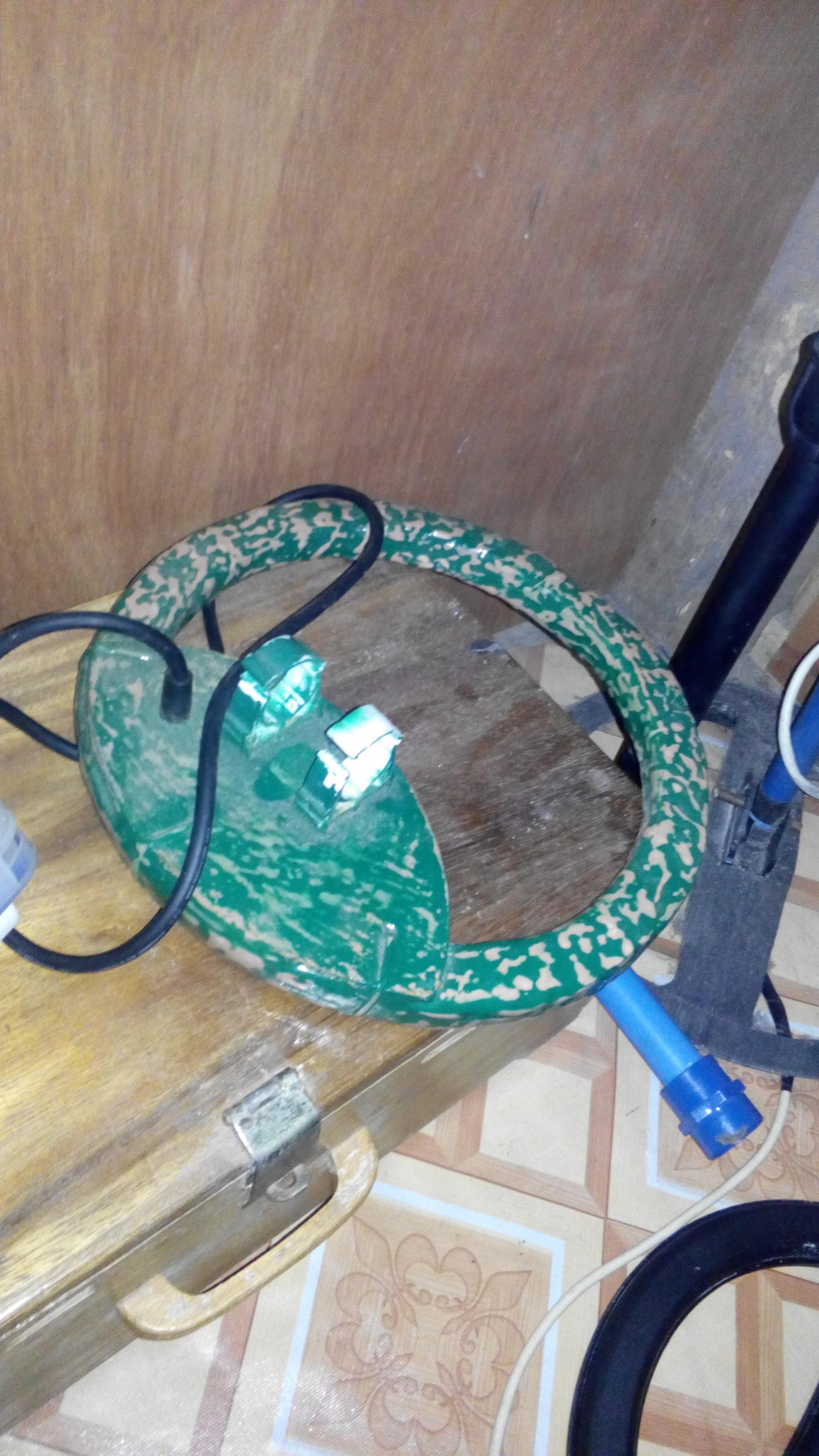

          • I been using 3dss coil for salt underwater hunting and found no problem.Click image for larger version
