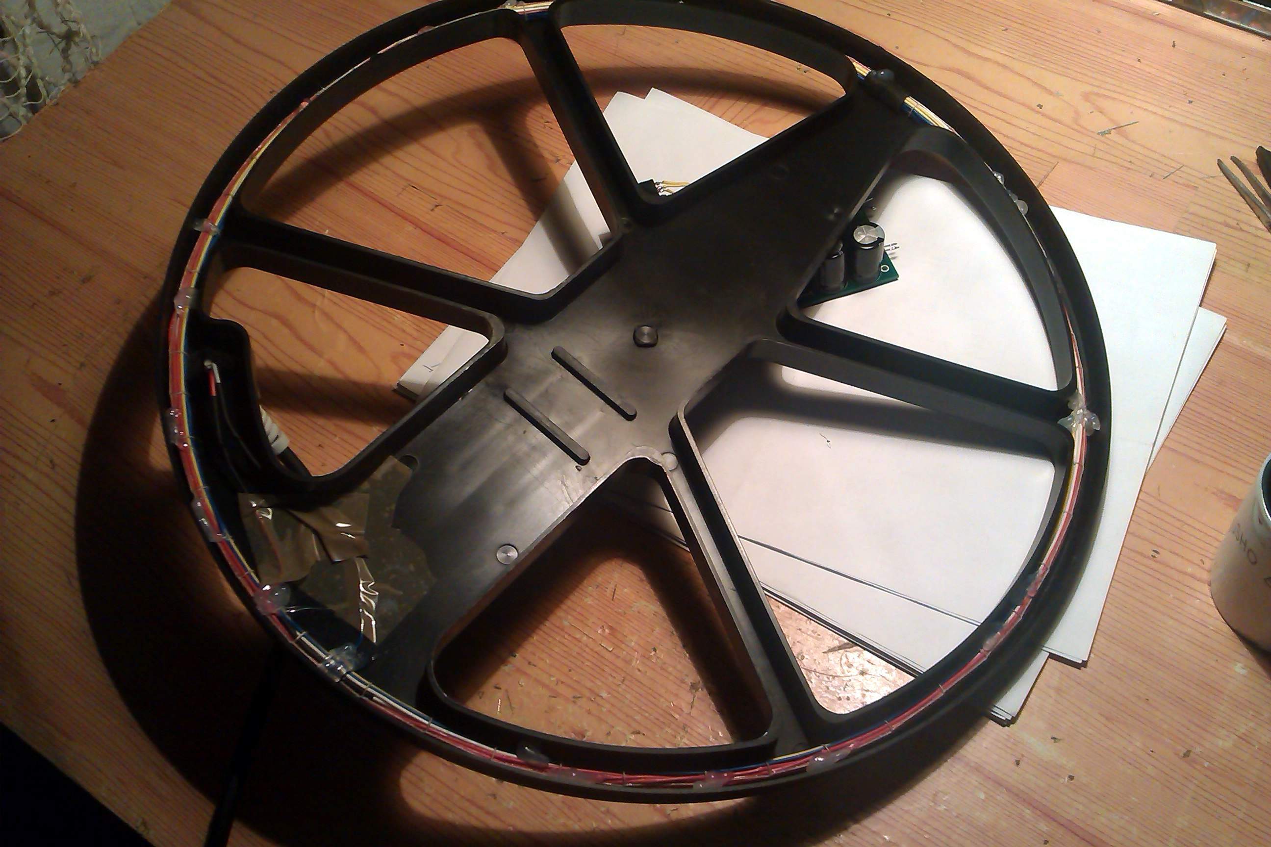

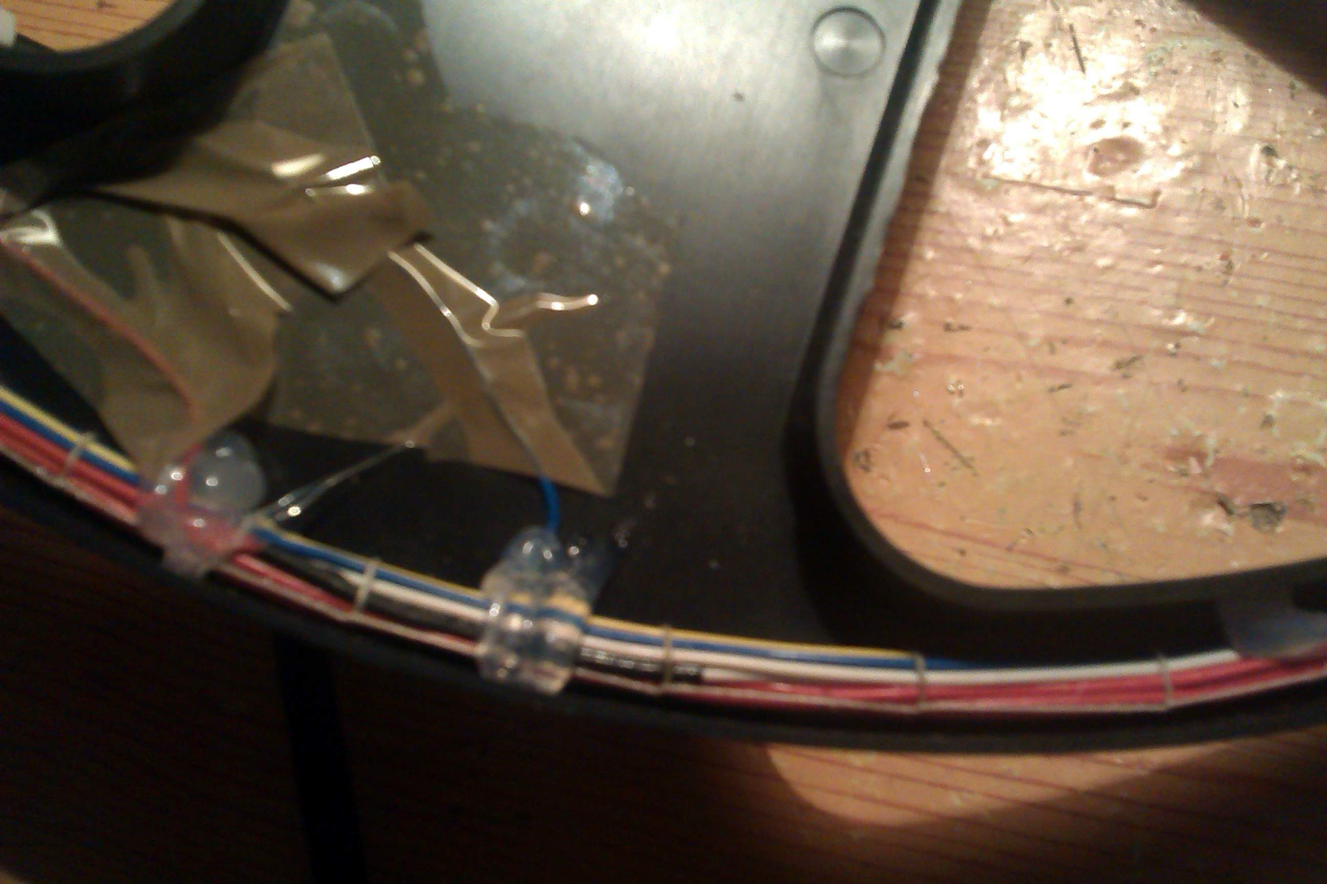

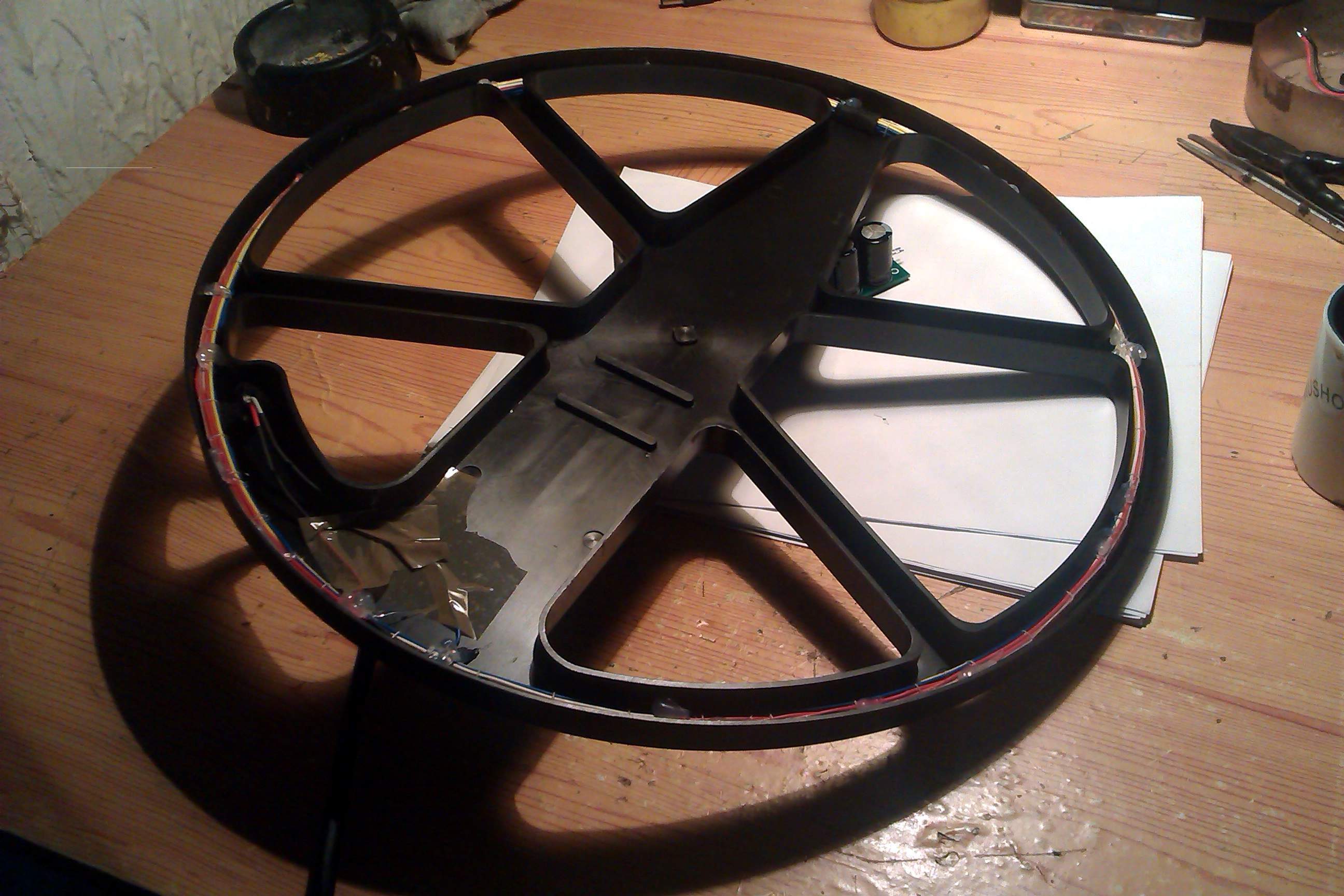

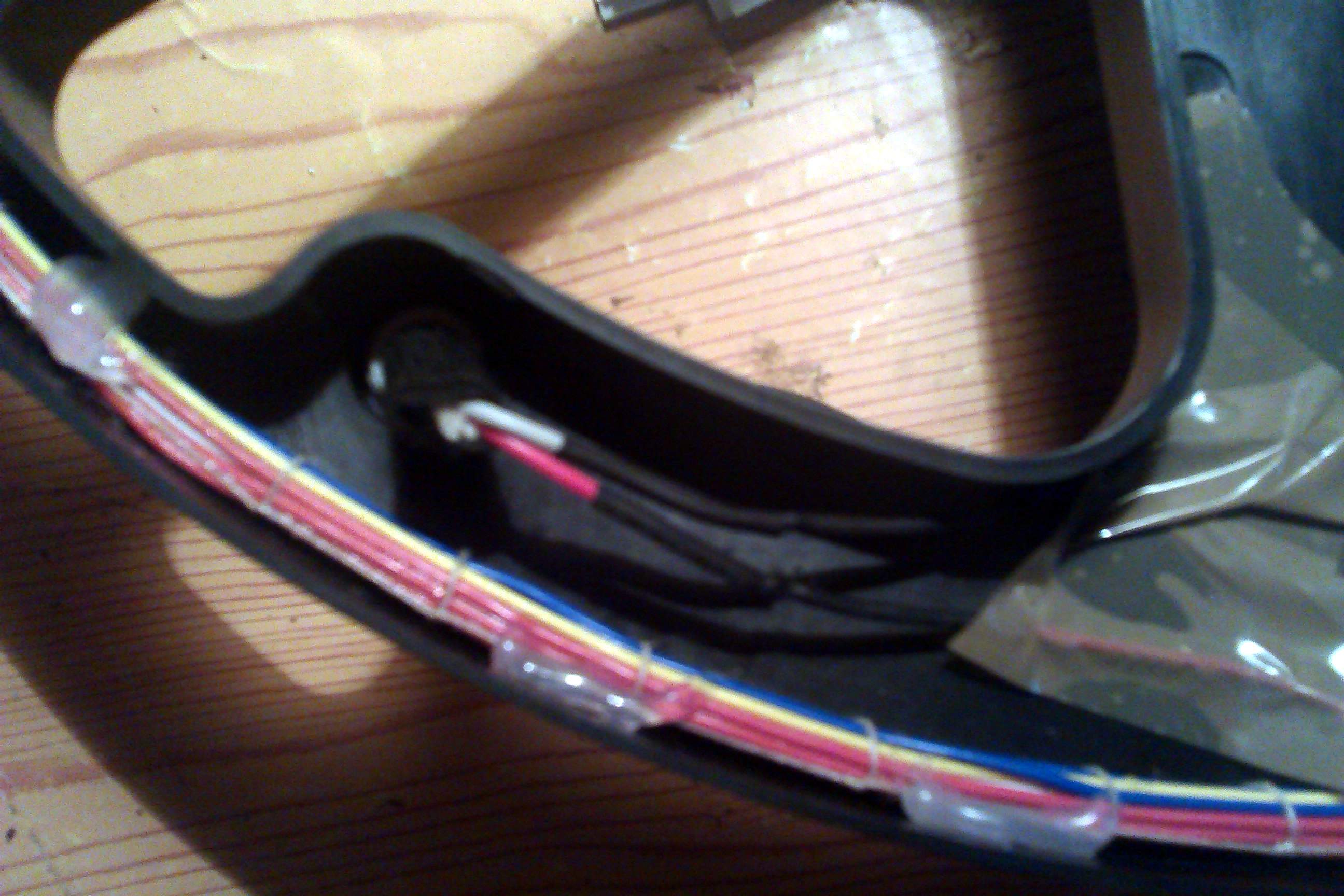

                      • I searched through my archives and luckily i founded few photos of coil before potting!
                        I have that habit of taking photos on each of my works, nice habit!
                        You'll notice different colors of wires; that's because i hadn't a wire in its entirety so i used pieces soldered together and isolated.
                        Those are the pieces of wire taken out from some random cable.
                        That's the best coil i made so far for this detector. Extra deep and pretty stable on ground.

                        • My 39cm coil which showed the best performances is ordinary coil, only made from pvc coated litz wire.
                          When you say litz wire, do you mean multi stranded tin plated copper wire,
                          or real litz wire which is multi stranded but each wire is insulated from each other ?
                              Hahaha... .also i do the same
                              • It is closest to first cable from the right side.
                                Come to think; it is exactly the one i used, the very same cable.
                                I had a piece of that cable so i stripped it and pulled out those pieces, soldered together and made coil from them.
                                Definitely the first one from the right side!
