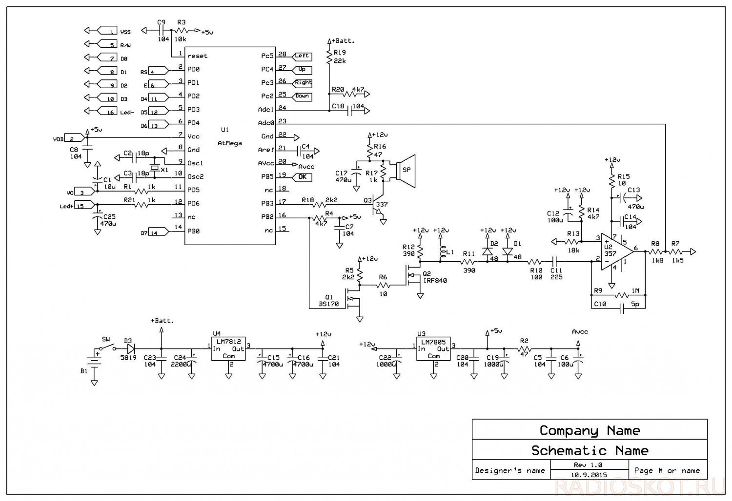

How about the increase in depth of detection with 25 cm dia coil about 400uH? Or can I increse detection depth by simply increasing the impedence of coil keeping diameter constant, valuable inputs are requested

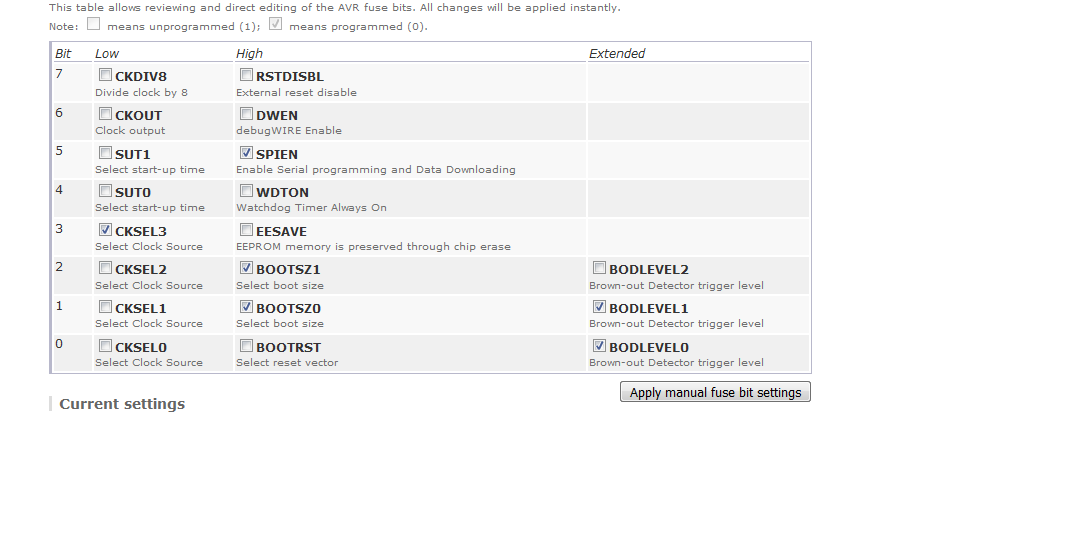

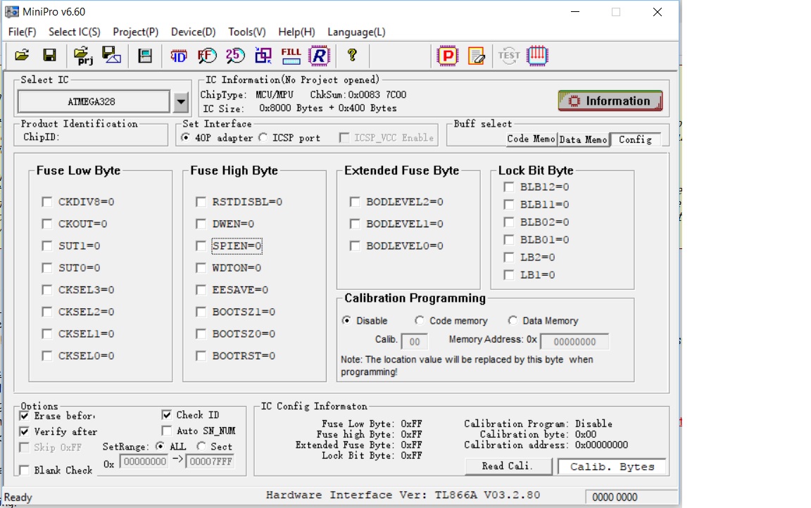

I wish to know the fuse bit settings for my Minipro Programmer Picture attached as I am a novice in case of Atmel controllers
TIA
On other thoughts Code authors should embed the fusebit settings in Hex code file itself. Like it can be done in Microchip PIC devices
