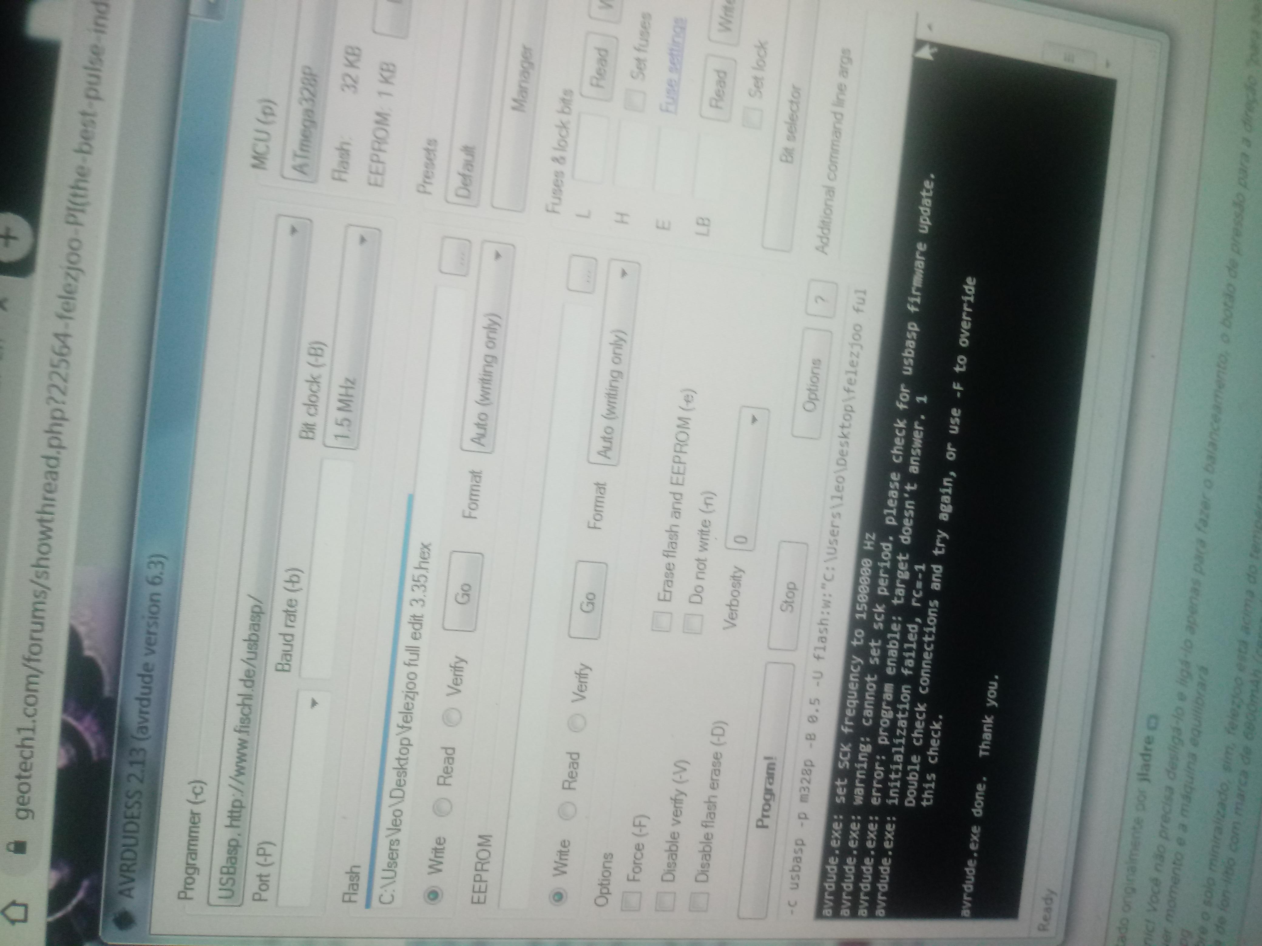

              • to be able to record correctly you have to install the AVR DUDE program correctly.
                • Originally posted by folharin View Post
                  ACHO QUE MEU USBASP ? FALSO CHIN?S

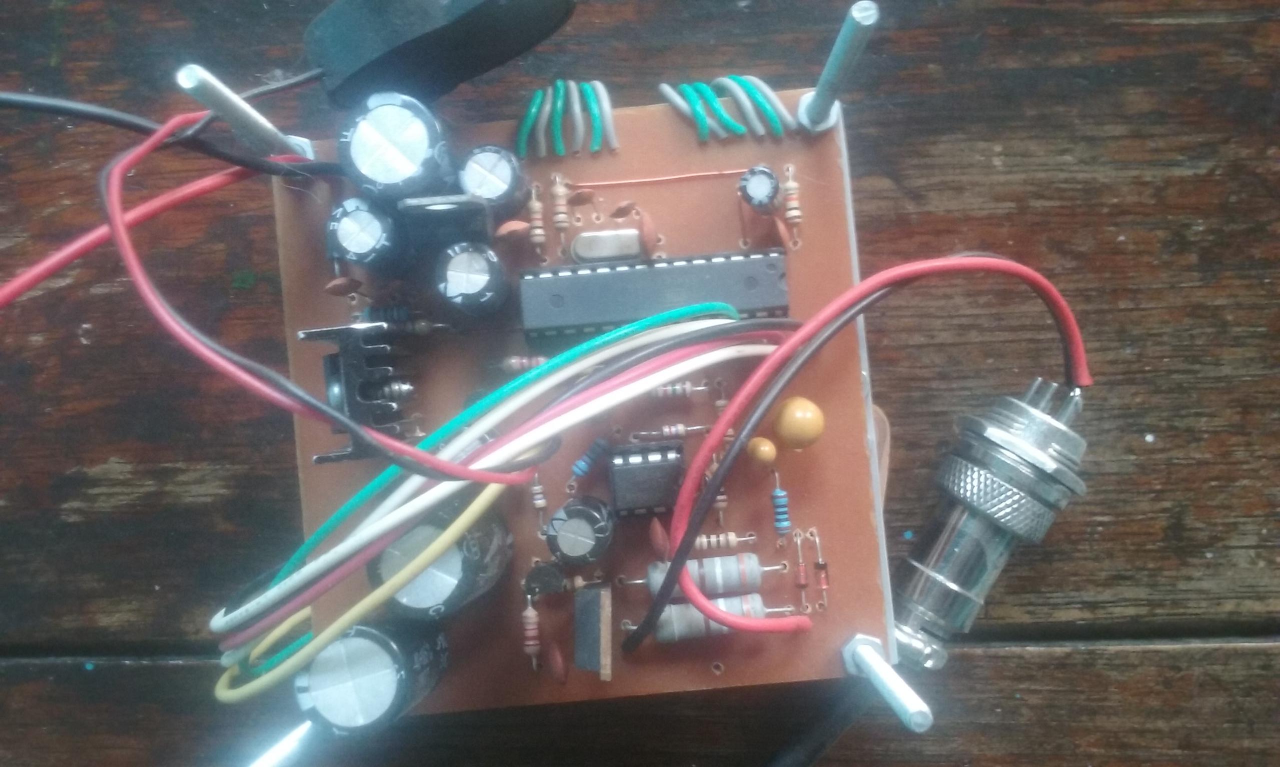

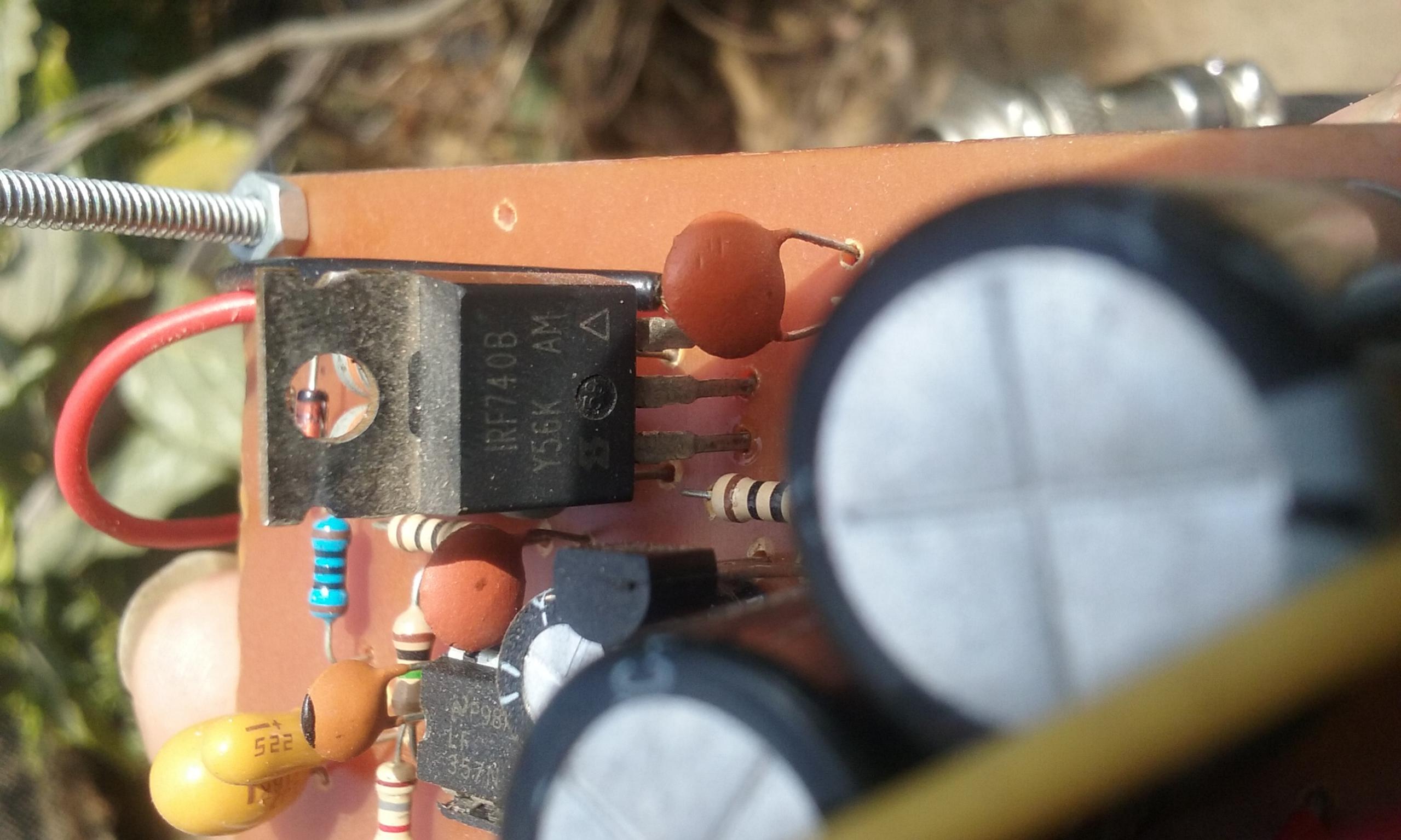

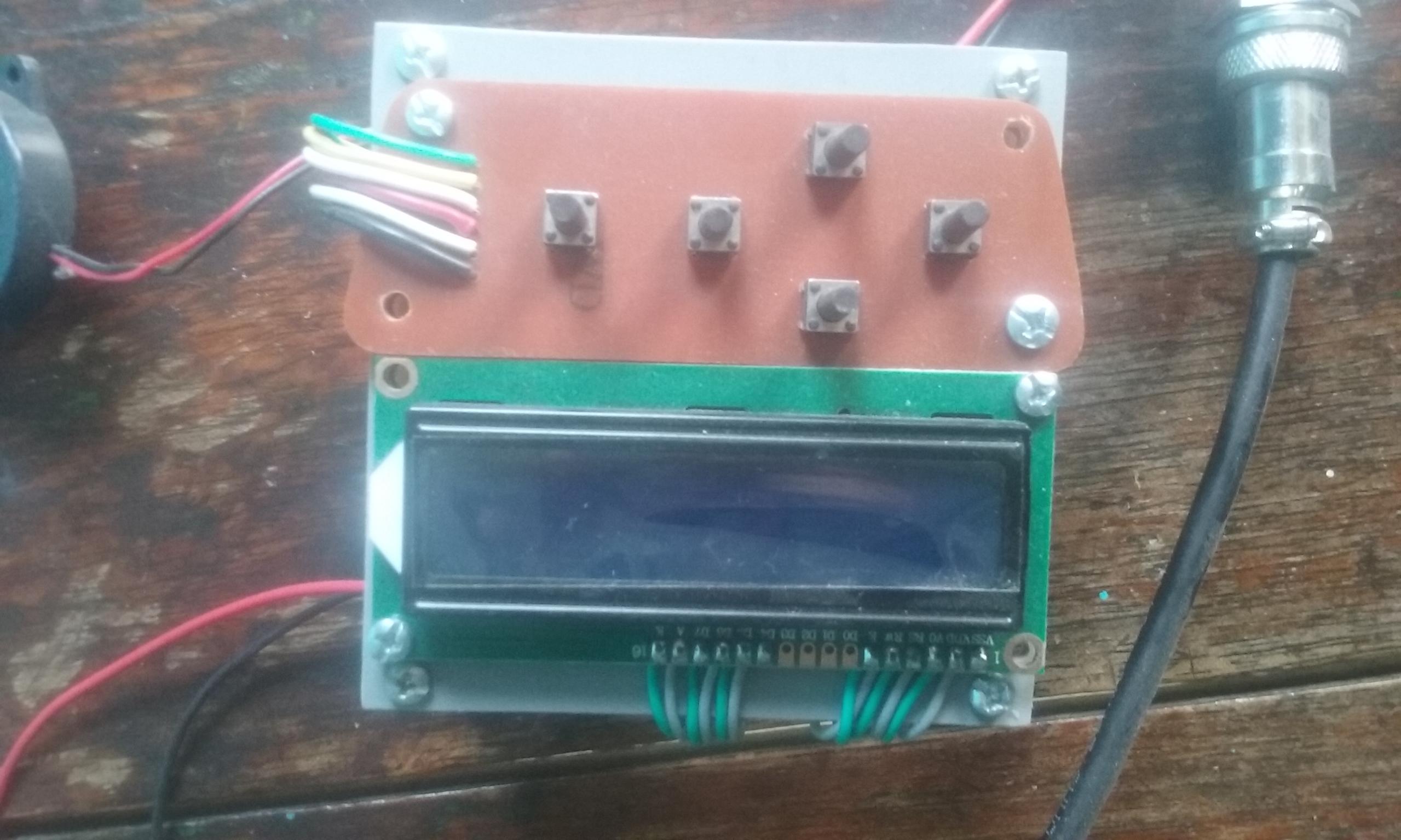

                  • I have not been able to get the original LF357N and I am testing it with a Chinese one and I had to use the IRF740 because the IRF840 burns out. I am still a beginner at this.

                          • I was in the middle of recording atmega and I think there was an error in the compilation.my doubt is if i can re-record in the same atmega or need to buy another new one?
                            Eu estava no meio da grava??o do atmega e acho que ocorreu um erro na compila??o
                            • i used usbasp and avr dudess
                              • hi folharin
                                you can re-programing the same atmega no need another
                                best regard
                                zakari
