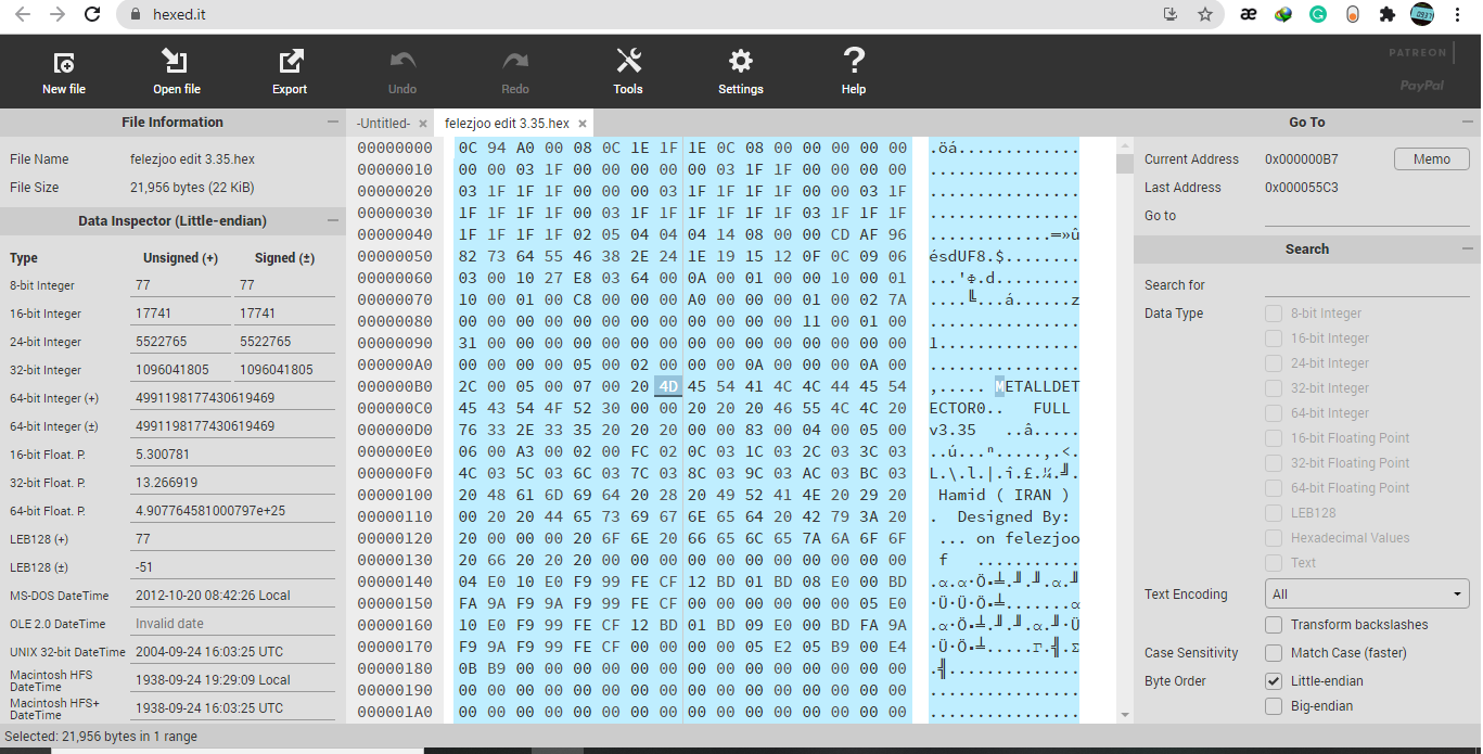

  • You don't want to modify the EEPROM contents, but the .hex file and after modification program it back to the controller.
    You can edit the hex file with a hex editor or online with eg https://hexed.it/
    Then find the string you want to modify and save as eg "felezjoo_mod.hex".

        • Originally posted by F117 View Post
          that is a better path to go
          now after trying a few times it seems like I can't find the right data format to apply changes and then the checksums
          this is the online editor:
Name:	hex editor.png
          does not seem right
          if this is the right format the 8th pocket should be checksum but it does not correspond to that
          I tried HxD editor and didn't even get the ascii on the right side

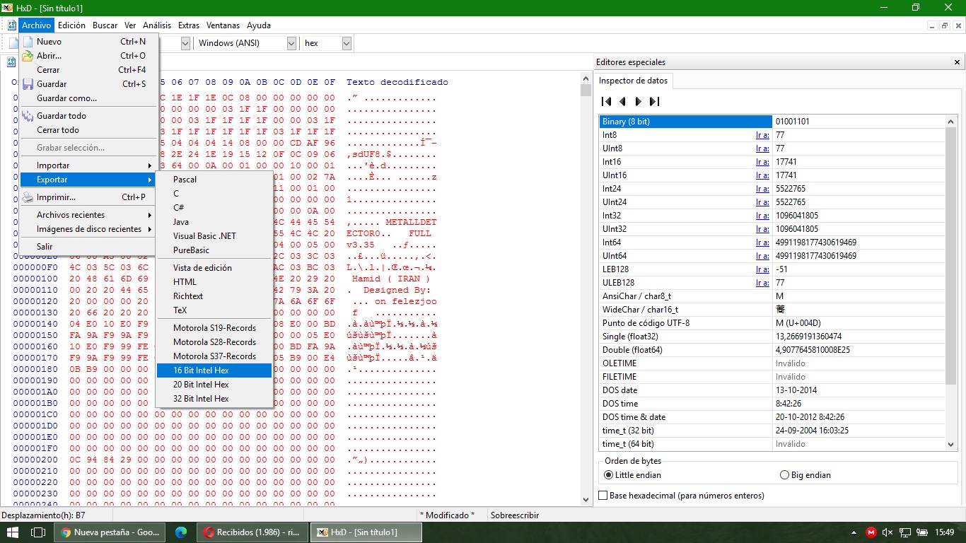

          • Originally posted by Mr.Jaick View Post
            [ATTACH]54835[/ATTACH]
            does not seem right
            I have tried but when I save or expert the edited hex I get the result of the saved .hex .. but the .hex is different from the original I don't know why ..

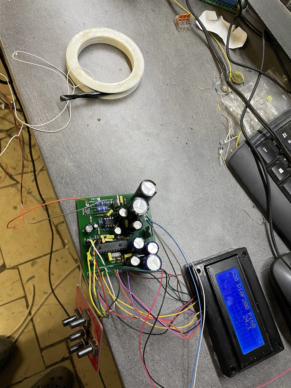

            • Hello
              I just finished the detector !
              I used Felezjoo PI TYPON 2.zip to make the pcb with jclpcb, I had 2 problems, on the pcb the resistance at the top is wrong, on the pcb it is indicated 10k but on the diagram it takes a 2.2k .
              i used a 2.2k it works.
              the second problem is the size of the capacitor, 4700, 2200 and 1000uf are too big for the pcb, maybe I will have used 35V instead of taking 50V ....
              I confirm that the "CA3130EZ" perfectly replaces the LF357
              I now have a small problem, the L7812CV is heating up, did you use a radiator on this regulator?
              the circuit is supplied with 24V
              at start-up: 45mA
              with coil: 130mA
              with the coil and in detection: 140-150mA
              with only 150mA the regulator is burning .....
              I am now looking for information on the manufacture of "spider coil"....
              do you have any links to advise me?
              with a coil of 7cm, 1ohms, 0.357mH I get A559 B814 C826
              a big thank you to the forum

              • Originally posted by windaube View Post
                Hello
                at start-up: 45mA
                with coil: 130mA
                [ATTACH]54980[/ATTACH]
                -voltage regulator must have heatsink
                -you have to use correct components, looking at your board i don’t see tantalum and ceramic capacitors.
                -current should be ok, depend on the coil and pulse width.
                -number A is high, maybe because of CA3130
                -24v i think is quite high
                • -coil must be spider for best result and correct ABC numbers
                  -have to use propper coaxial cable for coil connection
                  -use piezo speaker
                  • You can use TL061 instead ca3130 or ca3140
