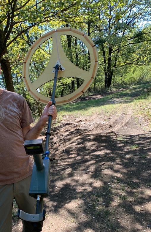

    Emersonpaz I have similar coil, Outside diameter 12cm, wire i think is 0.5mm. For better performance you have to make less groves in order that the wire don't cross so many times to keep the capacity low. Also need to use as a former material with good dielectric constant (teflon, xps). Good quality build of pcb, i like it!

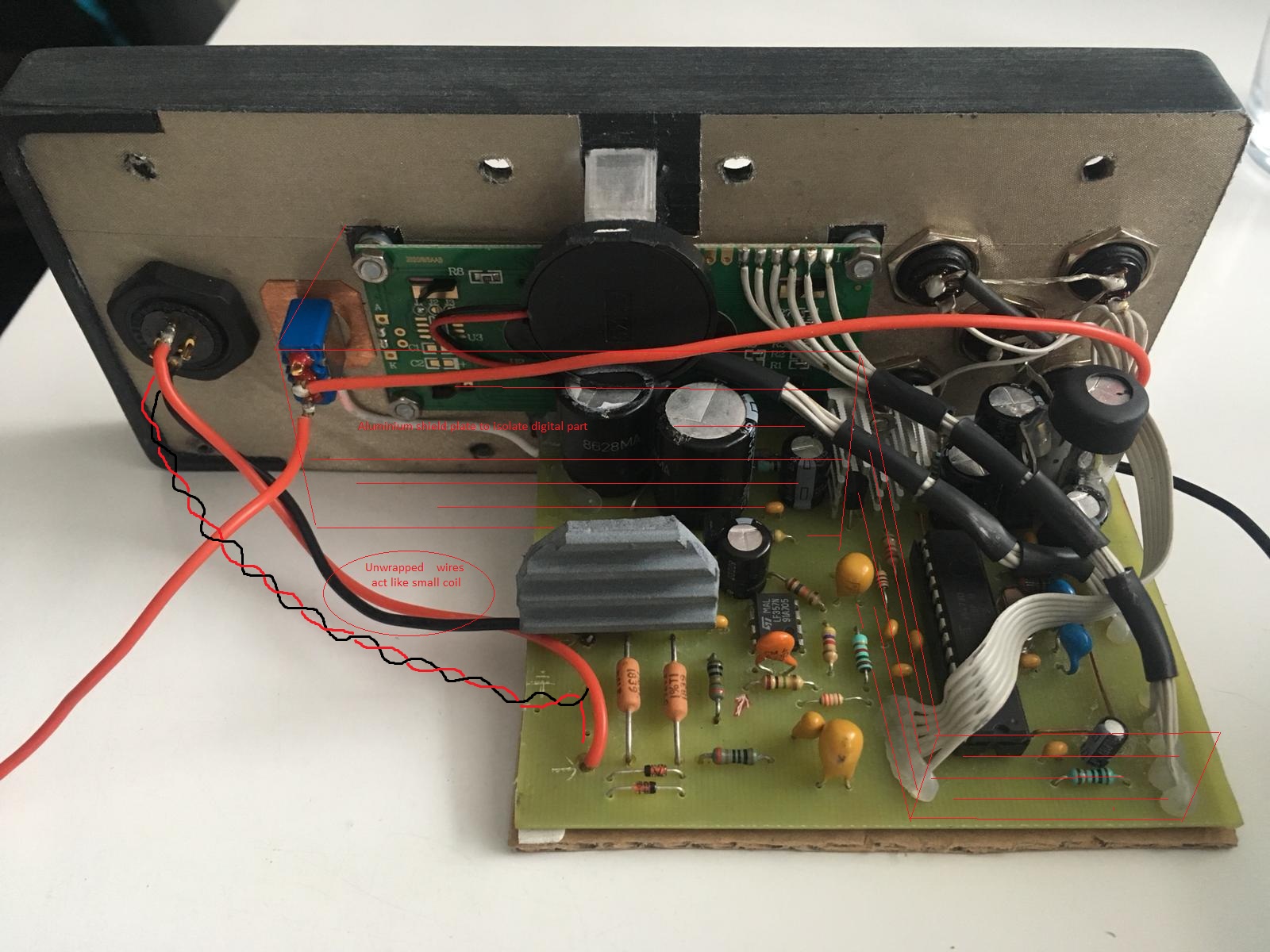

    Vadim18 this part i understand with the coil shield. But what about Pcb shield (aluminium or graphite paint for case/box)? PCB ground plane is 0V.

    My coil has an internal diameter of 12.5cm and an external diameter of 20cm I used 0.7mm wire. thanks for the tip

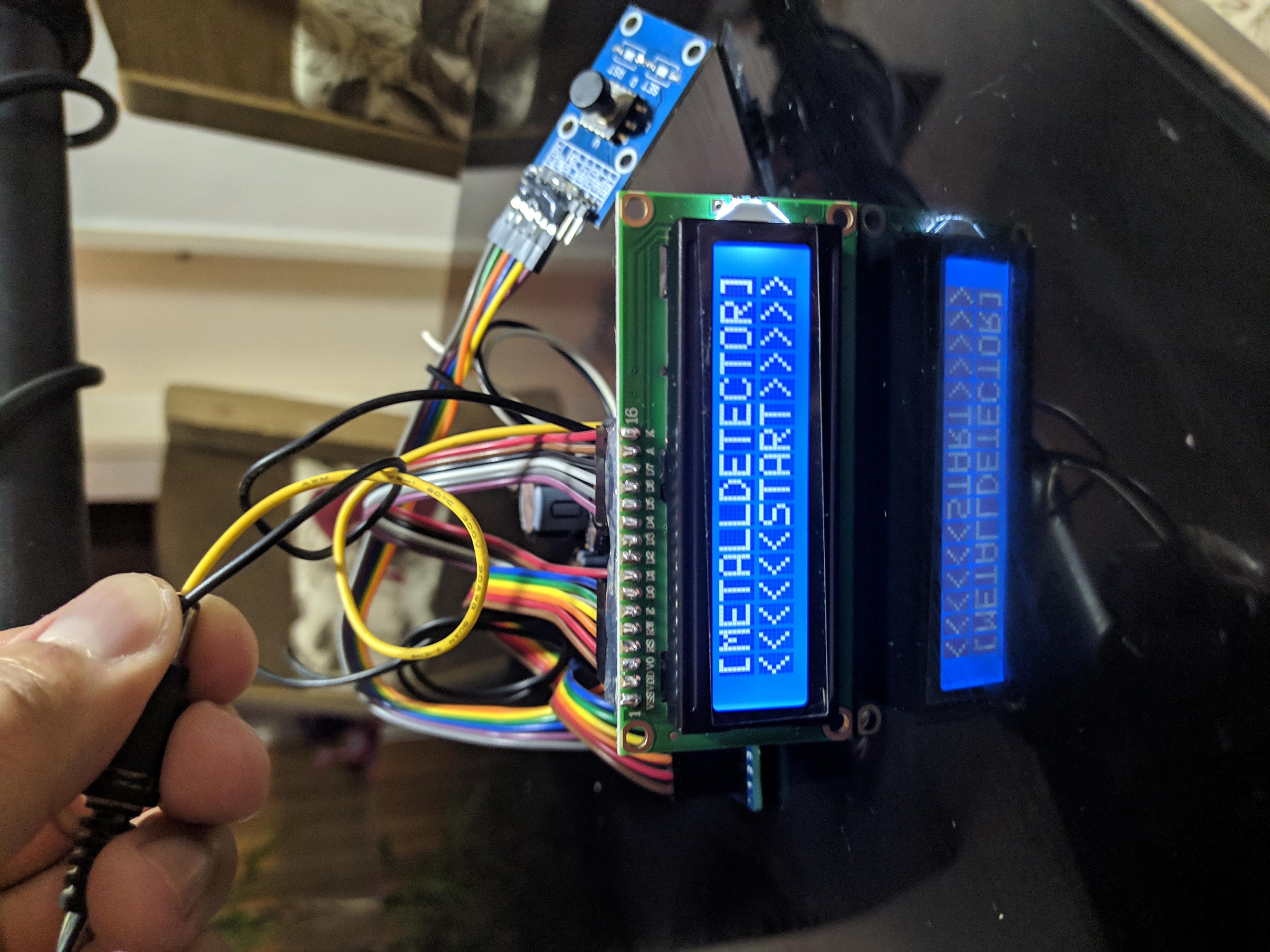

            i want to know how to change the words on the LCD
            • Originally posted by Mr.Jaick View Post
              i'm not looking for ABC adjusting info
              You will need the source code to do that properly, and the designer has no intention of releasing it.
              However, you may be able to hack the hex code, depending on what it is that you actually want to change.

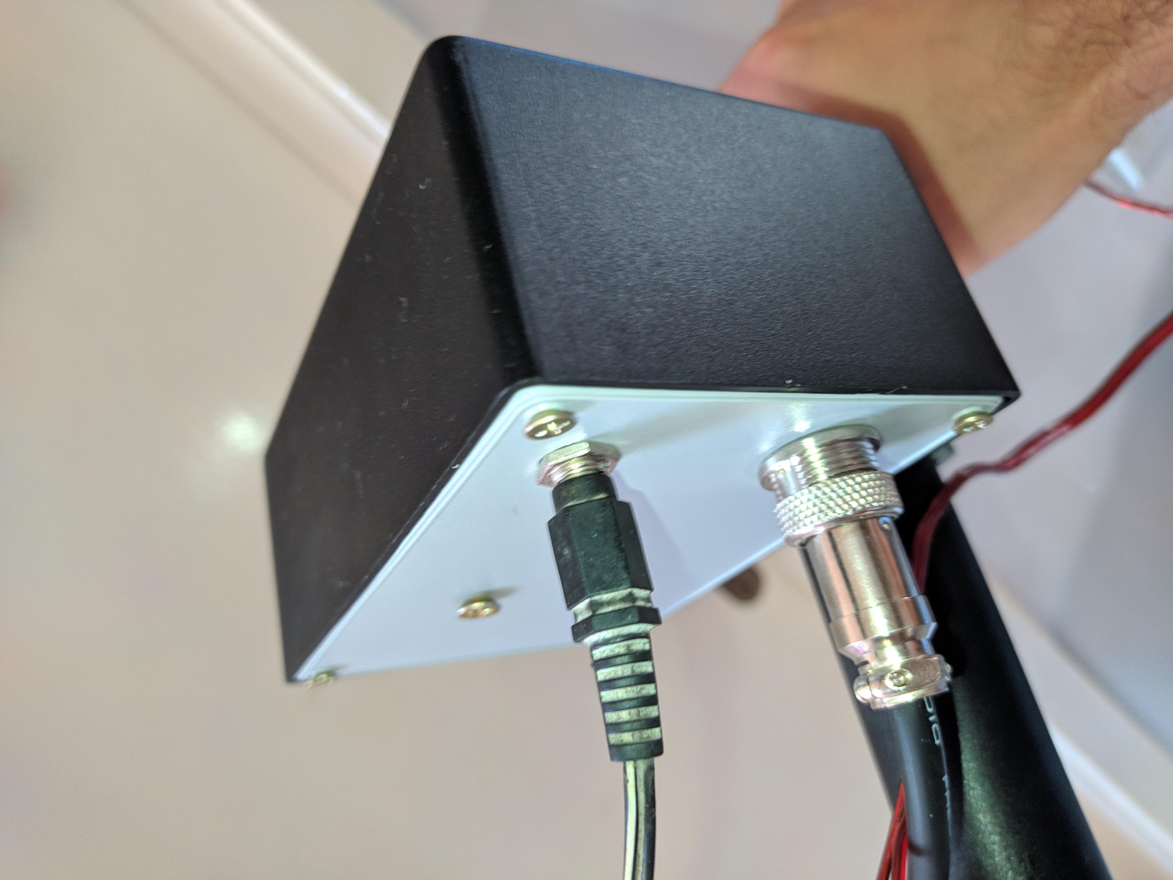

                I think graphite paint will be enough for box shielding, just to protect from any static. All radio junk will come from coil, in any case.
                You can isolate digital part from analog by aluminium shield, i drawed this shield in your photo.

                    Thanks for the tips! Will see if i have enough space for the analog/digital shield to fit inside box.

                      I just want to change the intro <<METALDETECTOR BLAH BLAH>>
                      i tried changing the ASCII code of the intro and save the HEX then upload that hex to the micro it didn't work
                      tried with TNM and Extreme Burner

                        maybe the programm dont let you to make changes, maybe it check the checksum. i plan to try it too. if i succeed , i will tell you.

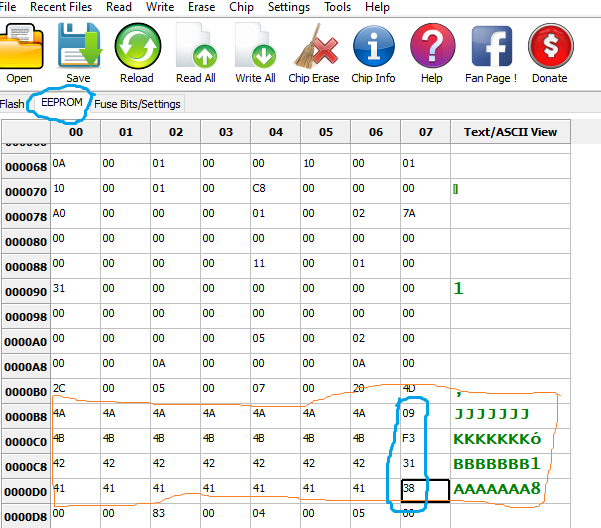

                          • I just want to change the intro <<METALDETECTOR BLAH BLAH>>
                            If you patch the hex file manually, you need to update the checksum on each modified line ( last byte of the line ):

                              • Originally posted by F117 View Post
                                https://en.wikipedia.org/wiki/Intel_HEX
                                I calculated the checksum in EEPROM section put it in the last data pocket but no results
Name:	hex trying.png
                                probably not the right place to do the checksum
                                any recommendations?
