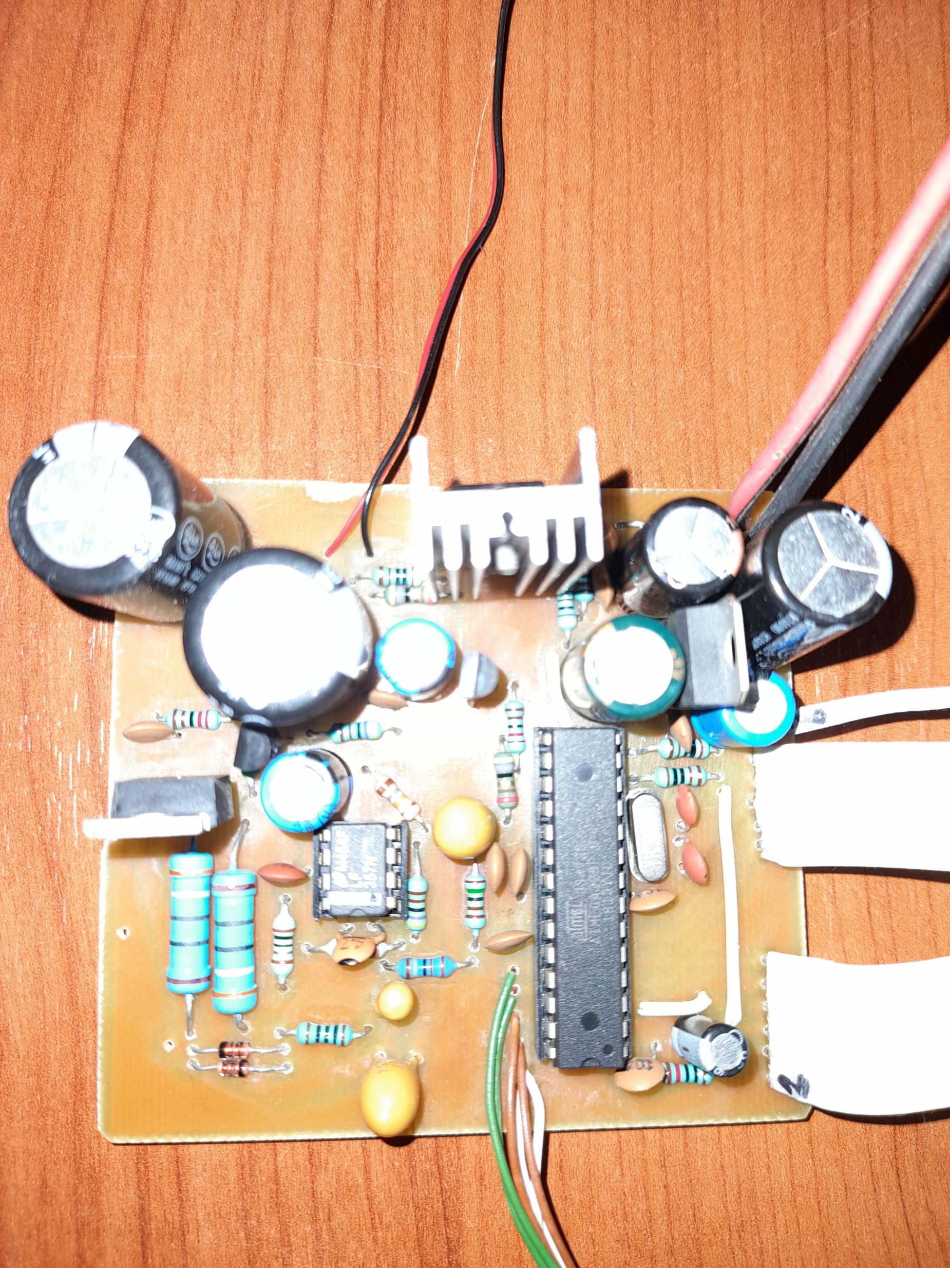

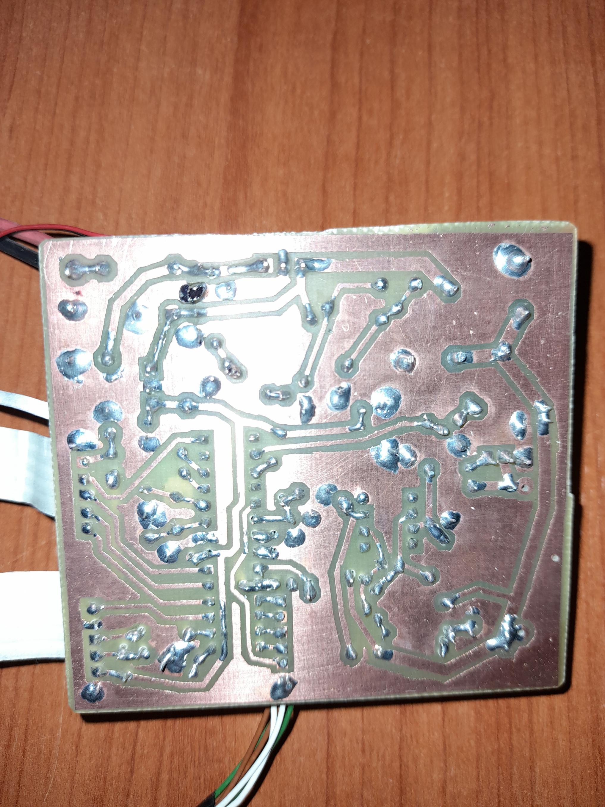

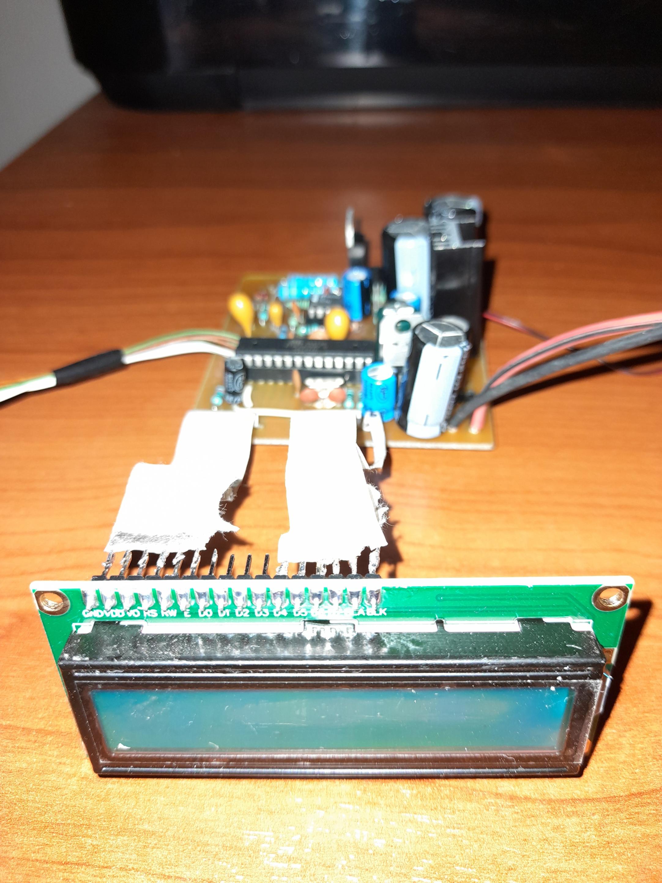

    • Hi i made felezjoo and i don't have letters on screen, when i power on i have sound and in off, were i should look for it, i post some photos , thanks.
      • felezjoo photo thanks if can help me
        • It is visible that there may be a short or dot in red or broken track in green check.
          • I check the green spot and the red is ok but still not work the lcd

              • Originally posted by manos View Post
                Any help for this ?
                Try to reprogram again the atmega 328. Verify connections to display and power supply for display. If i remember correctly first start after programming you need to push ok button when you see letters, if not, will disappear, too much/less contrast.
                • Comment
                  • Some nice ideas there.
                      thanks, i fixit the connections in display one pin have not good contact

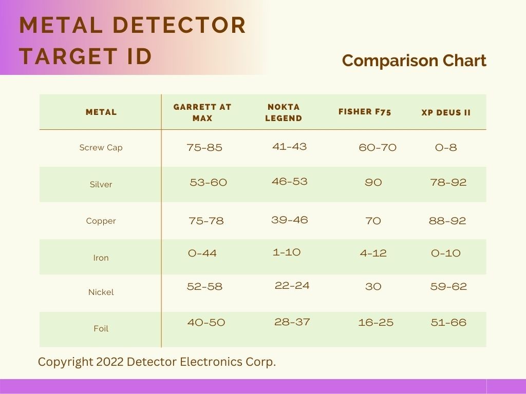

                      • Hi do you have the felezjoo target id list (number and metal )
                        like this but for felezjo. :
