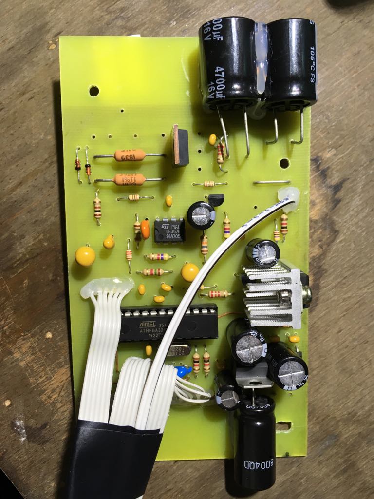

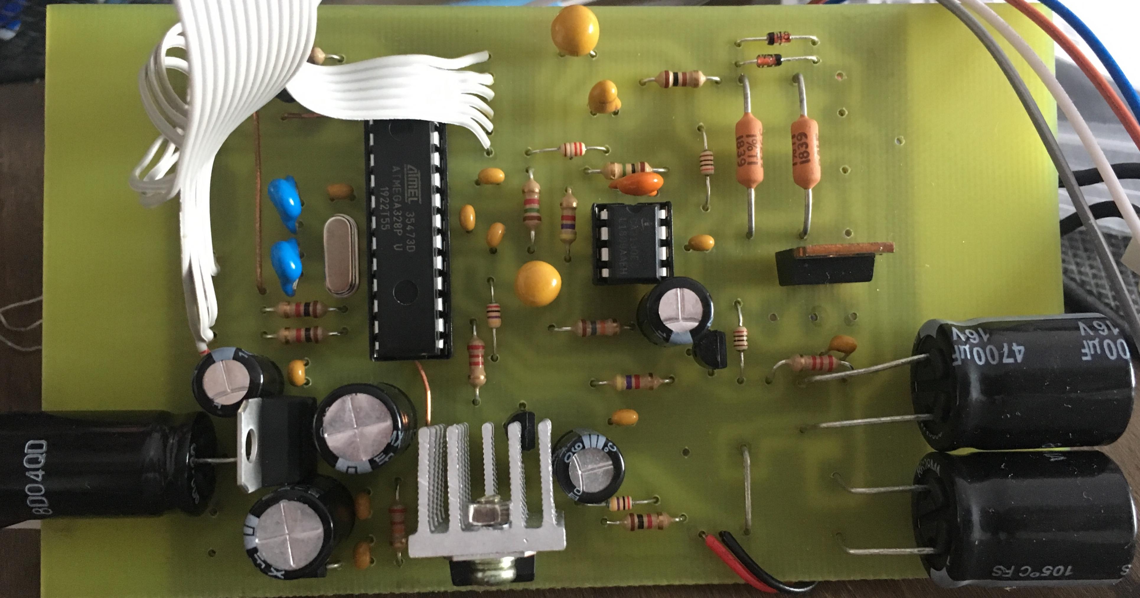

I searched 8 last pages.... nothink..... I want to see the complete pcb picture to see the parts and thier position.... maybe my problem could solve with a picture with full working pcb ...Originally posted by useus View PostI've already posted them, both the original lf357 as you see above and the complete pcb two or three pages back

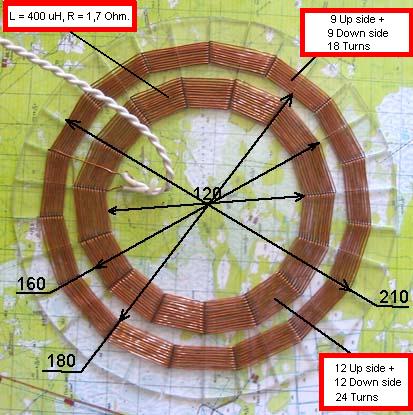

Originally posted by LUPENGR29` View PostMice Work!!! The Vinil coil very smart!!! Do you have calculator for this double spider coil? Resistance and Inductance of this?with coil cable 0.5mm ?
coil detailsAttached Files
- Likes 1
thanks, i have some friends that own laser cuter and cnc cutter. It is easy to make like that. From what i remember i use 0.6mm copper wire, 350uH 1ohm. I don’t use calculator.Originally posted by LUPENGR29` View PostMice Work!!! The Vinil coil very smart!!! Do you have calculator for this double spider coil? Resistance and Inductance of this?with coil cable 0.5mm ?

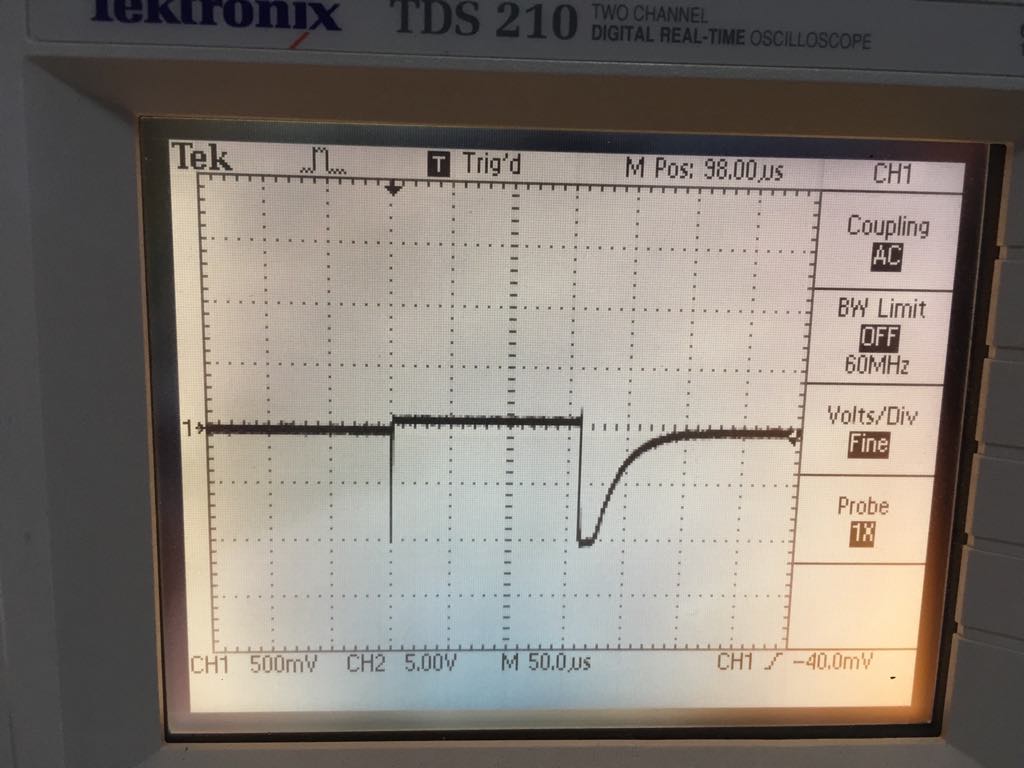

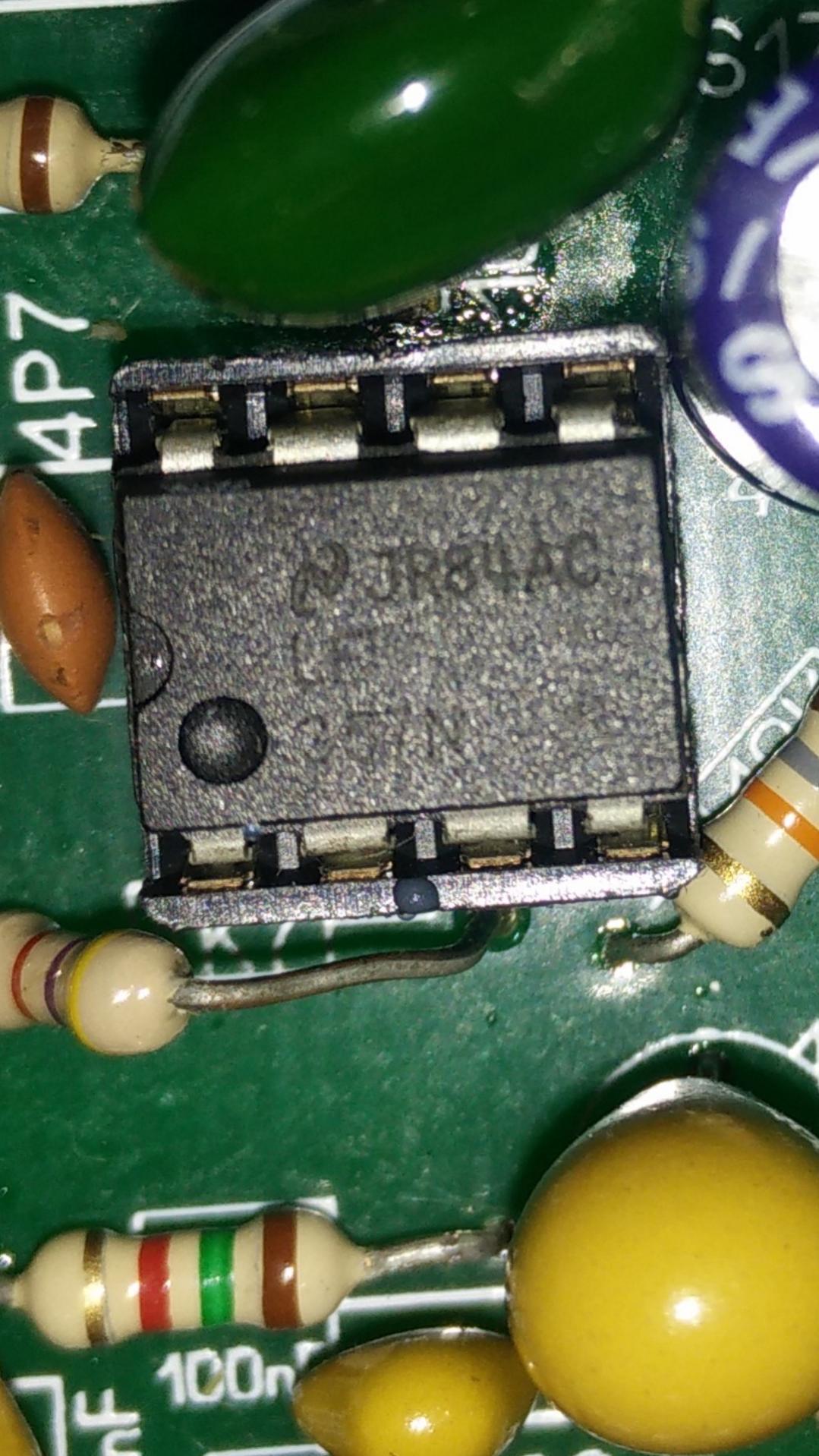

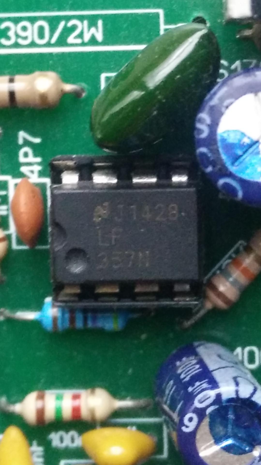

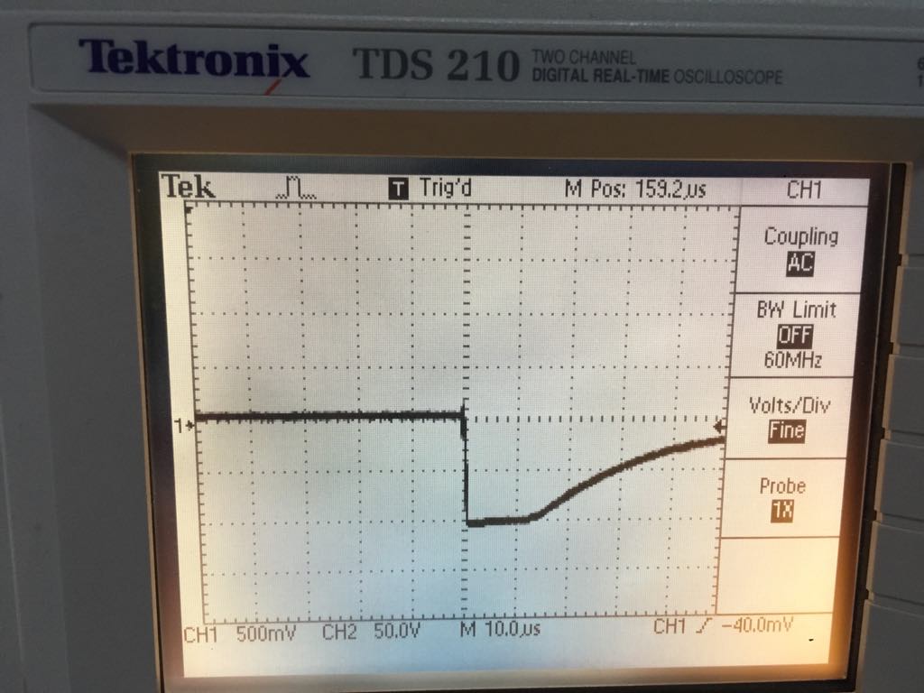

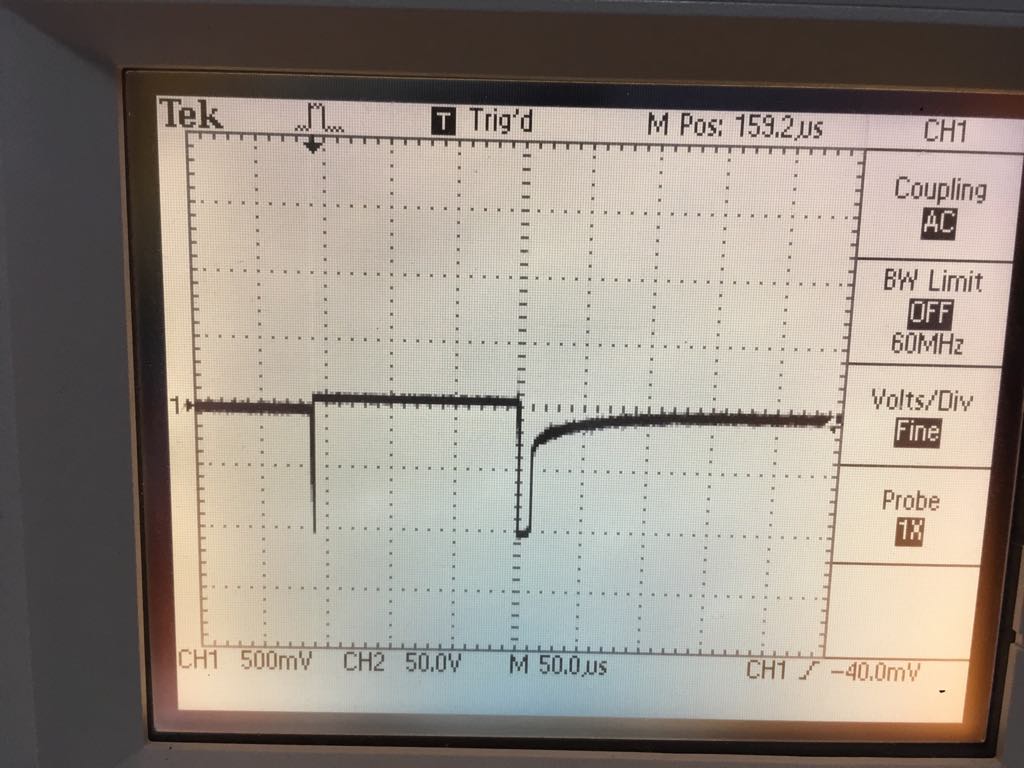

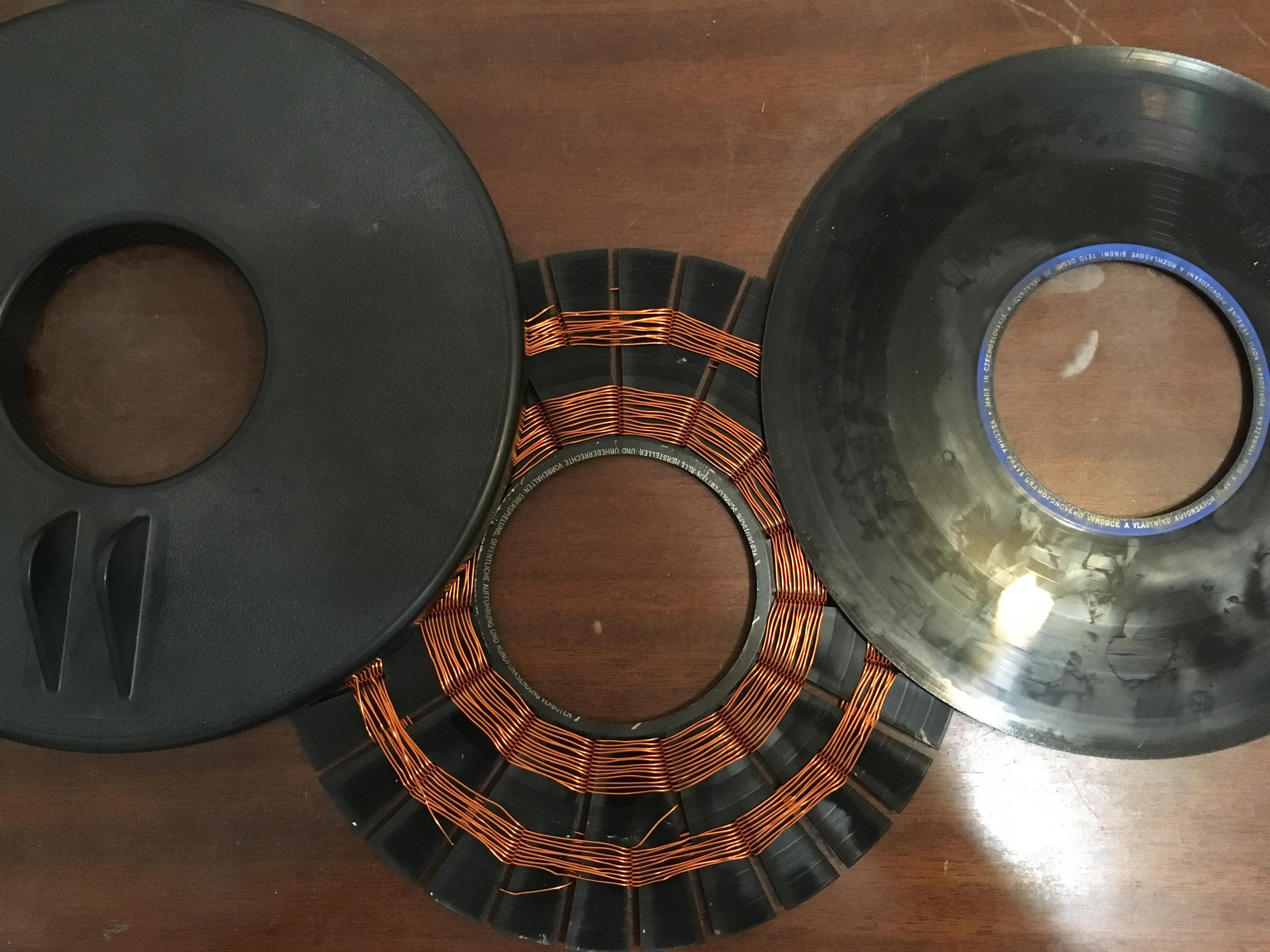

I finally received original lf357 from germany(ebay). tested with two coils.
Coil1: spider coil, 0.6mm copper bare wire, no shield, A301 B691 C785 1.6 ohm, 374uH, rg58 c/u

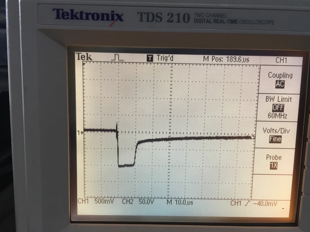

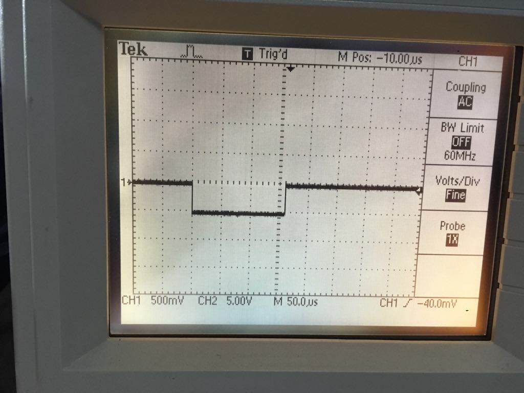

bs170 gate:
Coil2: bundle stranded insulated pvc tined copper, conductive cloth shield, A597 B733 C771 1.6ohm 361uH, rg58 c/u
I was expecting better performance for coil nr1, maybe i did something wrong... In both cases air detection depth for one coin is not bigger than 20cm.
What do you think about this measurements?
pw recomndation is 150-200... i will play more with the settings to see if it will improve performance.Originally posted by bernte_one View Postpulse width 156?s? not a bit long for coin shooting?
i thing shorter pulse with higher freq give better results
coil inductivity close 300?H
