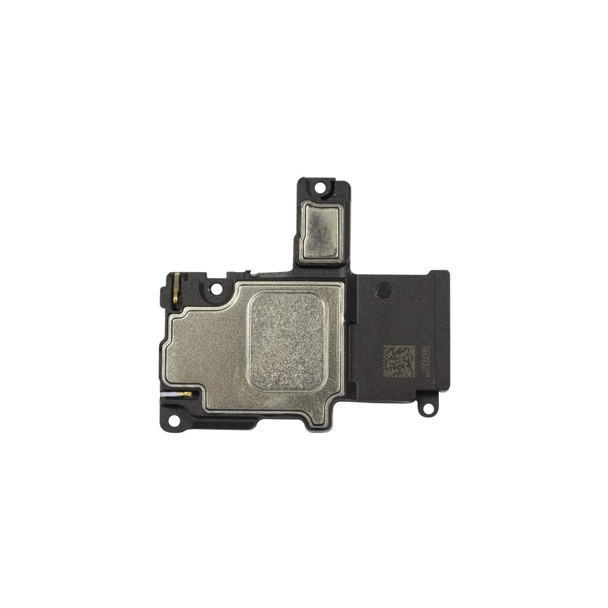

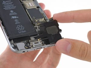

    Audio you hear on video is coming from speaker taken from faulty ... iPhone6 !!!!
    It is small and narrow, closed in tiny box. Very easy to include on front panel, very loud tough!

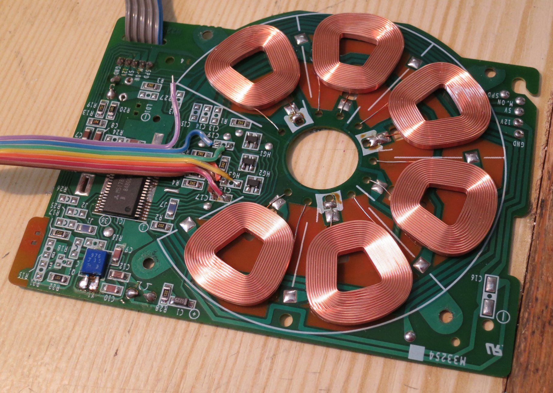

              It is coil taken from old and obsolete 5.25" floppy disk, there are 6 such coils in one floppy disk.
              At the beginning i took that coil only for skim tests, it is small and not occupying much of space on the table, nor is sensitive much on interferences from a workshop.
              But later it turns to be very interesting and useful coil.
              Whatever you do; make sure to shorten pins/legs at fet IRF840 as much as you can. Solder it close to pcb.
              Because, when its pins are long; it is "irradiating" like a radio station and forms unwanted "field" around, causing lot of interferences and instability.
              That's why would be good to draw quite new pcb with fet in horizontal position and with very short leads and traces.

                • And this is iphone6 speaker:
