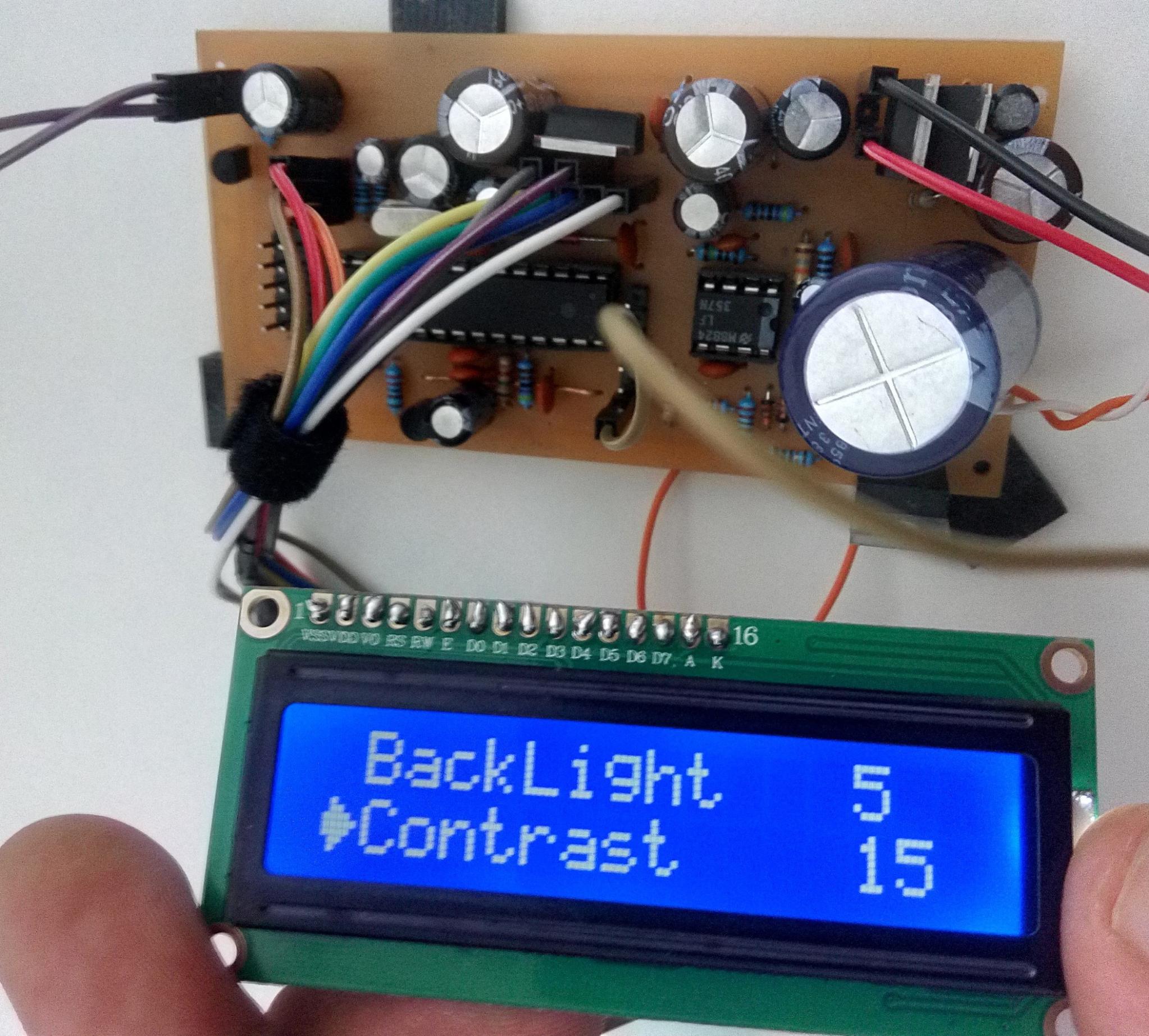

                • Hi
                  felezjoo is my first md
                  any one can tell me why felezjoo metal detector coil get hum sound?
                  is it normal?
                  • Tanu do you hear the hum only when you move the coil above ground or does it make the hum even in the air?
                    Have you washed your PCB with Isopropyl Alcohol?
                    • I think he’s talking about hum from the coil not from speaker. Yes is normal, if you change the frequency you will notice hum change in pitch, is the resonance of the coil.

                        • Originally posted by MDfanatic View Post
                          Thank u
                          No i can't find 99% isopropyl in this time.but i cleaned using 70% IPA
                            Thanks for your reply
                            Yes, that's what I meant. For the first time I don't hear that sound.
                            After many days I heard that sound for the first time​
                            • Another problem with the metal detector
                              When I touch the battery terminal, circuit or black area it becomes unstable. The lcd shows a negative number and when I remove my hand from the md. md gives the target sound & show in lcd

                              • After replacing the coil cable with a higher quality one rg58 (I already had rg58 but poor quality, now it also detects gold) a strange thing happens: by rolling the cable on the metal detector stick the signal is unstable, it sounds alone and reaches around +25 / - 25 depending on the situation, instead leaving the cable free, only fixed in the upper part, does not cause balancing problems. The abc values ​​are almost perfect. I have been using the metal detector for about 2 years. Latest firmware with counter.
