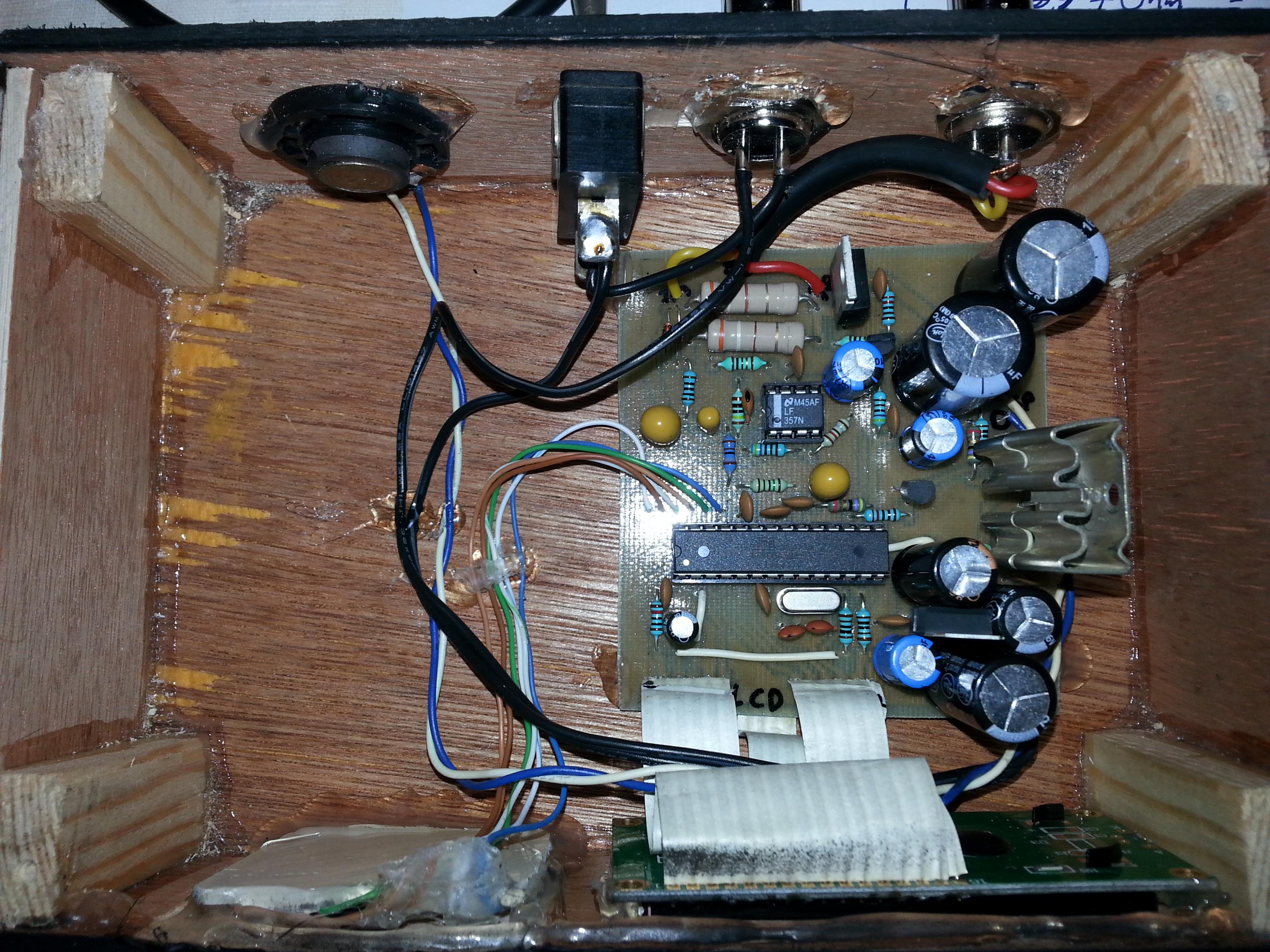

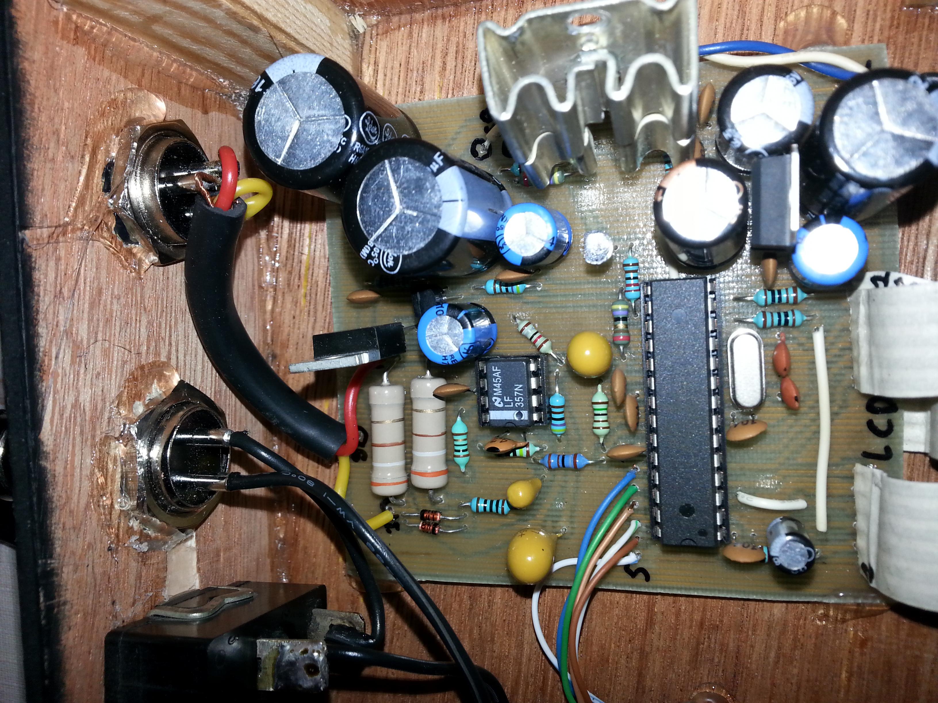

    • i change the ic , i change frequency and all settings many test i have made. I start beleve i have problem in the pcb.

ID:	352327 Ihave change ic with other two i have change frequency and all settings many test allways coil error. if you can see anything in photo tell me what to do?
        • Hi
          BS 170;lf357;tantalum capasitör check it.

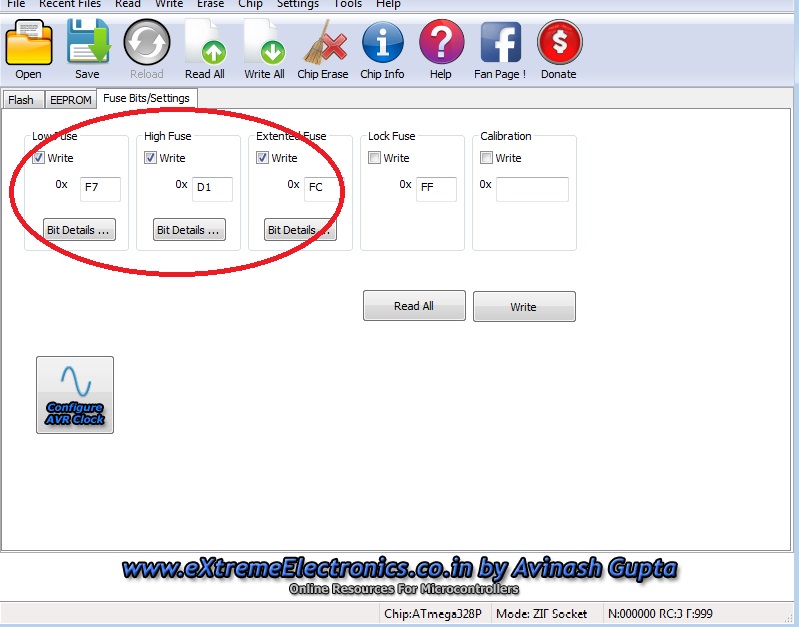

          • hex version ?fuse settings are fine?
            • Change the bs170 most error coil from bs170 its a week peice and can burn when soldering many time i have this problem
              • ok thanks i look and i will tell you hex is 3.35 and like the photo ok in hex Click image for larger version

                • hi today i change bs170,lf357n,atmega, bc337 but i have the same: error coil
                  i thinking to change cable of felezjoo to coil is a cable of microfon low lose wih shield
                  • hi, what volt i must have in the out for the coil
                    • 12Volt in the coil and 9.50on the op amp
                      • In the coil I have 0v the lf I have change
                        • I had the same problem of coil error ... change components, I made the plate again, in the end I left this project, of all those that I have done, this is the only one that did not work for me because of the error problem coil

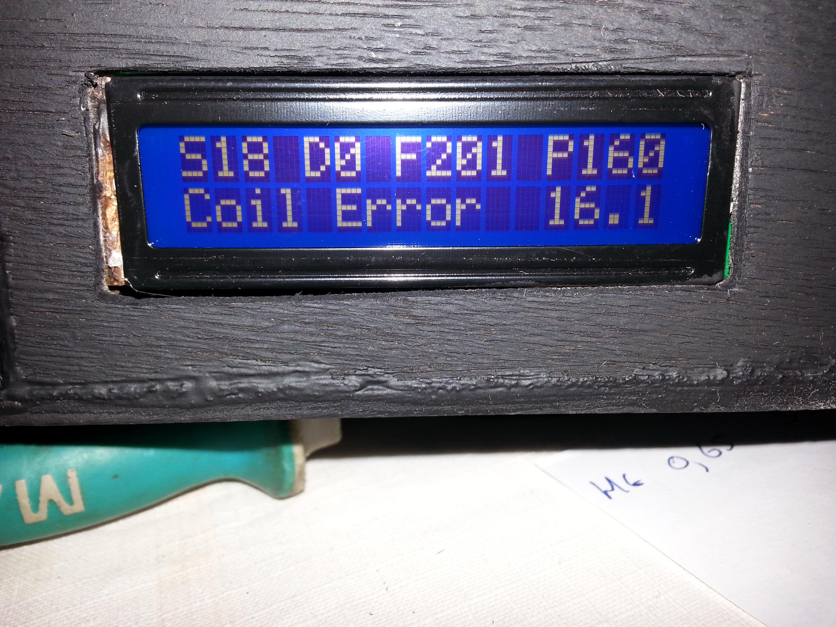

                          • 1-detach the coil
                            2-felezjo pi run
                            3-sens 7 do
                            4-felez close open
                            5-coil after plug
                            6-What are the consequences?
                            • Nothing errors coil but rhe sens is always 17 I cant change it in lcd says S17 I have hex 3.35
                              • Originally posted by Kostasp View Post
                                Put a picture of the board up and down
