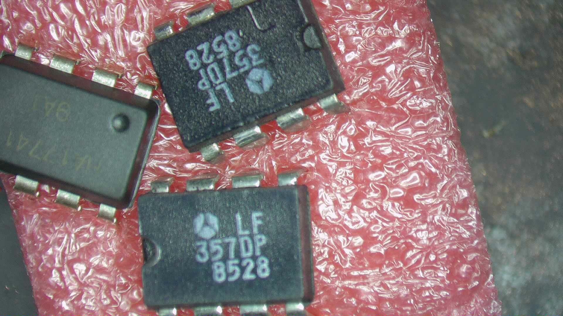

          Hi guys can you tell me if this ic is good for project i mean copy or original
          • Originally posted by salim View Post
            [ATTACH]55024[/ATTACH]
            Cannot tell just by looking at it, you will have to test it, too many fakes.
              I agree, need to test.
              They do not look good. The Motorola logo seems a bit blurred which can be an indicator of a fake.
              Also, the surface on the chips looks rough.

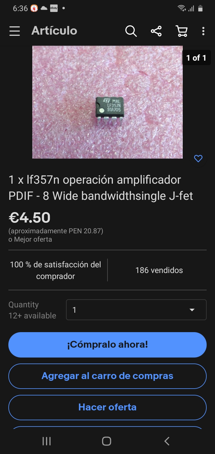

                  • I want to buy this LF357 but it does not ship to Latin America, will there be a friend who can send it to me?Click image for larger version

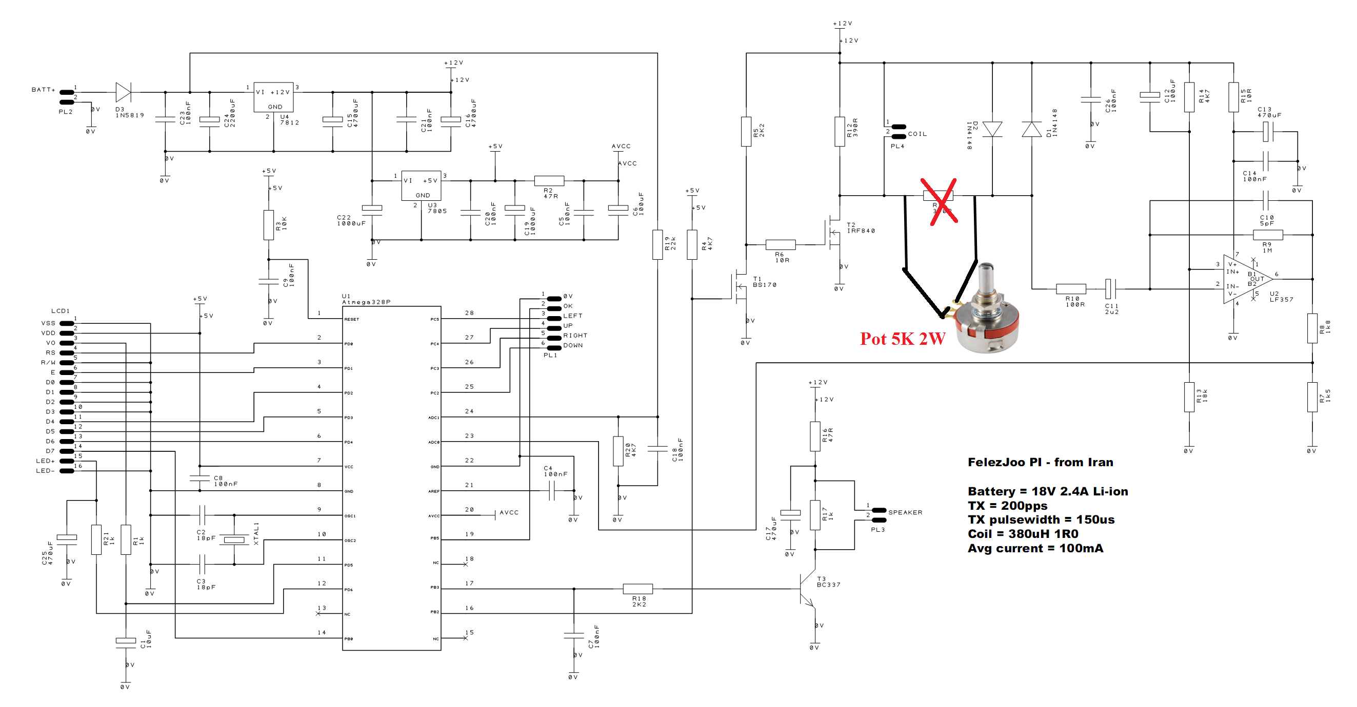

                    • my answer is to help those who are building! the integrated lf 357 is false in all countries. to adjust the circuit to simply be operational it is necessary to put a 5k potentiometer in place of the resistor
                      • Originally posted by folharin View Post
                        Which resistor?
                        • [QUOTE = LUPENGR29`; 287988] ?Qu? resistencia? [/ QUOTE]
                          It refers to this.Click image for larger version
Name:	POT PARA EL SENSOR.png
                          • alternatively you can replace R10 with a potentiometer or trimmer
                            • exactly..I got success in the detector by replacing this resistor mentioned r10 by a potentiometer!
