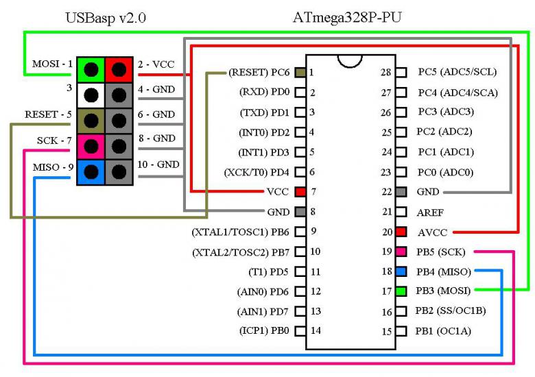

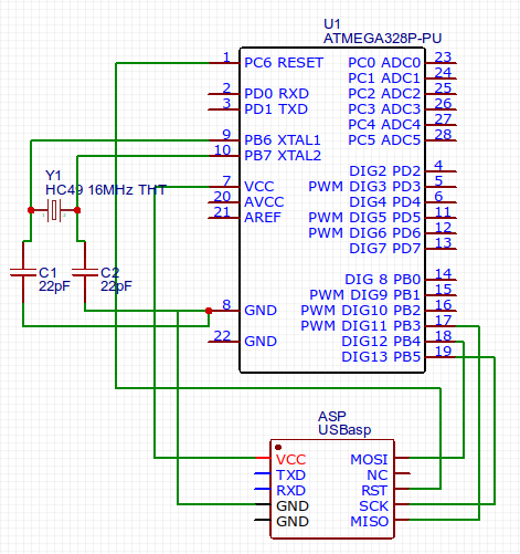

                    • Check this video to write the chip. i wrote it directly on the felezjoo pcb because it needs to have the xtal and 2xcapacitors and power, or you can do a separate setup:

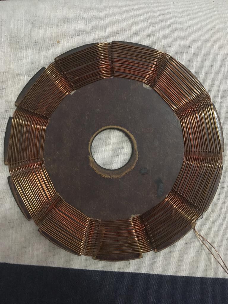

                      today i made 12cm coil:
Name:	WhatsApp Image 2020-02-15 at 21.46.34.jpeg
