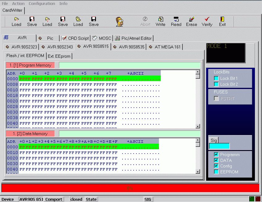

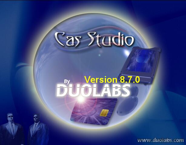

        • The problems here reminds me on my older satellite days with cards and firmware updating etc.
          Homebrewed chipcards as the magic key to all the beautiful sexy girls etc. A fascinating time!
          Usually there would be no chip-writing problems if everyone uses
          the same programmer and computer-system!
          In earlier times those programmers worked via the good old RS232 serial-port.
          Now with USB you have to check out which programmer with what firmware works on what Windows version etc.
          If someone buys such programmable uC chips he should be shure to have already or get directly a working
          programmer for it. And those who sell these ICs usually know which programmer works and with what OS-version.

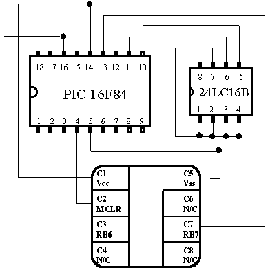

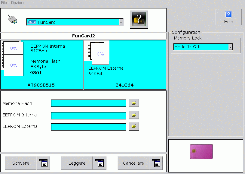

          I'm using some of the following stuff (see pix) but this is for chipcards.
          The CAS Studio (made in Italy) also can flash common access-modules for sat-receivers but no socket chips.
          It works with USB like all the newer programmers.
          Of course its also possible to buy some smartcard-slot (if the atmega328 is available on smartcard)
          and solder the usually 7-8 used pins onto the metal detectors PCB. This way the chip is
          updatable super easy and fast without opening the detector. By an usual smartcards-programmer.
          And the MD only works if the keycard is inserted, which could be pretty cool to show around.
          If the connection: computer <--> programmer is up, the writing itself should be super simple:
          Selecting first the hex file for the internal flash with eeprom memory and if available the hex or bin for the
          ext. eeprom and writing it with fuses not set (or as described in the manual) so the chip remains reflashable.

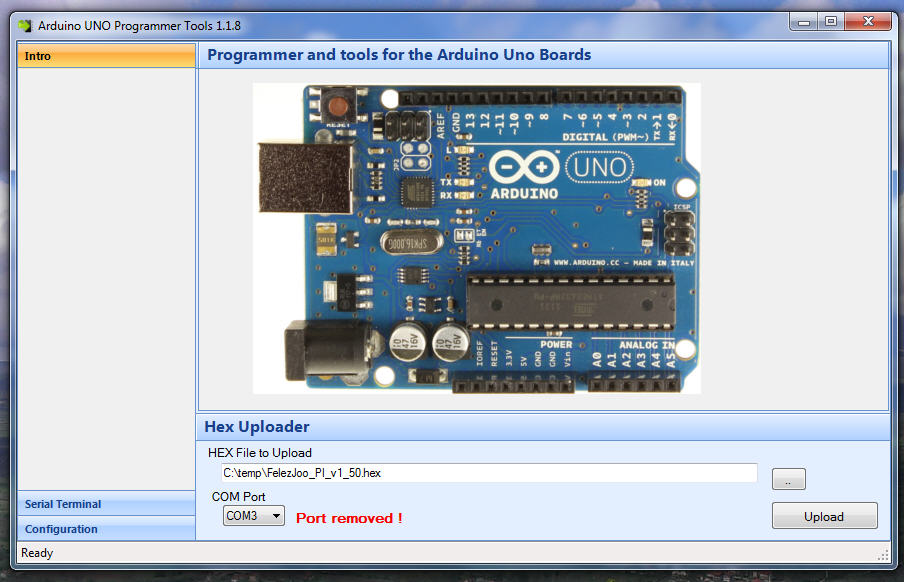

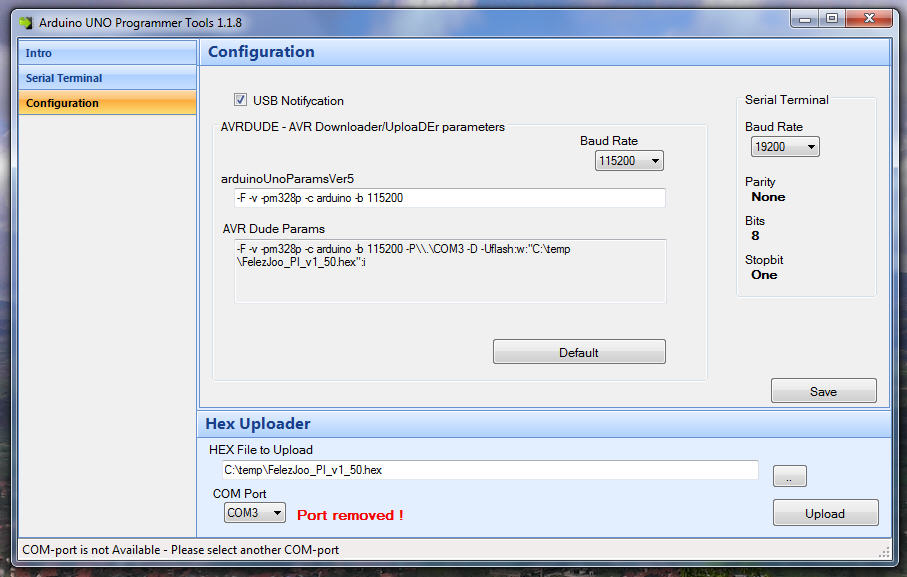

              • IDE is here: https://www.arduino.cc/en/Main/Software
                Simplest way i can figure is using "Arduino UNO Programmer Tools".
                Obtain Arduino UNO or clone and burn hex file using it and "Arduino UNO Programmer Tools" software.
                So far i tested it with original UNO Rev3, NANO, MINI Pro and some cheap UNO clone made in China.
                It's a simple GUI for avrdude. Everything is easier with it.
                Tracing it's actions you can also learn a lot on avrdude params and how to invoke them manually later, if you want that.

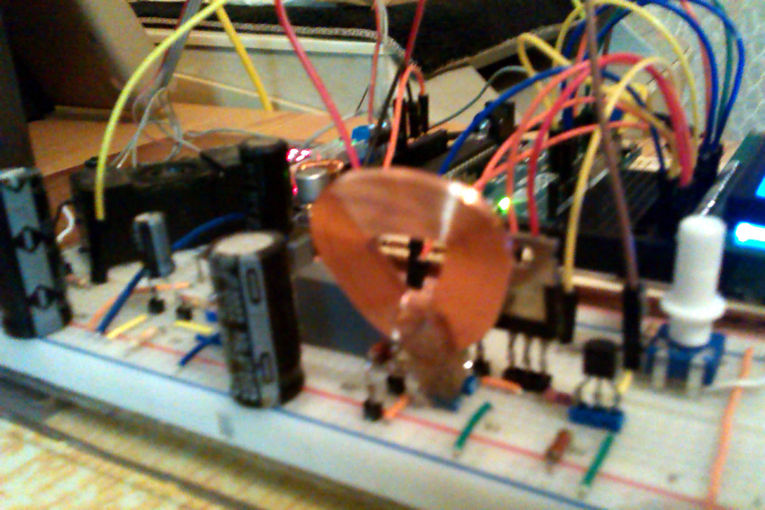

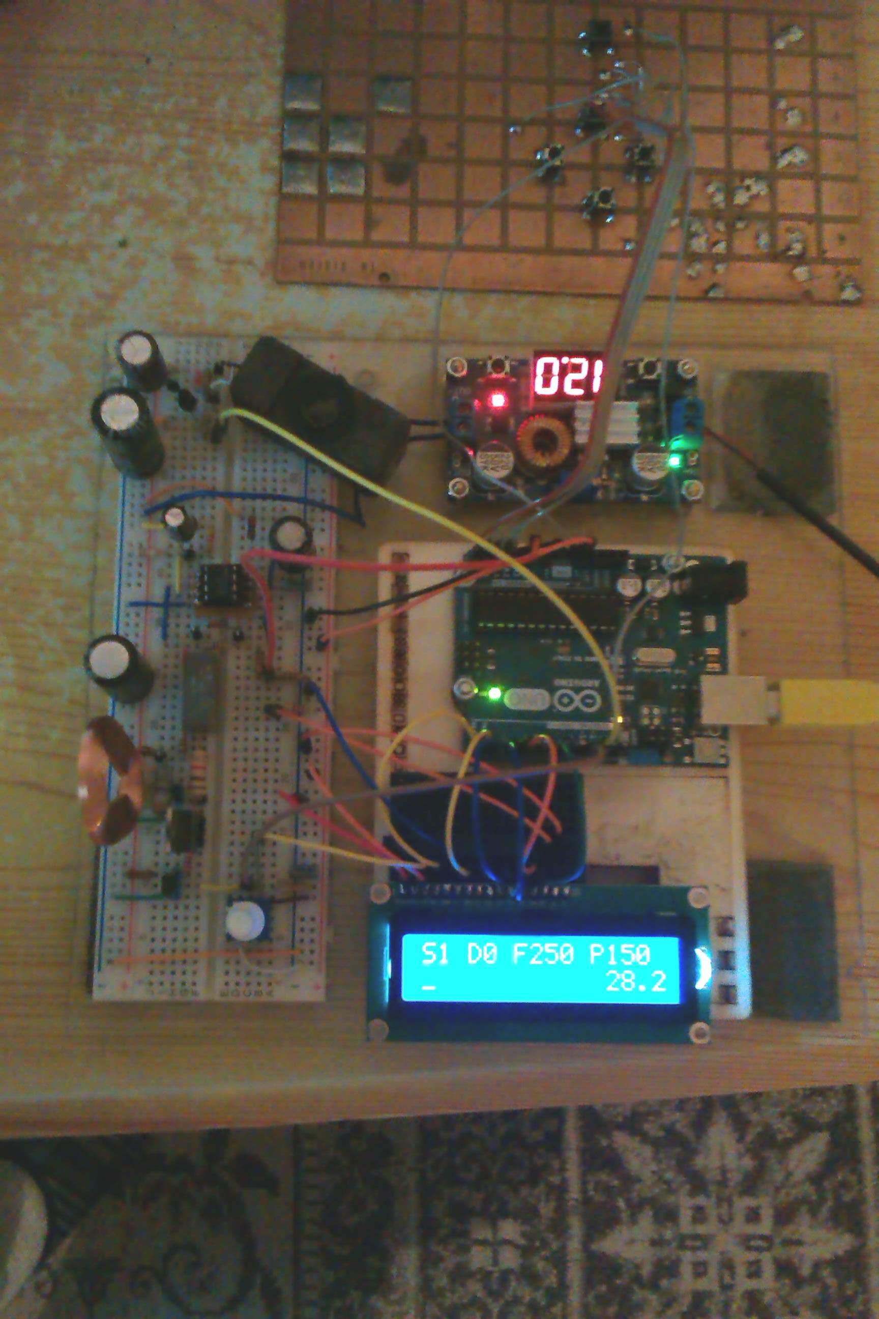

                  • Playing with Arduino is FUN!
                    I got time today to put all the things together and test this for the first time.
                    Wanted to keep things simpler as possible, used tiny bench power supply 12v and "ultra large heavy duty" coil... obtained from old 5.25" floppy!!!
                    Ok, this thing is working. Having indeed very interesting behavior. Worth to be made on regular pcb with Nano or Mini Pro... or bare Atmega328P.
                    Everything works just nice on the bench.
                    I picked up one of several tones available. Each one of those is acting different and interesting.
                    All other adjustments are working too, making differences in behavior.
                    So, this is checked. What's next? Making it on regular pcb and making real coil for it.
