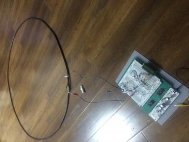

                      • Who is using cable coil with this PI and successful ?
                        I failed, Screen Tip: "Coil Error" . The cable coil, (Diameater of coil: 130 cm) (Tums
                        : 10) (Inductance: 410 uH) (R: 1.3 ohm)

                          • Originally posted by lc516 View Post
                            [ATTACH]34618[/ATTACH]
                            please help expert analysis solution, very grateful!
                            I've been tried making simple mono coil for this machine but seems this machine is choosy about coil..i suggest you to used stranded wire..my experience with simple mono coil are: coil error will appear suddenly, cannot properly descriminate, poor detection deep and noisy in real field.
