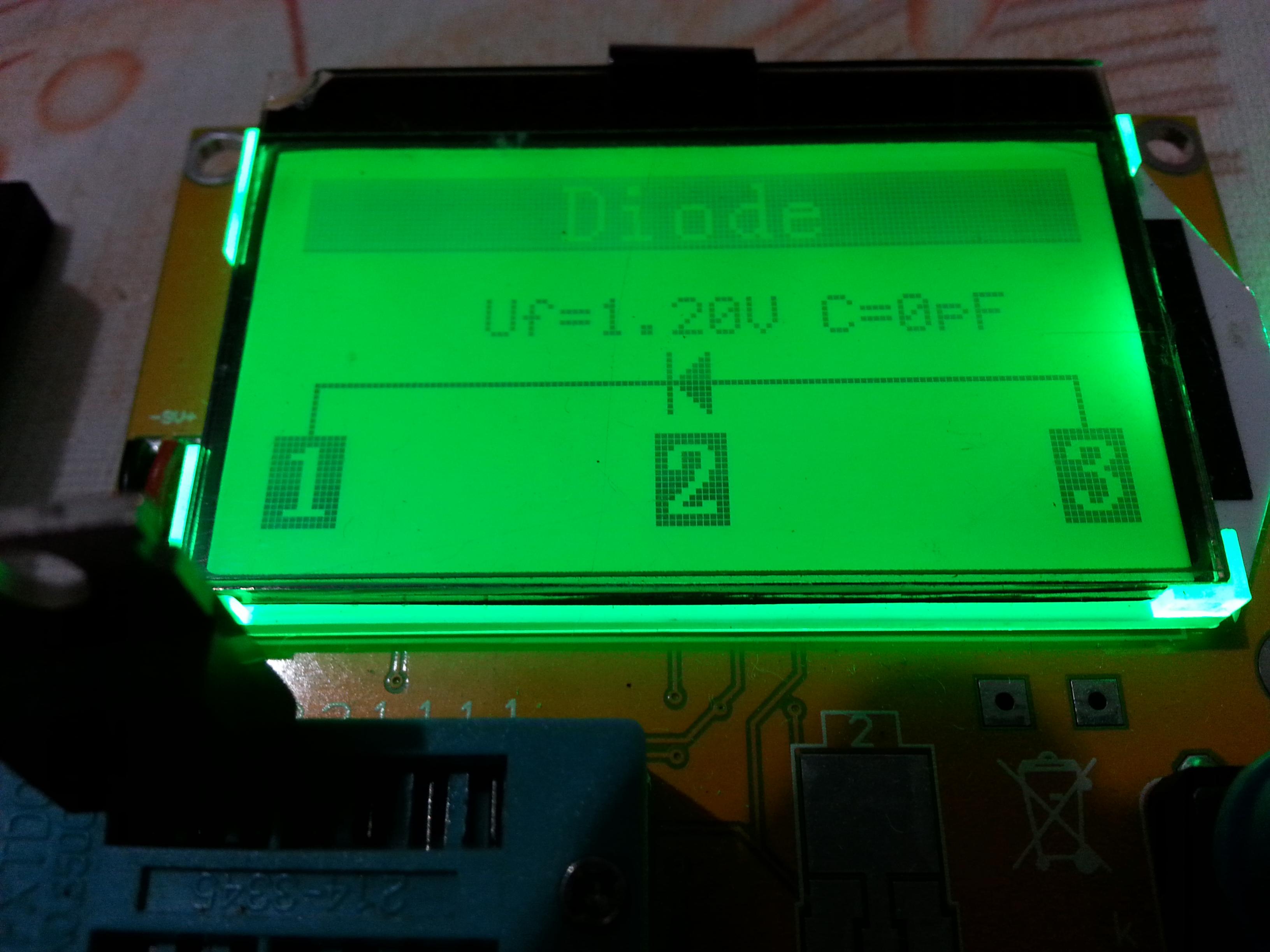

                    • what burn again
                      work good for some time and then start coil error change lf357n the same error what burn this time.
                      • change 840and bs 170
                        • Thanks I will buy newClick image for larger version
ID:	352391 what you thing 840 is burned?
                          • meybe its a weak from short secret and burned with a high pulse more than 200 or meybe bad connection coil cable and suddenly dissconnected or from touch hand many thing
