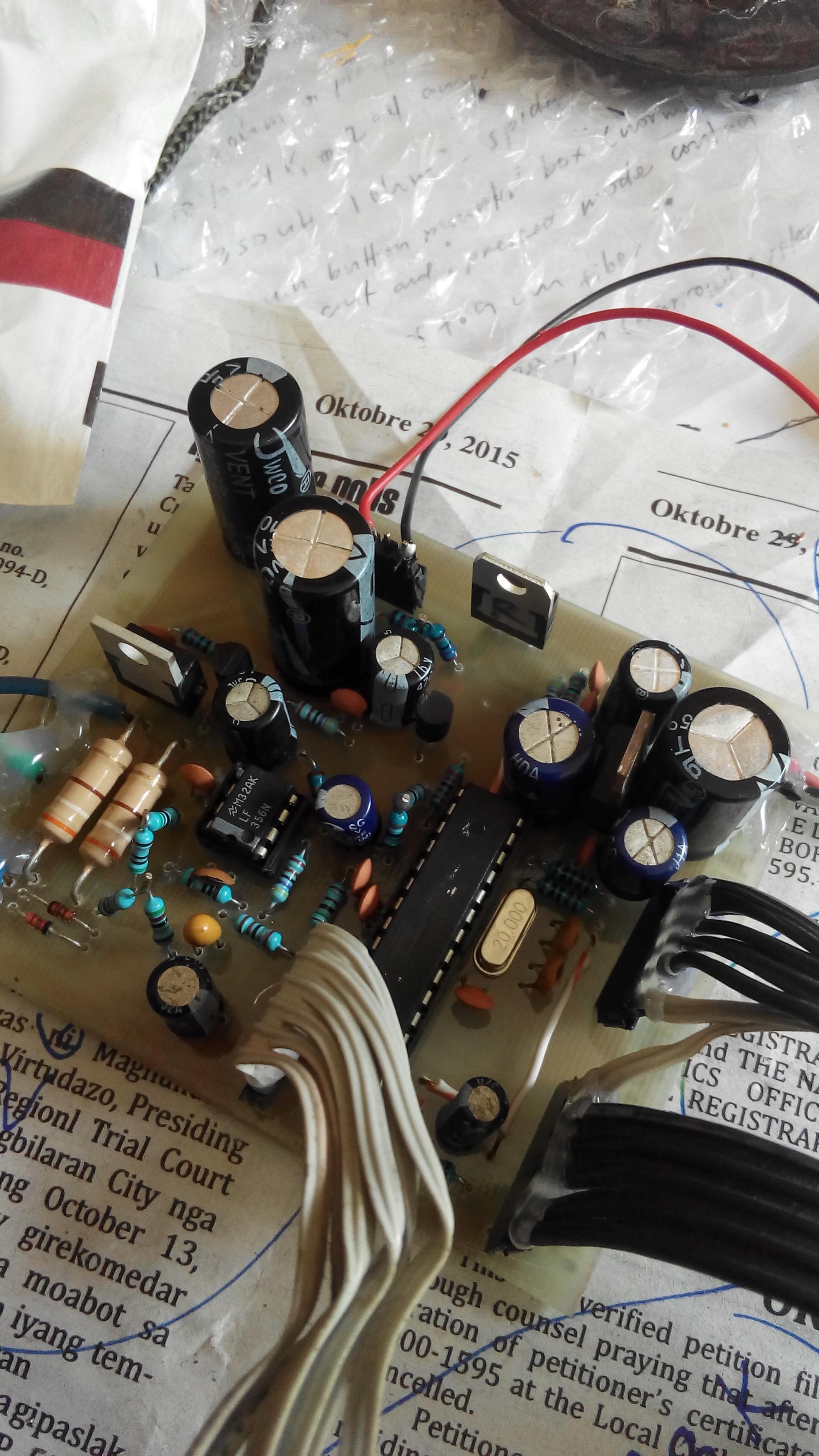

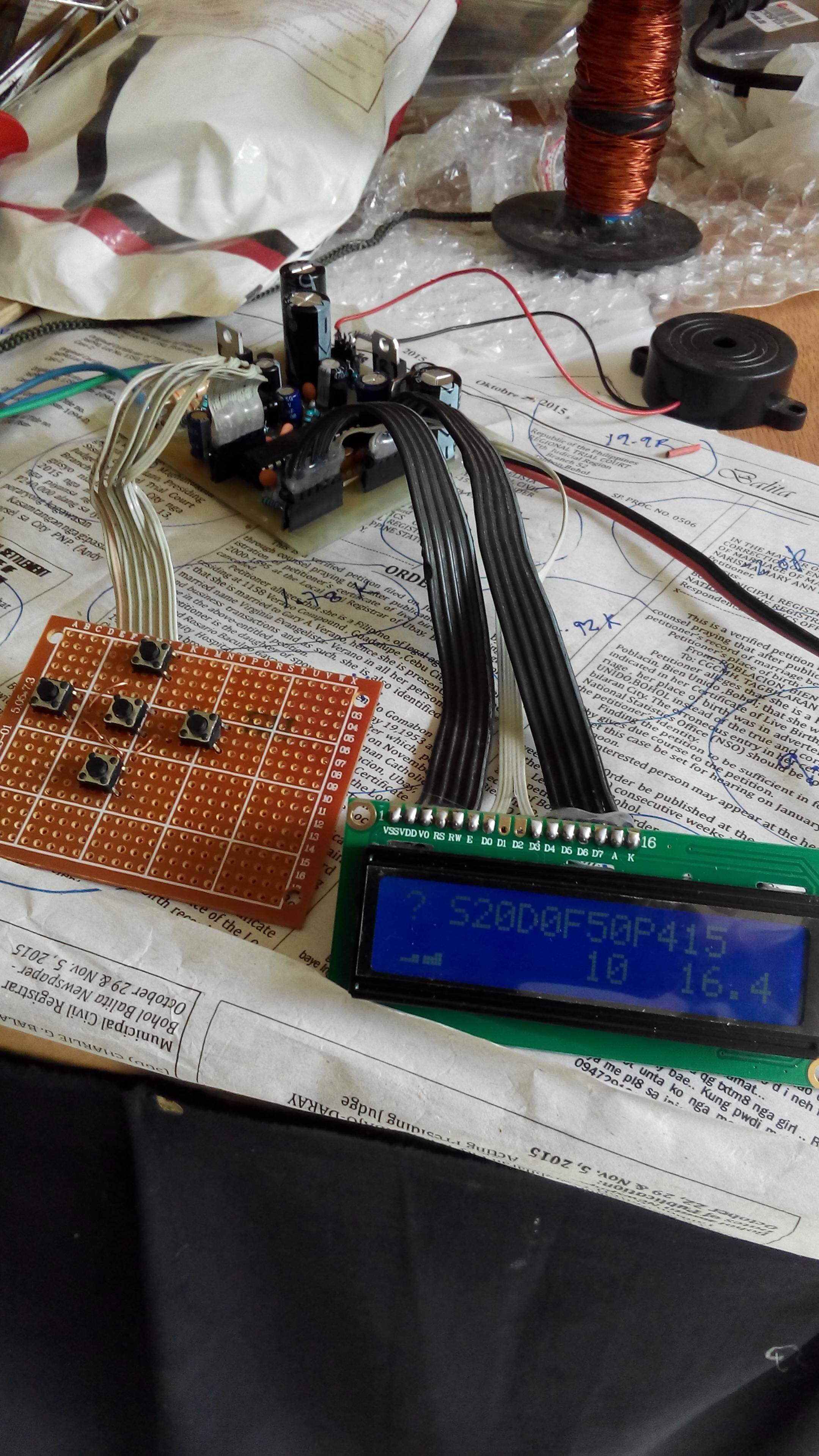

I have exactly the same problem, only the coil is 52cmOriginally posted by jladre View PostTest stage..not what i expected. Maybe coil is the problem..using my delta pulse coil with 56cm diameter and 400uH inductance..i can only detect 24cm plate at 110cm distance..too far as what this pi promise..maybe my coil not good..[ATTACH]34196[/ATTACH]
Parameters are 230mhz impuls 130 .....
I think that will be more powerful ...
you were right, the problem was reversed lf357 poor creature to another and instantly changedOriginally posted by jladre View PostI made spider wound coil 28x60cm, 350uH, 1.5 ohm and a round coil 60cm diameter.. Same result no progress... Detect 1euro at 40cm and 110cm for a 20x20cm metal plate..
It shows great depth of 1 EUR coin sees 50cm only now is a problem with the earth resistance is constantly changing
I have not yet tester to measure the inductance , but maybe a bad coil....
I lets make a 1mx1m reel and I'll see what the results will be
